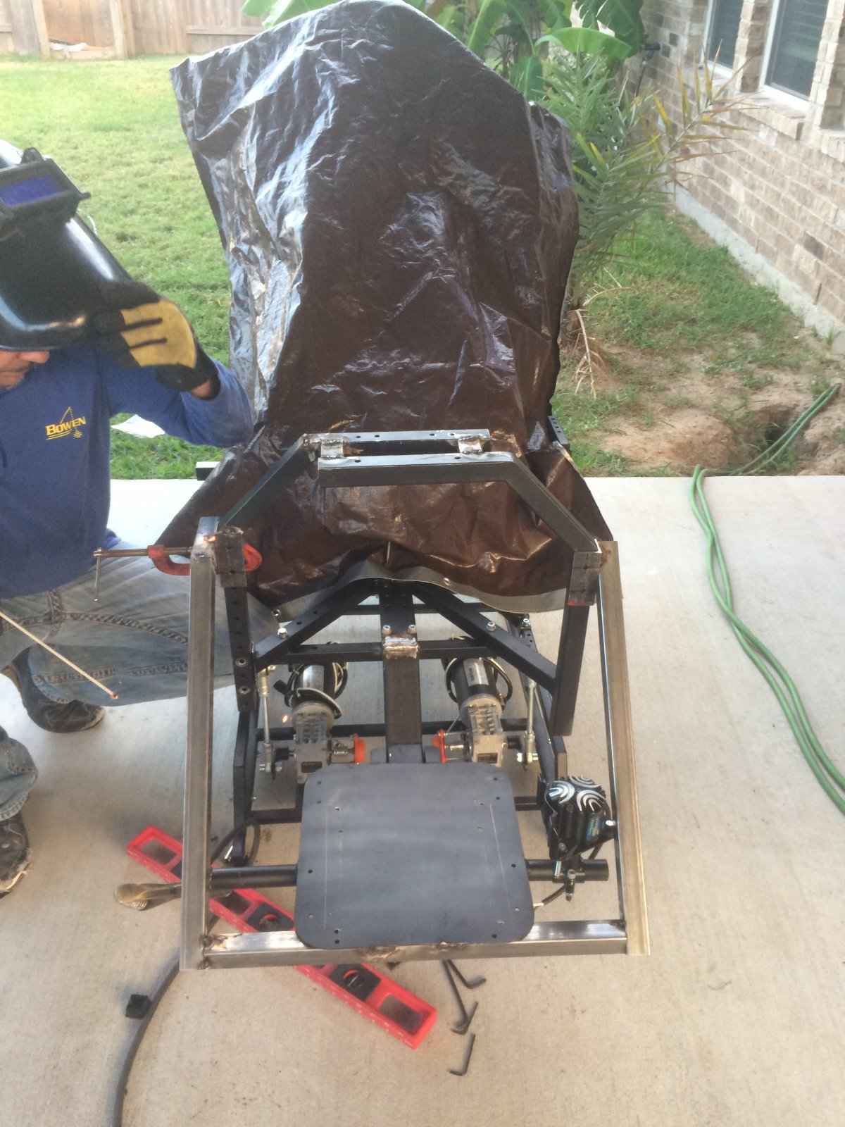

    That extra support material may mean that you need to double check the balance of the rig @aceinthesky, as it may be affected.

    I put all my gear on there and the balance is pretty good, so I'm stoked.

    4 for the chassis mode, 1 for wheel, 1 for seat, 1 for shifter, I for brake. It's an amazing software and all the transducers have different effects. I can't wait to get it all working together with motion and wind, from sim tools. Just have a have to my welder make a mount in back of rig to add some weights to change cog if anyone with shorter legs rides in the rig and move seat forward. Then I need to disassemble once again and paint.

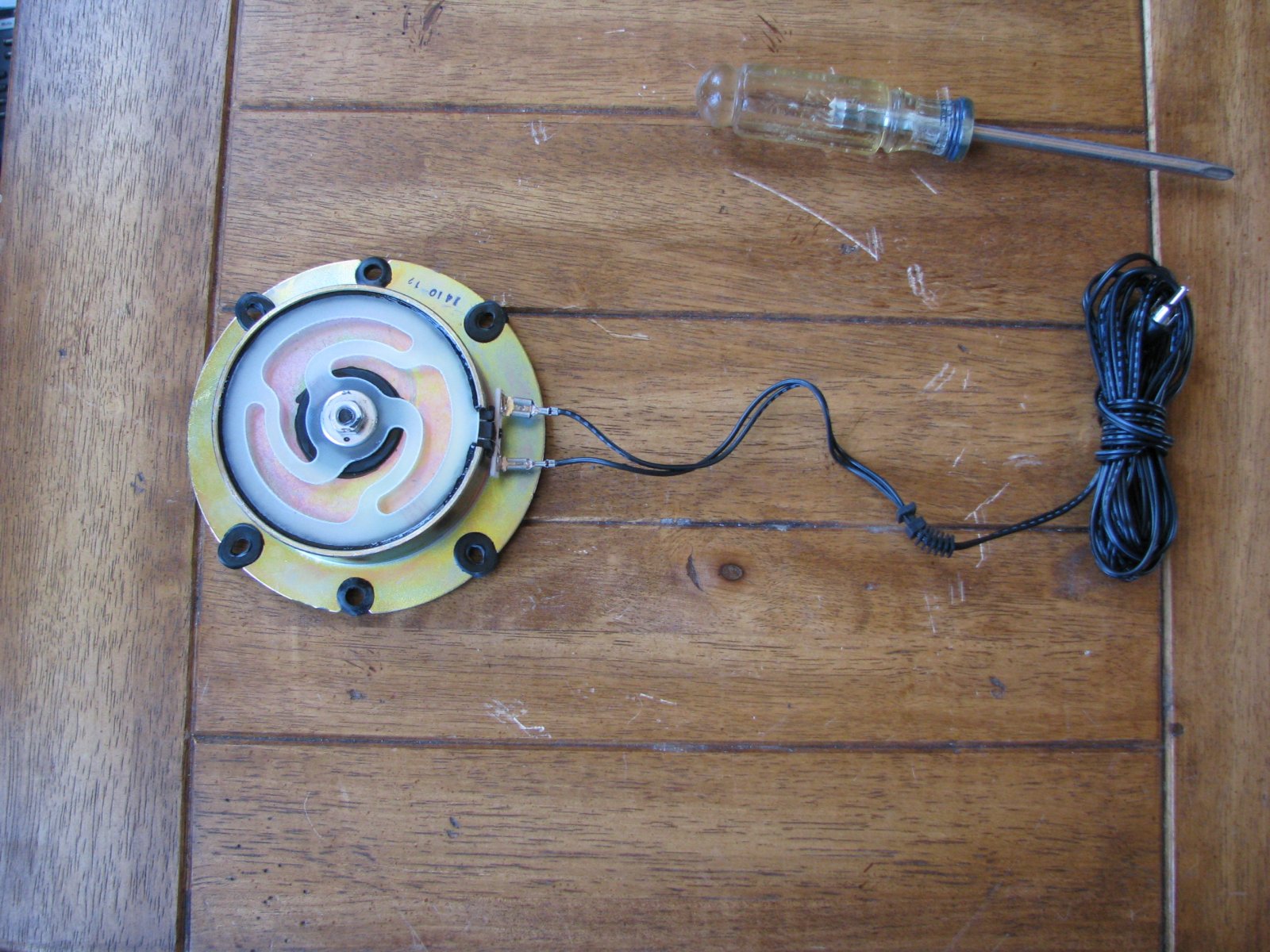

    When you gut them for their amp and transducer for our use, they look like this ....

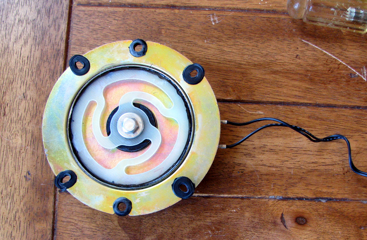

    The transducer itself, it's 4 ohm ... in case you prefer to use your own amp.
    They are ~4 3/4" dia. with the mounting flange, about 1" overall in thickness, and have a ~3 1/4" X 3/4" moving piston.
    Overall weight is ~2lbs.
    Top view ...
    Bottom view ...

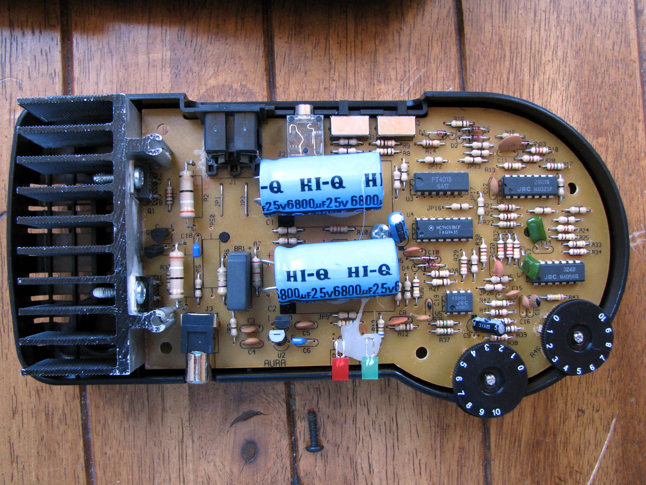

    This is the Aura amp with it's cover off.
    The rotational controls set the intensity and the frequency bandwidth, with sliding switches for music or game, and normal or A/B operation (for two users).
    But SimVibe does that too (and much better) so I set them for full power full bandwidth, game, and normal.
    But I suppose if you didn't want to add additional sound cards to your PC, and didn't want to use SimVibe, than you could just use the Aura amp controls off a single card by using the proper number of RCA 'Y' adapter cables.
    The Aura amp uses a TIP41B NPN, and a TIP42B PNP for amplification (spec sheet shows both are rated at 65 watts each).
    So the amp operates push pull, and that provides enough punch to the transducer.
    They can be seen mounted against the substantial heat sink at the left of the photo below.
