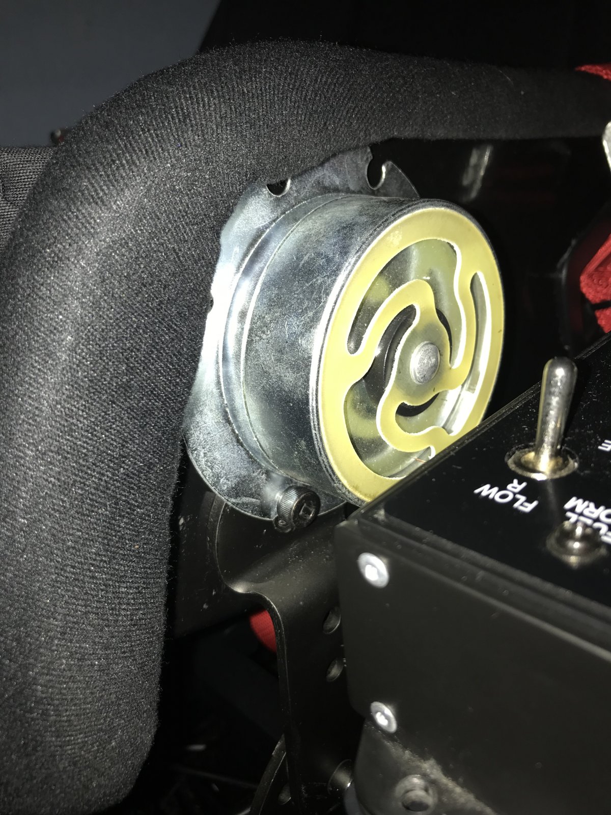

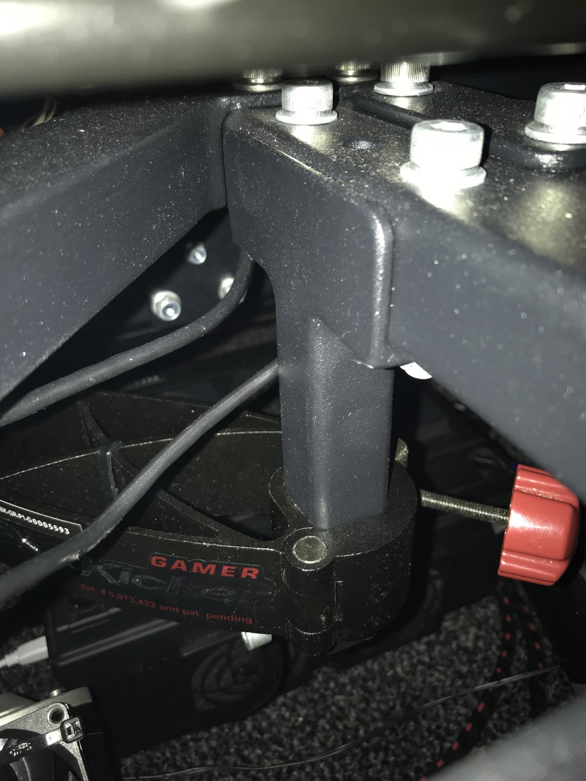

    Where would you mount the 4 transducers on a DOFReality P3?
    Would the 4 transducers give more localized vibrations to different parts of the rig compared to the butt-kicker?
    I am trying to figure out if I should go for butt-kickers or for transducers
  20. xxpelle
    xxpelle Discord "TPMax#9574" Gold Contributor
    Dec 24, 2017
    120
    619Coins
    +150 / 0 / -0
    I would try to mount the transducers directly on the seat.
    I could imagine a plate under the seat, where you fix the converters.
    my butt kicker I mounted with the bracket for a joystick, "super easy"
