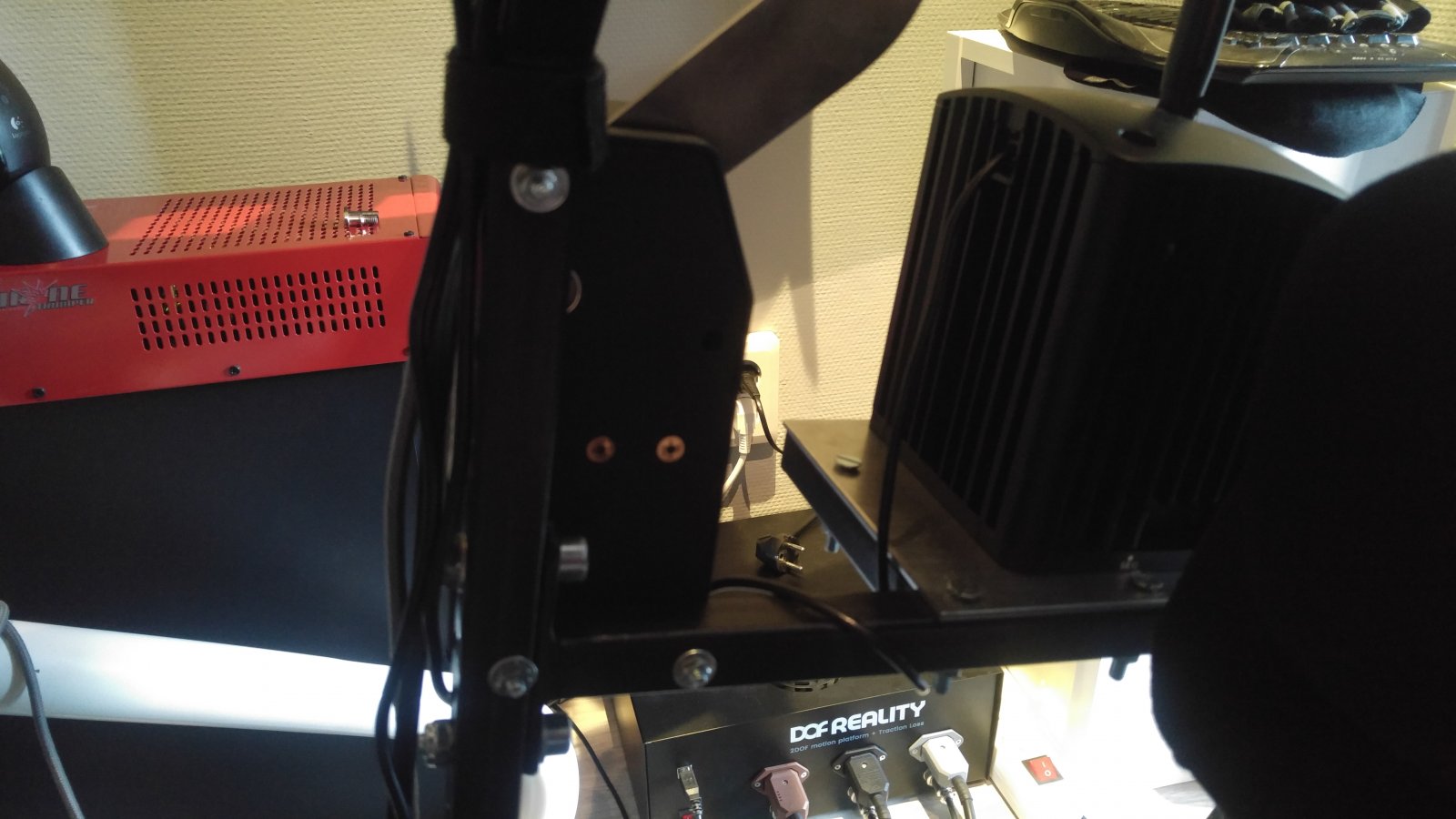

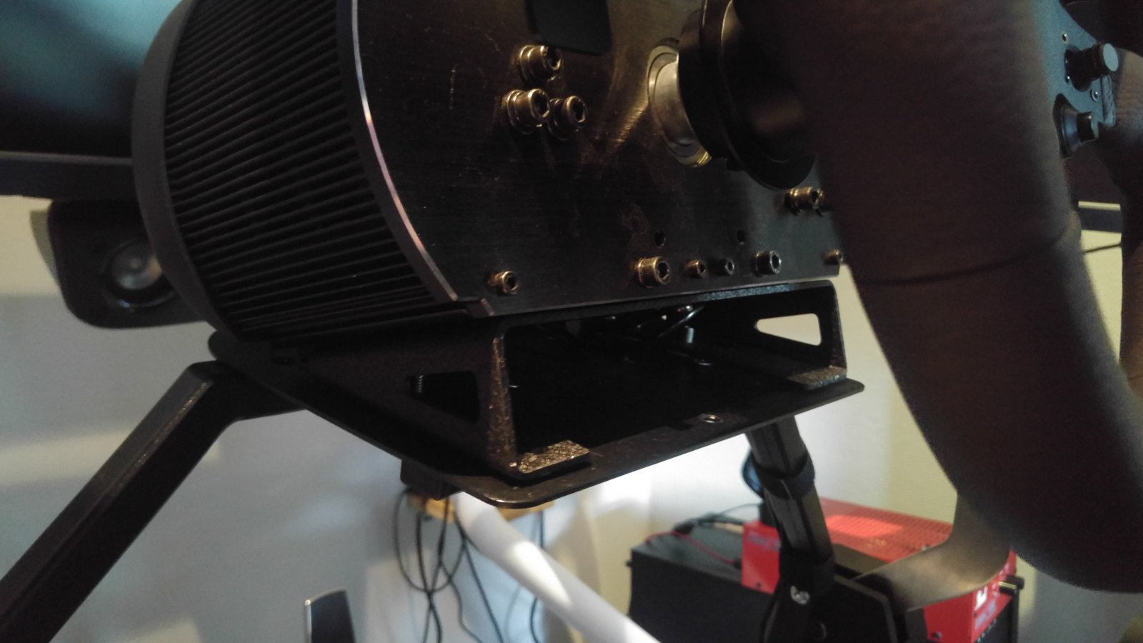

    But after completing the rig a couple of issues with mounting my gear came to light:
    1. The plate for the wheelbase wasn't leveled; it slightly bends forward. 20180719_203955.jpg
    Therefore the wheel wasn't straight when connected. The lower part of the wheel was further away than the top; impossible to drive.
    I had to use the Fanatec adapter 20180802_204111.jpg for the wheelbase to fix this issue; tilts the wheel backwards (also used this adapter on my Rseat RS1).

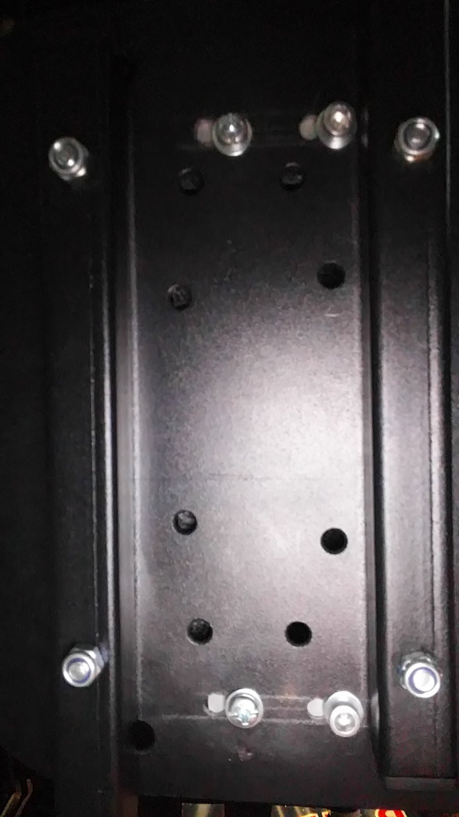

    But of course the holes for the adapter weren't pre drilled; I didn't ask them to... I drilled the holes myself.
    The challenge was to drill the holes between the arms that holds the plate. 20180802_204050.jpg
    This had the disadvantage that there is just one option to connect the flat arms of the rig (underneath the seat, which determines the distance of the wheelbase to the chair).
    Luckily this is the perfect option, so in the end no issue here. It just took me a while to figure it out.​

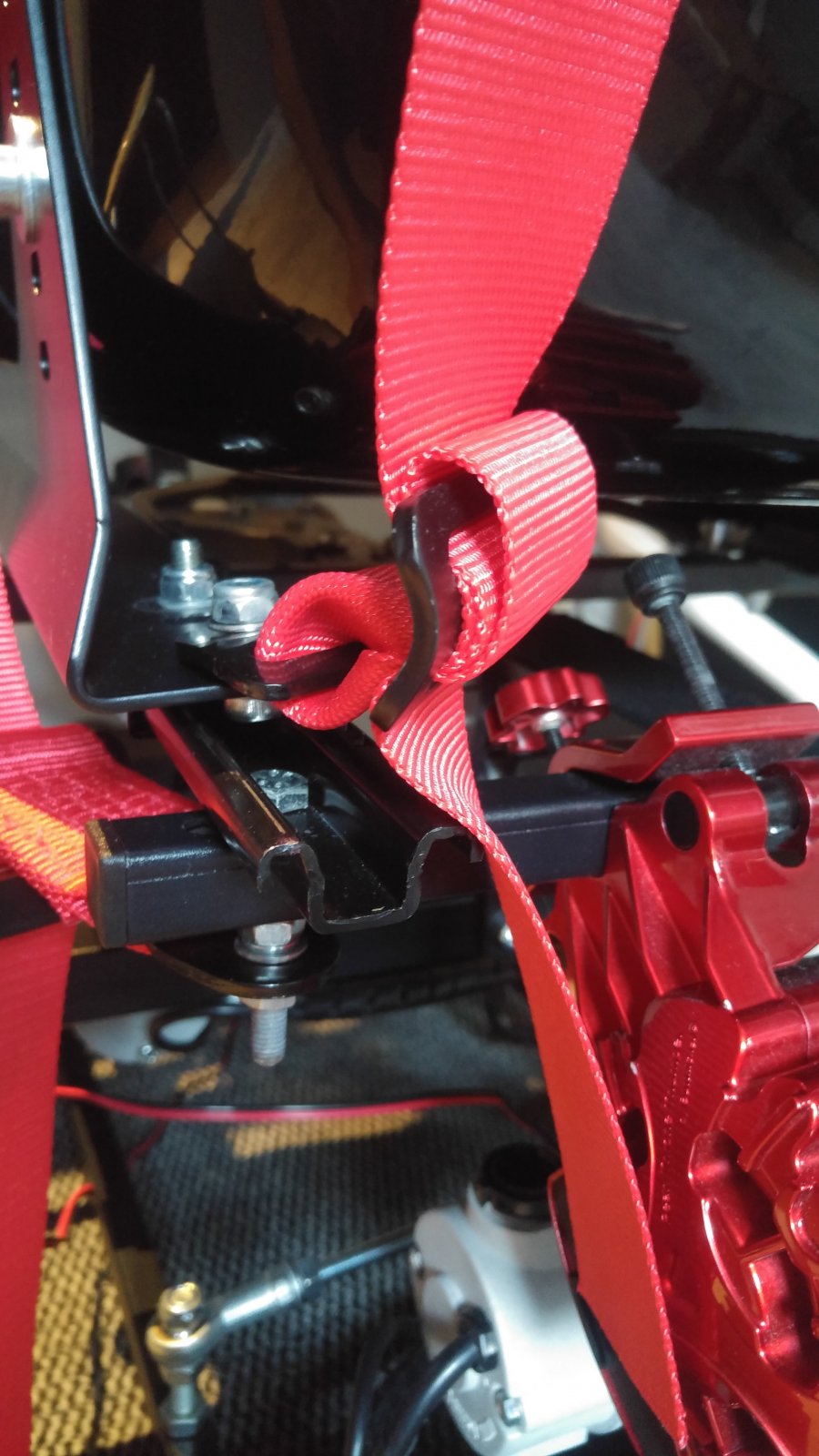

    2. The holes of the seat slider didn't fit to the rig.
    But the holes of the seat slider didn't fit to the seat either. Therefore I contacted the supplier of the seat slider.
    He told me that with a bucket seat it's not usual to use a seat slider (because of safety; if you crash the sliders aren't save enough for FIA-standards) Luckily the crash is only virtual :p
    So I had to drill the lower part of the slider to the rig and the upper part of the rig to the seat.​

    Seat with slider at the right distance to the wheel (with 4-points safety belt 20180802_204014.jpg ), wheelbase at the right height, plate for pedals is adjustable, shifter, handbrake and the butt kicker THMP-1 (which fits perfectly beneath the seat; see previous photo).

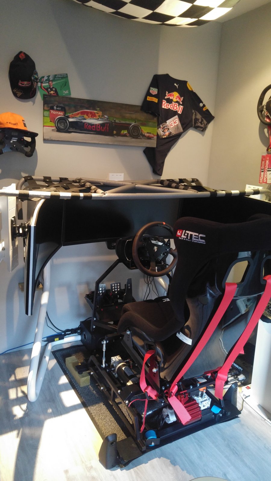

    Finally I could start the game Dirt Rally and the fun began. The feeling is amazing! The motors are very silent, responses smoothly and reacts fast. The rig is very, very sturdy.
    There is no way to fully describe how this feels; it is truly awesome! I get a smile all over my face every time I play. No regrets to my decision for the P3! 20180802_203834.jpg
    note: the wooden blocks underneath the rig (front) is temporary because I need to place another bolt that connects the upper and lower rig.
