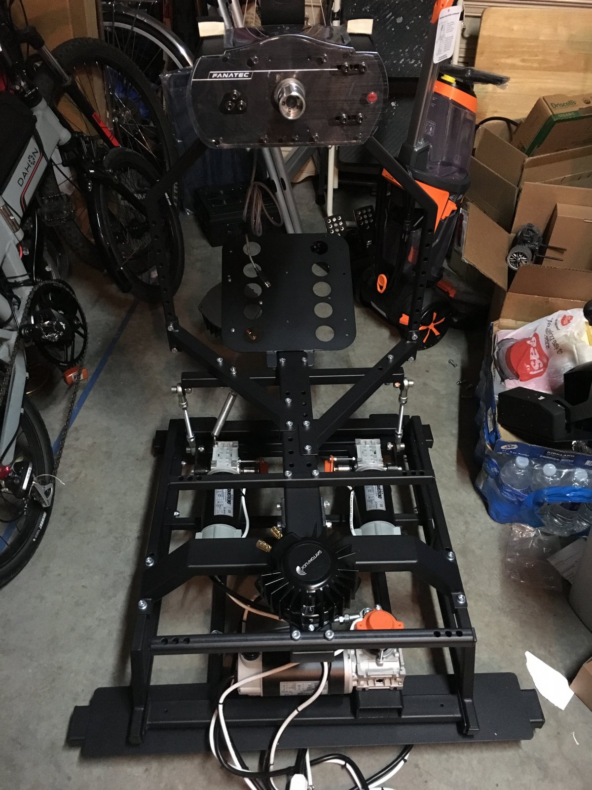

    See how in this video, the guy attached a monitor behind the wheel! I want to check w/ and see if this is even possible with a light weight LCD and a counter balance behind/below the seat.
    P.S. in case if the video can't show, search "Тест-Драйв 2dof - монитор" in youtube

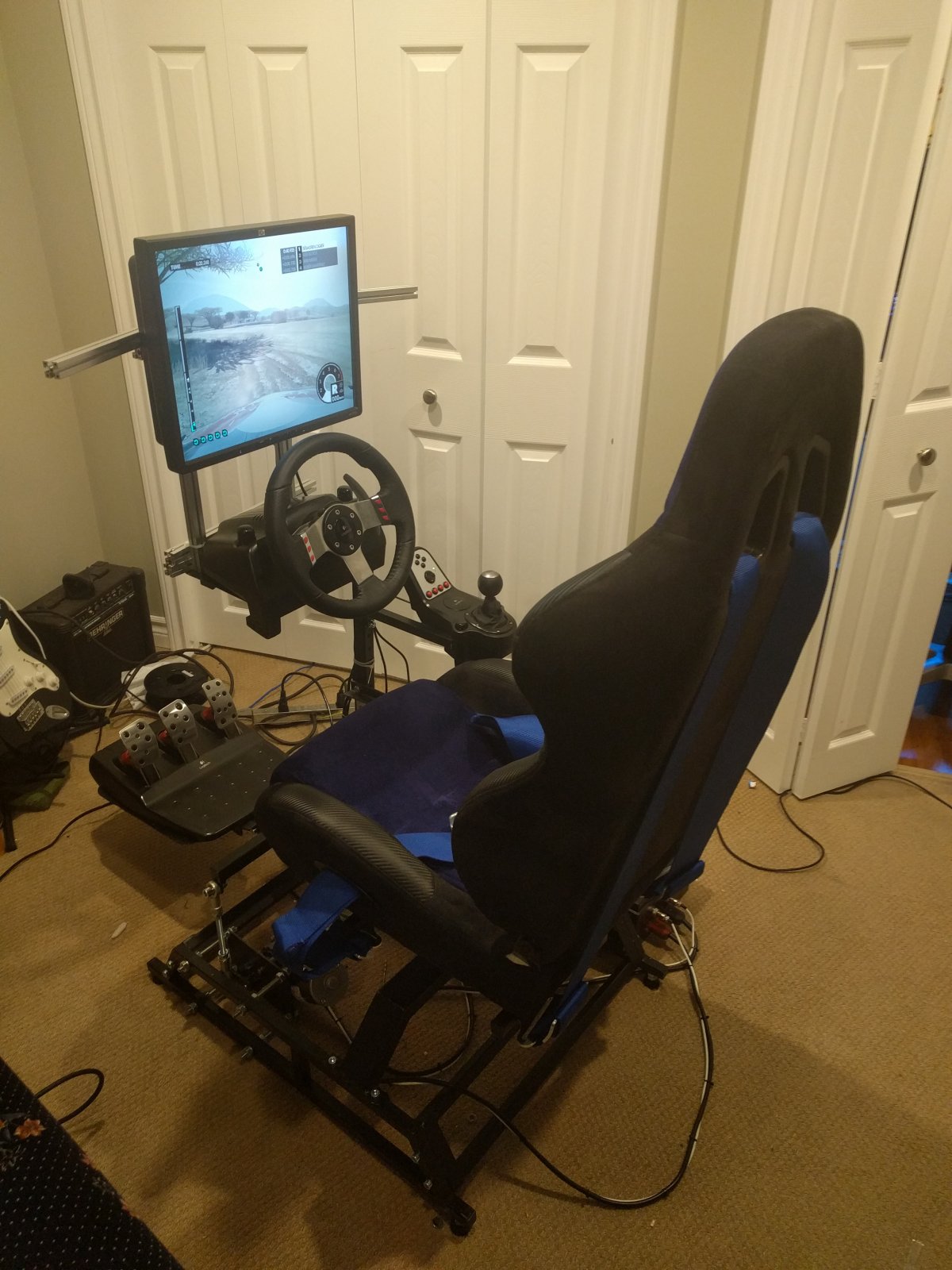

    I was able to mount a heavy LCD screen to my sim without the need for a counter weight, and so far it has stayed fairly secure to the sim. IMG_20170310_221710.jpg

    Can you take some pic on your monitor mount and show me how you secure on the plate?
    How do you like it comparing to a status mounted monitor?
  7. madpcsupreme
    madpcsupreme New Member
    May 17, 2009
    9
    25Coins
    when my kit arrive, I will try to use spring to counter balance it instead of adding actual weight.
    Since this dynkit has most of the component on top, once it starts to drop(forward or backward), the weight on that side increase a great deal... just like standng a motorcycle straight is ok, but it gets heavier and heavier if it's tilted to one side

    I am finally done with the rig and the balancing work!!! I am going to hook my wires up and start testing tomorrow!
