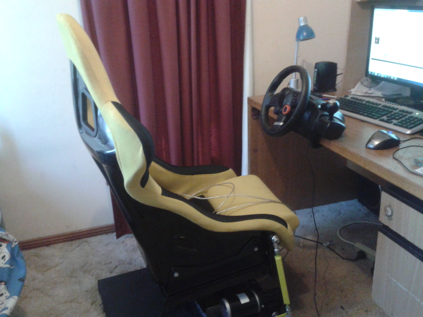

    The desk racer (yellow sim) is not really suitable for someone of your weight. Even with 60:1 boxes it may struggle.
    Id rate that to maybe 125kg max . You will need to look at shoulder mount at rear motors for best performance.

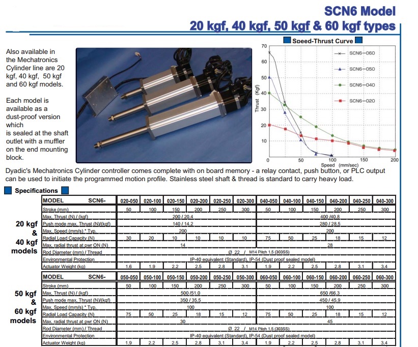

    For Info here are the specs for the SCN-6 - Note that the 50/60Kg model is a bit slow for a car sim and the Graph is not for a vertical lift.

    Agree with bsft, for someone of your weight the advantages of leverage cannot be discounted. From the photos it seems your sim already extends out the back and the two SCN-6s would look as good as SCN-5s. FI most motion sims have adjustable steering and pedals for different sized users.

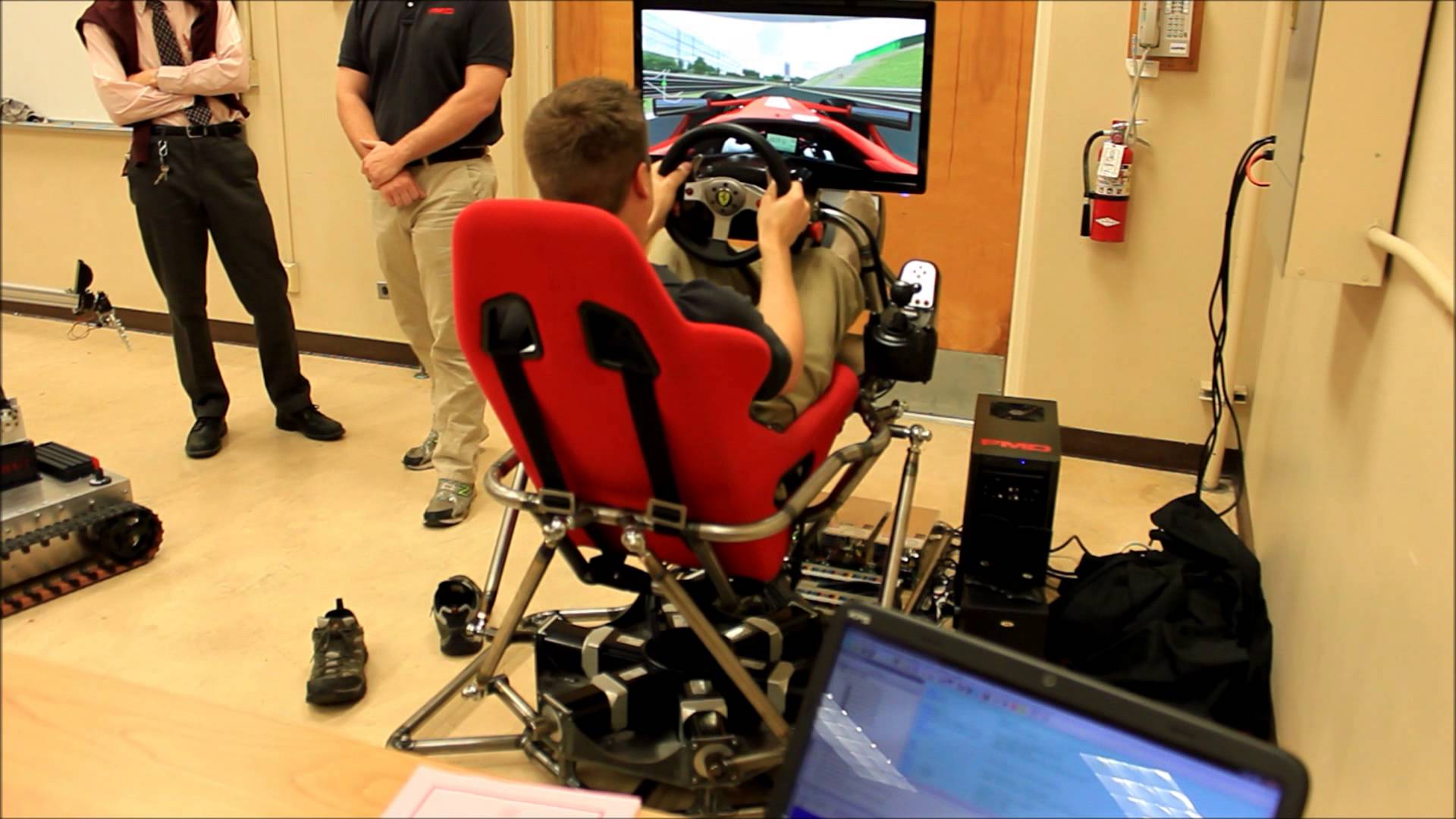

    How about two of these motors that they are using in this 6dof platform. I've always loved the solution for having a shot arm connected to a longer one.
  14. bsft
    they are 240v motors and its just a lever on them, like any other motor.

    Yeah, two SCN6 (the 40kg force model) can easily move a 138 kg driver, just keep the seat on balance putting the joint in the right spot underneath the seat, and keep the actuator attachment high up, at the shoulders level. We are talking about a seat mover right?
