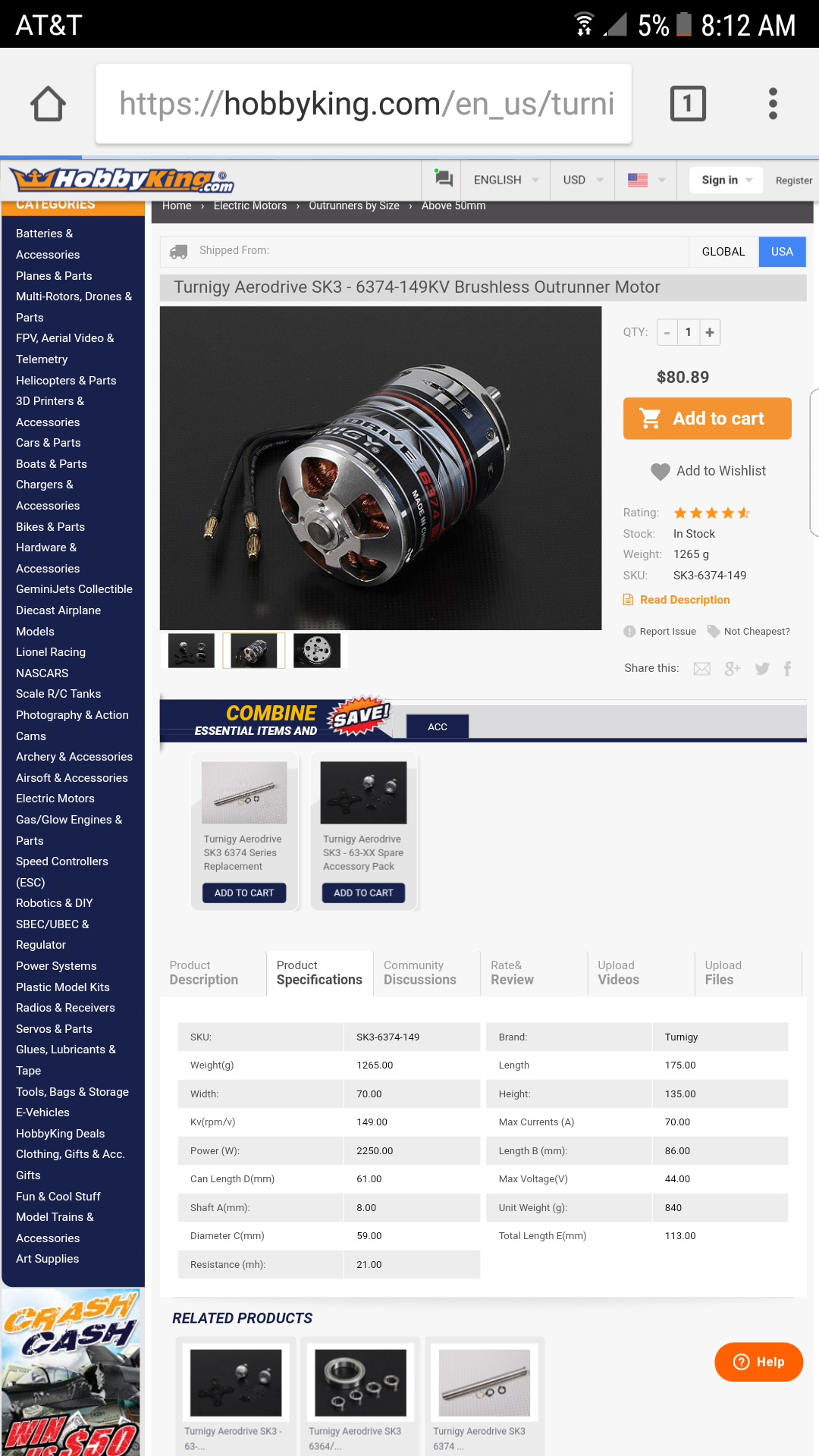

    Looking into motors and such started thinking about brushless. Have some experience from my rc hobby. Brushless has been a revolution everywhere else so I looked at this
    And maybe control with this or similar
    Any reason this would be extra hard?

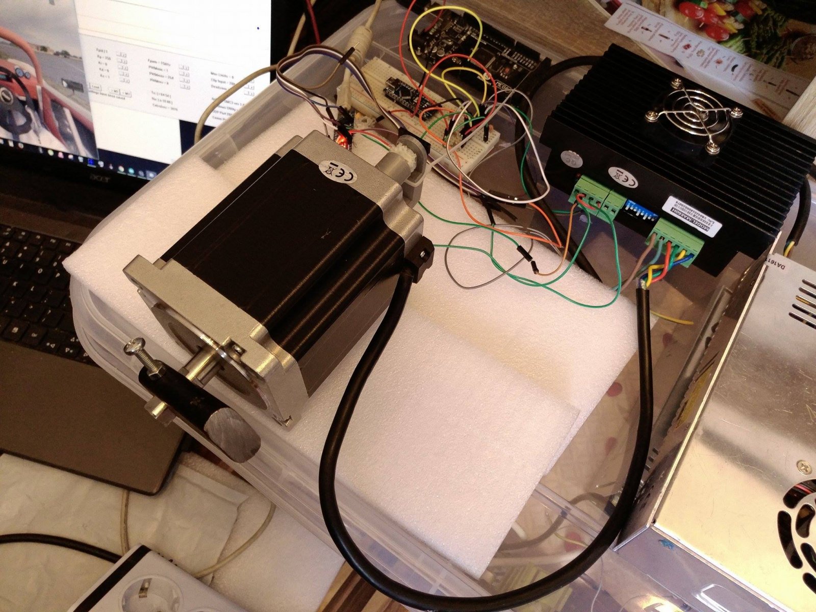

    2DOF, 3DOF, Arduino
    Hello ,
    I'm working on stepper motion control, things looks promising . ;)
    With this small 8Nm motor, and what you see in picture i can lift around 20 kg.
    And some video:

    I've been looking at hobby stuff. These motors output over 3nm for under $100

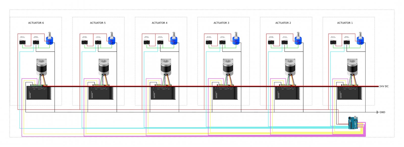

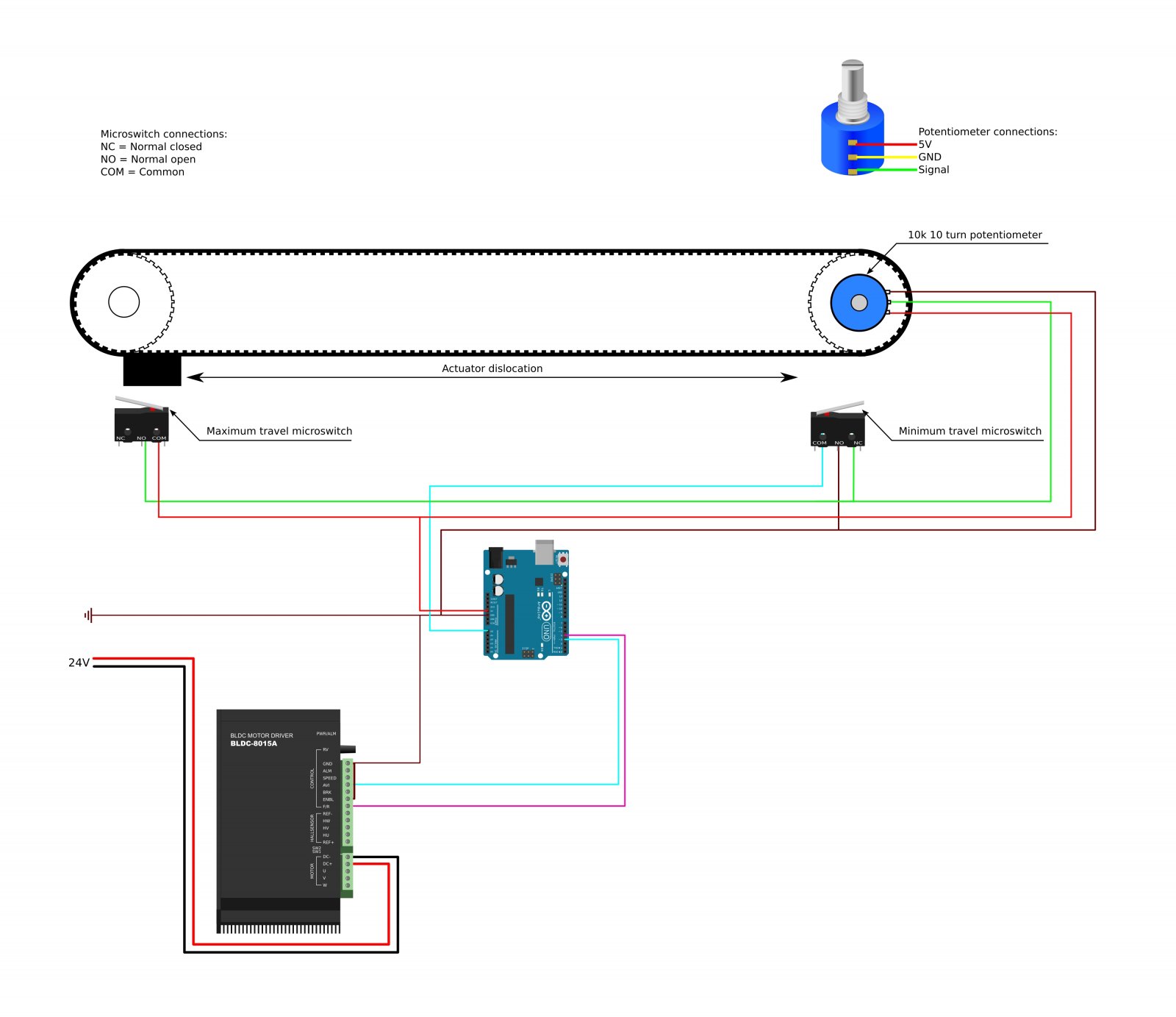

    I made a topic about my 6DOF build with brushless motors.
    I can share what I'm using:
    Motor:
    Nanotec DB59C024035-A (brushless).
    Bought at Farnell (http://pt.farnell.com/nanotec/db59c024035-a/bldc-motor-24vdc-4500rpm/dp/2507576
    Specs: http://en.nanotec.com/fileadmin/files/Datenblaetter/BLDC/DB59/DB59C024035-A.pdf
    Right now they are around 99€ each one.
    They are rated 3500rpm and 0,6Nm (4500 rpm 1,8Nm peak)
    For a SFU1605 (ball screw), thats 16mm diameter with 5mm travel on each turn we can have for rated values:
    3500rpm => 290mm/s of travel
    0,6Nm => 372N = 38Kg of lift
    Motor drivers (one for each motor):
    ACT Motor BLDC-8015A
    Bought on ebay (http://www.ebay.co.uk/itm/EU-UK-Brushless-DC-Motor-Driver-BLDC-8015A-18-80V-Nema17-to-Nema23-Wantai-/282017543495?hash=item41a98e3547:g:56oAAOSwubRXHvie).
    Specs: http://www.wantmotor.com/product/8015a.html
    They cost around 40€ each.
    This with an Arduino, works really well and we can go up to 6 motors with one Arduino.
    My schematic:

    Missed one image (can't edit the above post, gives error)
