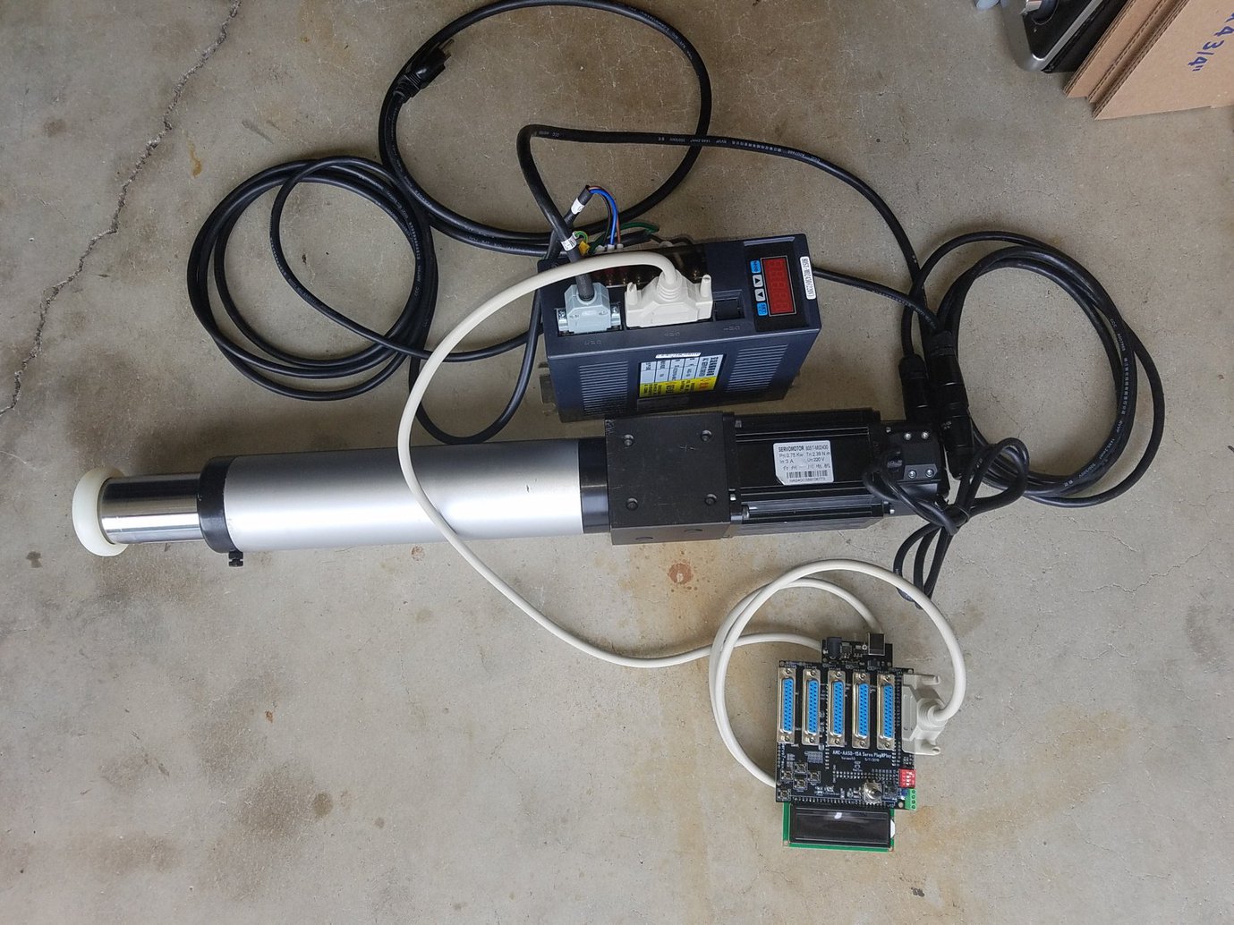

    Correct. For the DC motors you will need to also buy drivers (Sabetooth or MM) and power supplies with balancing batteries for each motor etc...
    The AC servomotors come with matching servo drive, that it just needs to be directly wired to 110v or 220v for power. Simple and neat.
    https://www.aliexpress.com/item/32973113245.html
    See such servomotor attached on a small linear actuator. The servo drive then attaches to one of the db25 ports on my controller via a simple straight DB25 cable, no need to custom wire anything!

    Using 2.4Nm servomotor and 50:1 gearbox, according to my calculations you should be able to handle about 70kg on 150mm long arm (which the rods of your 6dof attach on).
    That is 70kg per motor, total 420kg if all actuators work synchronized to lift the load...
