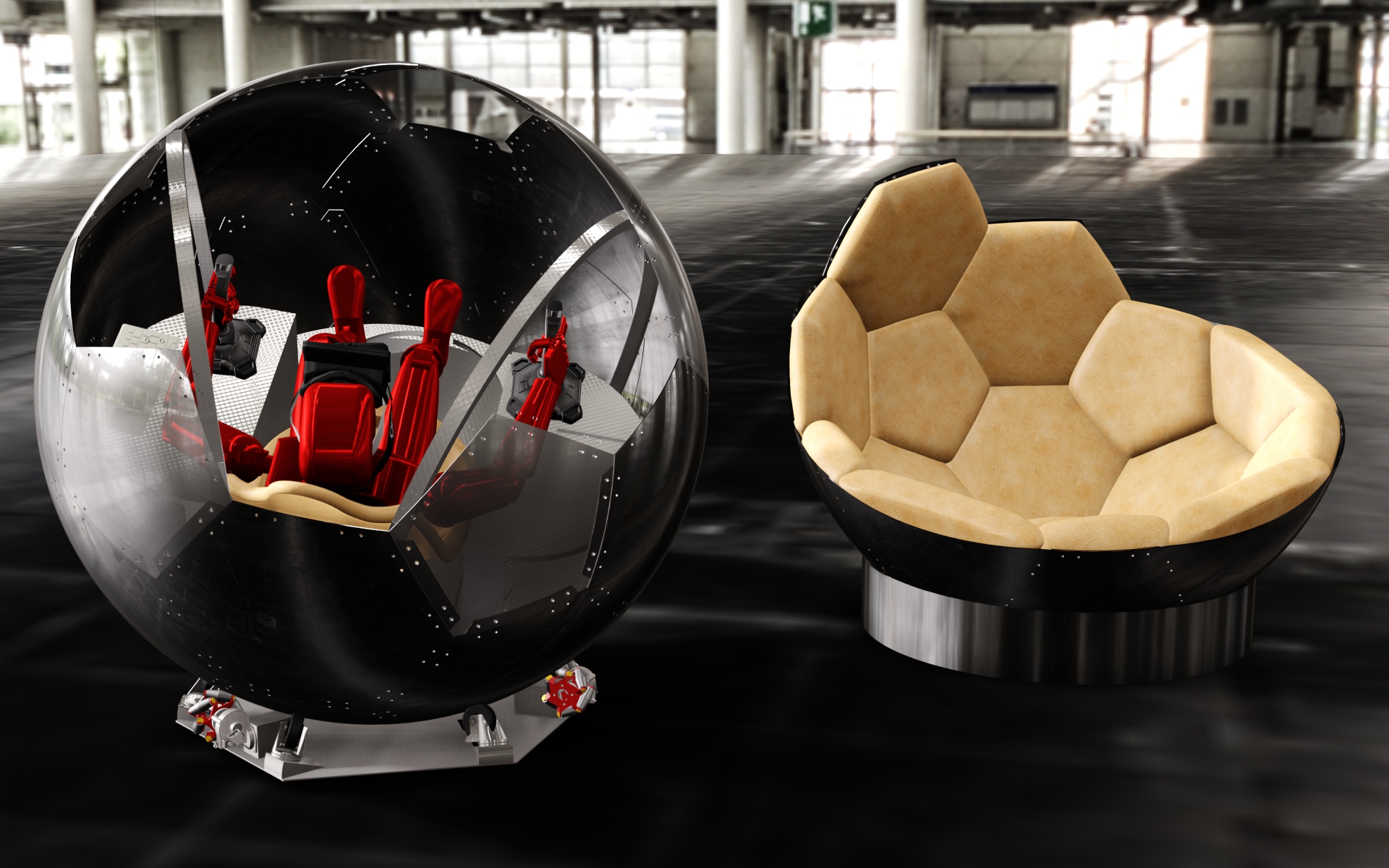

    Since my project is so unusual I'm not sure if you guys can help.
    I either need 2 large motors to rotate my platform via belts or (preferably) many small motors turning high traction mecanum wheels.
    With a 150mm wheel on each I figure 140rpm (without load) will give me 90 degrees rotation per second, so about 200rpm is close enough.
    Something like these : http://www.ebay.co.uk/itm/DC-24V-0-...al_Components_Supplies_ET&hash=item43cc1e98ce
    Does anyone know of an online calculator that can work out the torque need to rotate a certain mass? All that stuff is in Autodesk Inventor but I would like my doubters to be able to put in their own figures too (and check my own work)...

    I'm not sure how, it says line speed is "5.5Ft/min without Load" which is 1.67m a minute... this wraps around a 30mm drum, so I only calculate less than 9rpm...
    I don't need *that* much torque, this could pull about 5 spheres with people in them.... I need to rotate them quite quickly.

    Indeed! We've never seen such a motion platform here before! (quite)
    As you wrote, it can be calculated in detail with Inventor.
    Do the cross check manually on a piece of paper. When you can convince your doubters with that piece of paper, you've done your job right.

    Uh, why has my thread turned into a discussion of slow winch motors?
    "a large chain drive on the end would increase speed and reduce torque"
    I need 140-200 rpm motors, these winches only give 9... they're wrong for my project by a factor of 15.... for them to work I would need a TWO meter wheel driving my sphere... correction, I would need at least three 2 Meter mecanum wheels.
    if I'm missing something let me know....

    $388 per servo isn't cheap, 730 rpm is far too fast for my application too and x-sim doesn't work with servos, which I would really like to use...
    This might be an option for a belt drive, but it's still far too expensive.
    My best option so far remains the ebay motors I outlined, I can buy 25 of those for the same price as one teknic servo and get 21Nm versus the 13Nm...
    More motors will probably be better for my application since I'm unsure how much traction I can get on the sphere per motor...

    A lot of the big worm gear motors may have the torque required as the mass is balanced on a bearing surface as in the cg is always supported and does move far from it centres , so inertia of the mass may not be an issue.
    But until you know the amount of torque that is required for fluid motion and to hold the mass at its extremes points , you can not even consider whether it will be 240v or DC driven.
    Lets get back to the real question.
    So anyone got an idea on how to calculate this ?

    Actually, if the sphere is balanced and the center of gravity in the center of the sphere the holding torque will be neglible, the motors would never lift anything or need to hold it up, just rotate the sphere....
