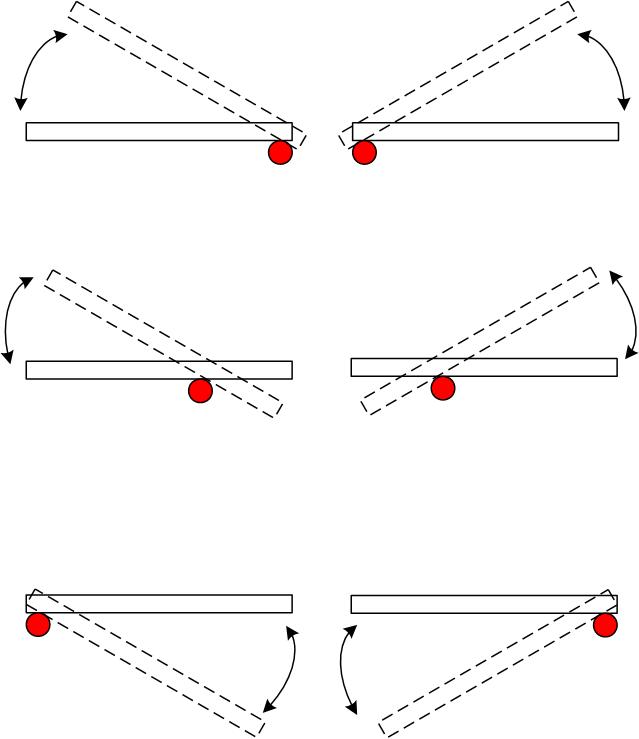

    Dear All,
    I did not know anything about G-Seats before reading @RiftFlyer's thread, and during the past days I have looked around quite a bit and found several amazing projects.
    Since I am now considering to add seat flaps to my (still not existing) 2DOF simulator for adding "heave", I focused on these flaps and found different approaches regarding their pivots.
    The following sketch shows three possible locations for the pivots of the flaps on which you are sitting (not the ones on the back rest).
    Since the pivot location obviously has an essential impact on where the pressure is applied to butt and legs, my question is: Do you have any recommendation where to place the pivot? As I mentioned above, I have seen these variations during my Internet search:
    • inner edge of the flaps
    • about 30% away from the inner edge
    • outer edge
    Thanks a lot and best regards,
    Markus

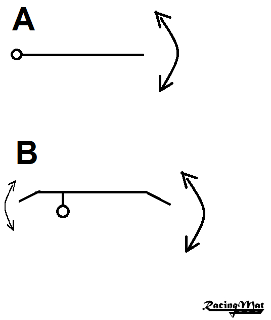

  2. RacingMat
    2,233
    21,066Coins
    +2,092 / 21 / -2
    When I asked myself this very question, I thought case B would give more information: over-pressure and under-pressure
    but still not tested yet...
  3. RiftFlyer
    RiftFlyer Active Member Gold Contributor
    Apr 15, 2014
    198
    1,711Coins
    +121 / 0 / -0
    DC motor
    I've yet to tackle the base of my seat but from research I believe option two is the best (30%).
    The critical thing is where that pivot point is relative to your butt. You want to sink slightly as the flaps are raised. That means the pivot point can't be directly under you but should be towards the outside.
    Option 3 places all of your weight on the flap and will likely see much higher amp draw. For example, I'm not sure how wiper motors would cope with that arrangement.
    Option 1 works well for racers as it provides more lateral force (raising one side and lowering the other). I'm not sure how well it would represent heave though and the effect it provides you will already get from your 2dof setup.
    I hope that's of some use.

    @RacingMat & @RiftFlyer: Thanks a lot for your informative and helpful replies!
    My gut feeling is also that option 2 is the one to start with.
    About "heave": Actually I think that the flaps will add an additional effect to the 2DOF sim, because what I already have is only pitch and roll. My idea is to add the "heave" DOF by moving the seat flaps synchronously, and ideally with only one motor. (I have rather strong ones.) I am already thinking of the mechanics.
