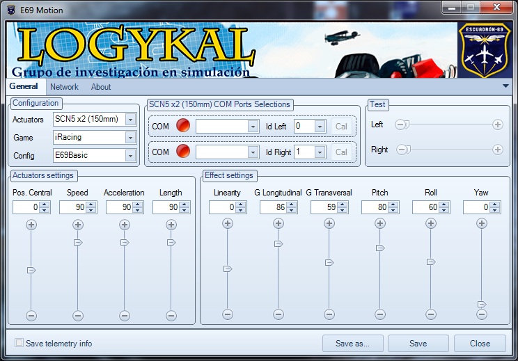

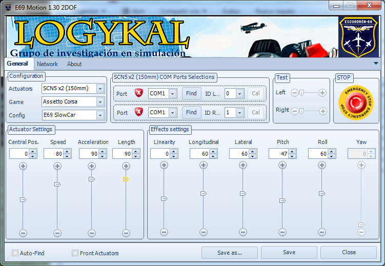

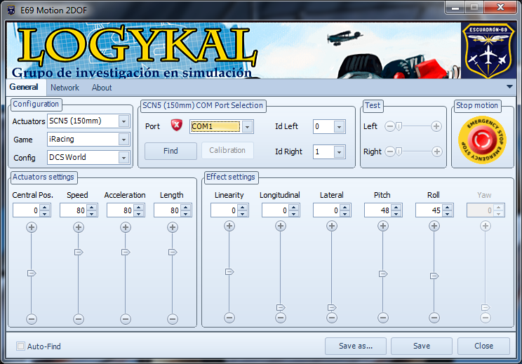

    E69 Motion 2DOF is a free software program that provides a user-friendly and intuitive tool, for the operation of motion chassis. It can be used to build a low-cost yet high-quality chassis for flight and racing simulators. It consists of a GUI in charge of the configuration, calibration and running-up of the motion system. Operation is very simple: select your actuator COM ports, complete the calibration, configure the actuator motion, configure the feel motion and off you go!
    For DIY motion cockpits, you only need 2 SCN5 actuators, 1 or 2 Advantech USB-RS485 converters, a 24v power supply, diodes, resistors and some connectors. This software can be used in your DIY system or it can run on other motion systems such as Frex (only with Advantech USB-RS485 converters) or SimXperience.
