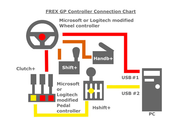

    I have the design all worked out. It might take me a while to put it together but in theory it should work. Some clever programming might be needed to relay the state of the clutch from the main game controller to the H-shifter game controller but I'm confident it can be achieved. One of the really exciting things about the design I am working on is the possibility of re-configuring the gearbox layout and type in software. For example, change it from a 6-speed manual to an 8-speed manual, change the H-layout to accurately match the car you are going to drive, and to switch from H-pattern manual to sequential-shift to automatic gearbox. A quick google image search for gearbox gear layout patterns will show you the kind of variations my design could cope with.

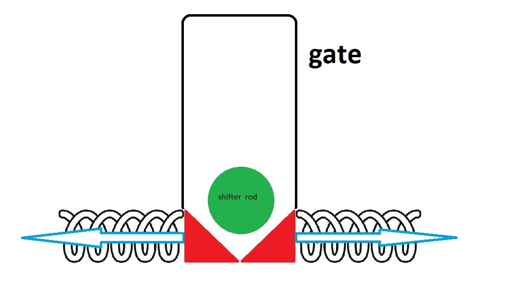

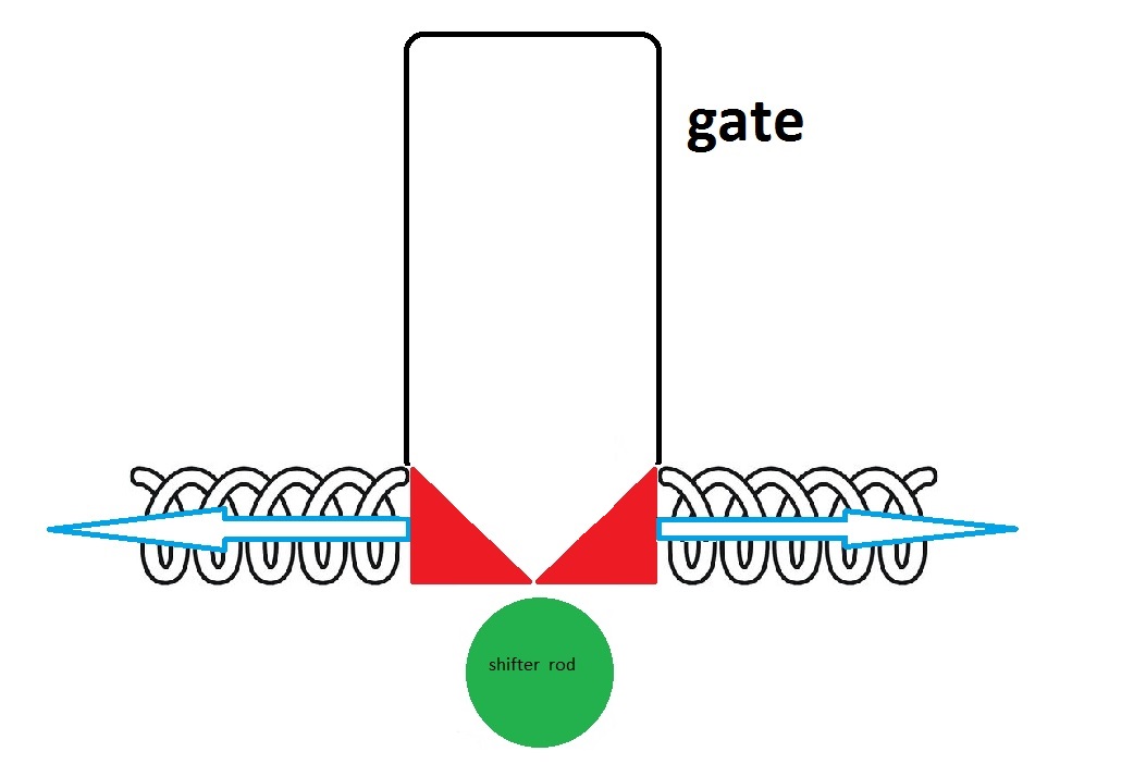

    i have added a top view of a shifter explaining my idea.
    in the above picture the shifter has a gear engaged(the clutch pedal is not pressed).
    but with proper force and without use of clutch the shifter can go to neutral(exit the gate).
    the coils will ensure the required stiffness.
    on the other hand if the shifter is in neutral there is no way to enter the gate because it is blocked.
    so by use of a chord (connected to the clutch pedal) just like the one conected to a real gas pedal we have to find a way to retract the springs and free the gate for the shifter rod to enter.

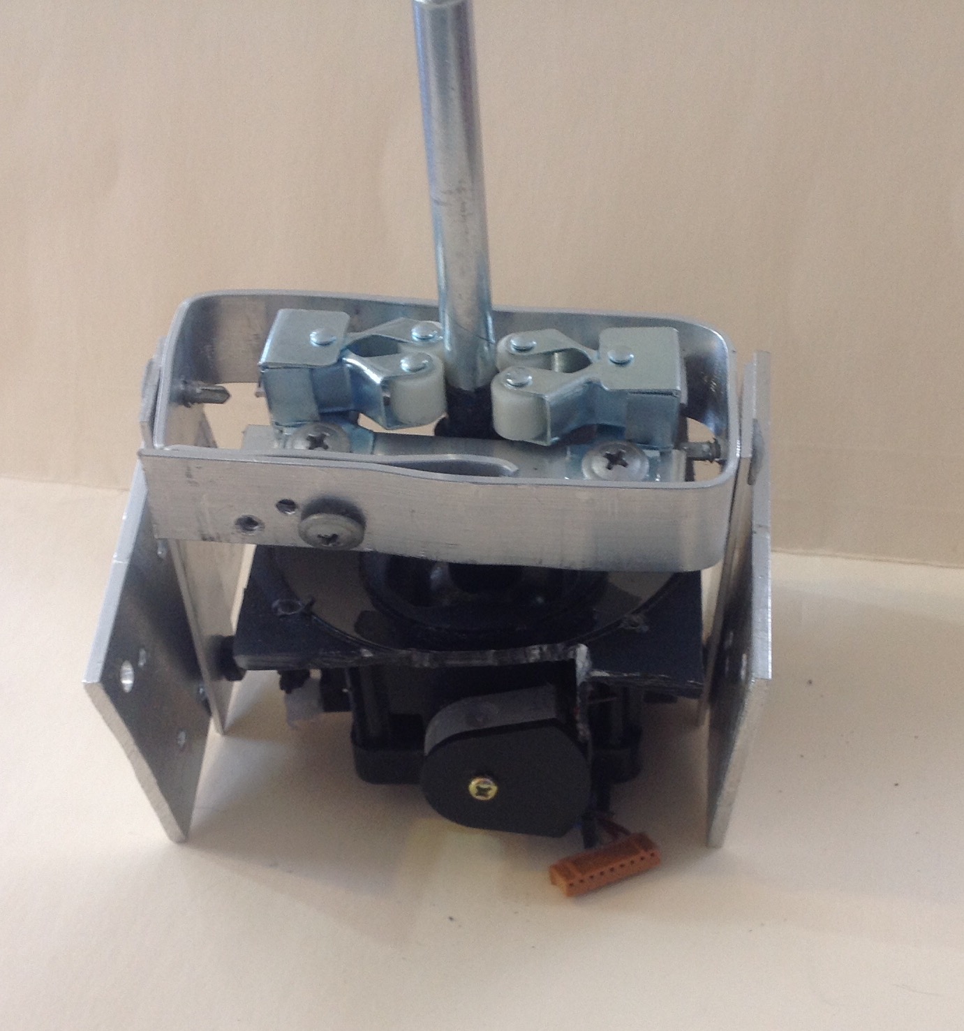

    You don't need the mechanism on every gate. The trick is your gate "lock" moves with the gear lever. See photo.
    Expand image for detail. This is my current "gate" mechanism sitting over the lever assembly. It's loose, as I just dis-assembled it.
    The "locks" on my assembly are those catches you use to hold cupboard doors shut. The two locks move on a lever side-to-side with the gear lever. So you only need TWO.
    Of course, the cupboard door catches don't stop movement of the lever. I love @pipis2015 's design. All you need is an electrical release, just like a real electrically controlled door lock. This would be a much simpler option than the design I came up with.
    As far as the electrical signal is concerned, you get that from your clutch pedal. If you built your own pedal that will not be a problem.. If it is built in to the pedal set you have don't despair. I have a hunch it would be possible to write a program to monitor the steering/pedal game controller for clutch presses and send a signal to your gearbox controller. I will look into this further.

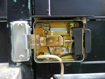

  12. RacingMat
    2,233
    20,876Coins
    +2,079 / 21 / -2
    yes, a simple way could be an electrical door lock
    - one way OK without current
    - other way, need current to release the latch like @pipis2015 said

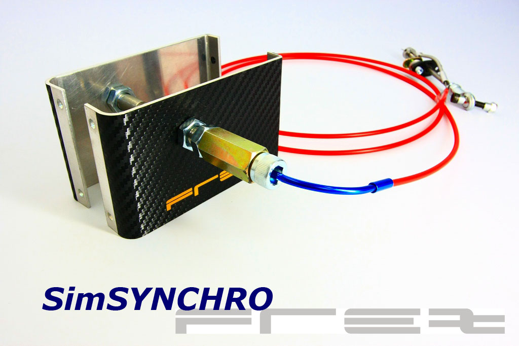

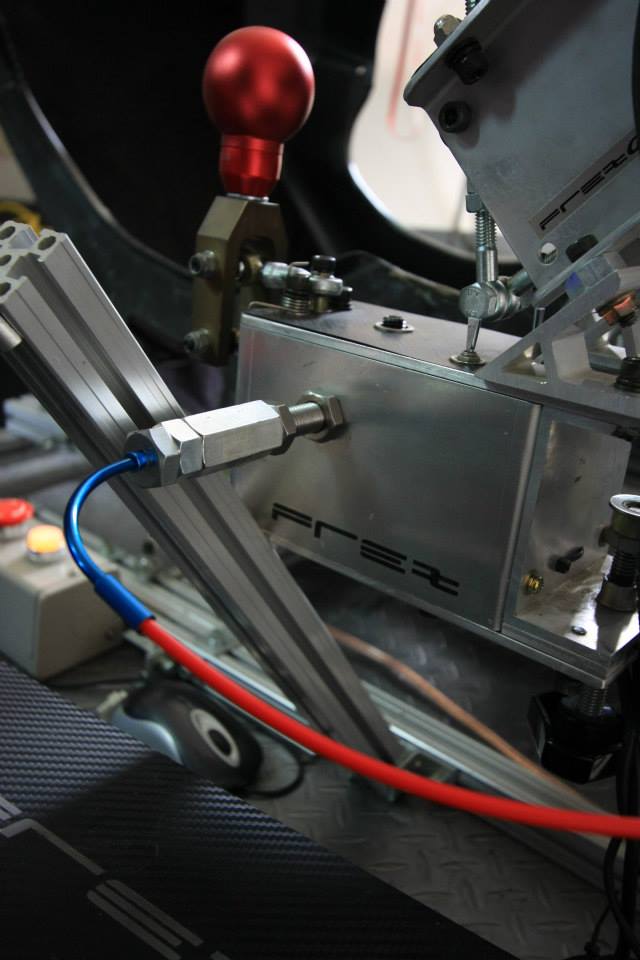

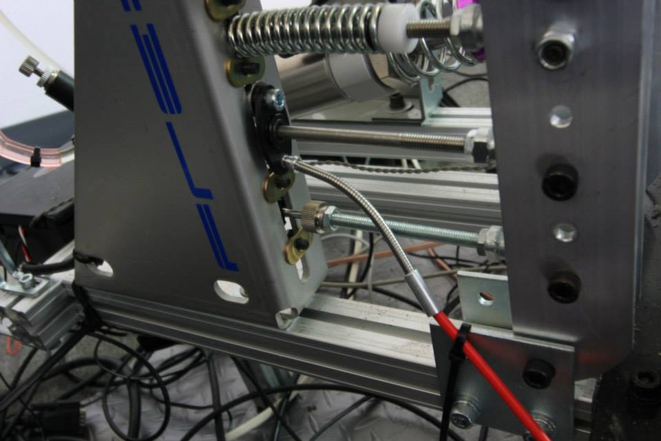

  16. RacingMat
    2,233
    20,876Coins
    +2,079 / 21 / -2
    It looks like a bowden cable indeed: the clutch pedal pulls a cable which releases a latch in the shifter
    My concerns would be
    the shear force on the latch: does it induce to much friction to prevent a good moving?
    how much the action on the pedal is increased?
    and how quick is the return to initial position of the lock?
    Here is the shematics
