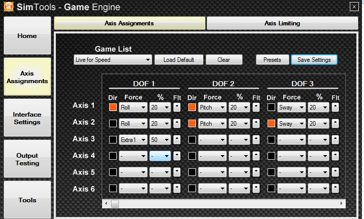

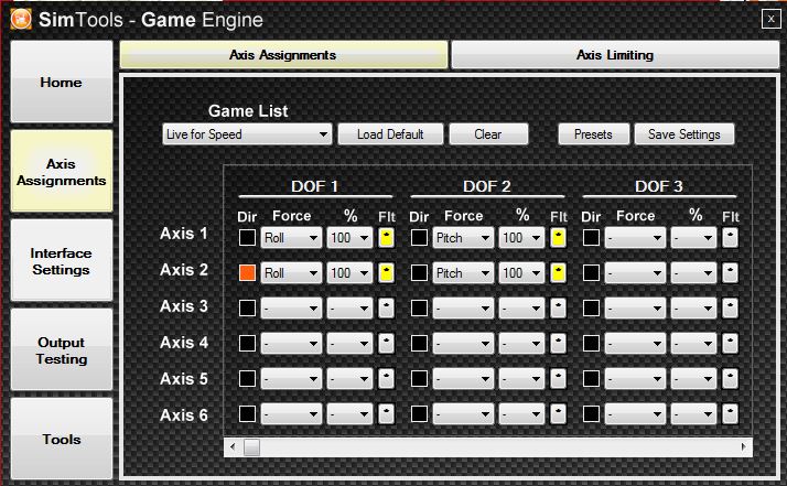

  18. insanegr
    insanegr !N$@n€
    Jan 14, 2014
    505
    Athens
    16,715Coins
    +499 / 1 / -0
    have you created a profile for LFS in game engine - axis assignments and saved it?
    this is mine, you have to make your own

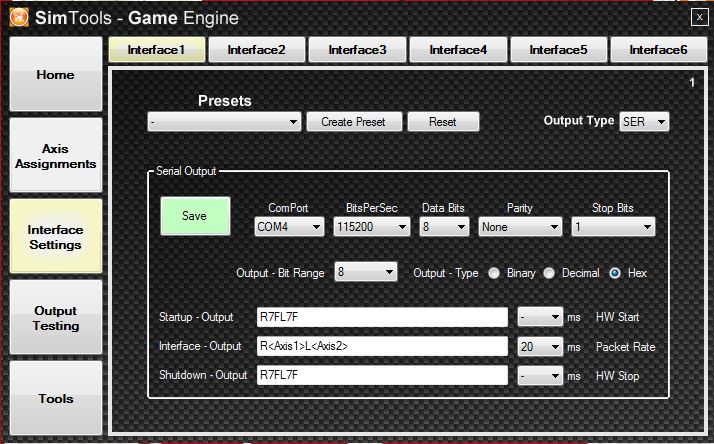

  19. Stealthelius
    Stealthelius Member Gold Contributor
    Nov 17, 2015
    51
    Office Clerk
    Rome, Italy
    106Coins
    +10 / 0 / -0
    These are the images of my simtools (Axis assignments - Interface)
