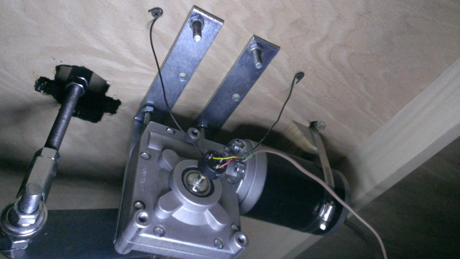

  5. bsft
    @mazhar, have to to not completely agree there.
    Ive used hall effects like the ones above and as good as they are, I found with enough abuse, the bush on the shaft wears and tends to bind up. Not a great problem, but a squirt of CRC every now and then helps keep them smooth.
    I use RS components wire wound pots these days, granted they cost about $37 each, however, I have them on a sim with over 200 hours use and not a problem. They use a better quality bush and have been found to be very reliable.
    And yes, continuous turn single turn is the way to go.
  6. BlazinH
    BlazinH Well-Known Member
    Oct 19, 2013
    2,145
    Oklahoma City, USA
    16,651Coins
    +1,839 / 32 / -1
    The specs for BI Technologies 6120 hall effect pots state, "Rotational Life - 10 million shaft resolutions with up to 8oz sideload". So either the specs are wrong, which is unlikely, or your pots are experiencing a lot more sideload due to your mounting method. I have well over 100 hours on three of them now and have no indications of any problems with them to date. But as I've said before, you must mount them in way that allows the pots to move freely inline and perpendicular to the shaft. The mount only needs to be strong in the rotational axis of the shaft. And since these are non-contacting, that doesn't even need to be very strong. If you aren't operating within the stated specs, you shouldn't expect them to last!
  7. BlazinH
    Oct 19, 2013
    2,145
    Oklahoma City, USA
    16,651Coins
    +1,839 / 32 / -1
    Had a thought. If the pots shaft gets hot due to heat conductance from the motors, this could possibly allow the shaft to expand slightly which could cause excessive wearing of the bushing. Mine always stay cool.

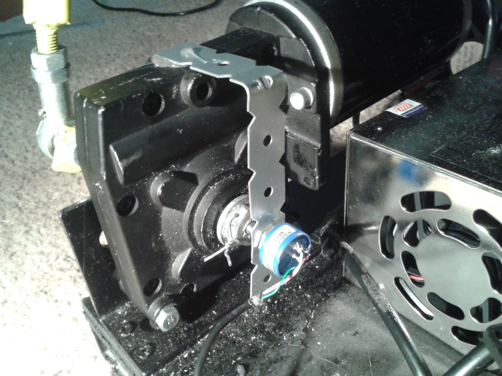

  8. bsft
    do you have a photo of how you are doing yours? Then we can advise
  9. BlazinH
    Oct 19, 2013
    2,145
    Oklahoma City, USA
    16,651Coins
    +1,839 / 32 / -1
    Just got done taking a picture. What I do may or may not work for you depending on your setup but I mount mine using just a piece of bailing wire wrapped around the body of the pot with the ends of the wire connected at a couple of different points. It allows the pot to move as stated in my previous post but still has enough strength to keep it from twisting.
    note: I utilize a 3dof platform and this motor is attached to the bottom of it. It's only function is to pitch the seat to give additional overall pitch to the platform. I don't want to pitch the platform itself much because, not only does it not feel natural to me, but my monitors don't move with the platform either. I have the push rod attached to the bottom of my seat. While some don't advise doing it this way, I am using a 825 watt motor so I have plenty of power to move the seat this way.

  10. bsft
    Heres mine. I drilled a hole in the back of the motor shaft bolt, to match the shaft size of the pot , 6mm I think, then I mounted the pot on a thin piece of steel bracket, bent it and glued it to the top of the housing.
    For the pot in motor bolt, I drilled a 2.5mm hole through all of it and put a piece of tie wire and twisted it up. Spot on.
