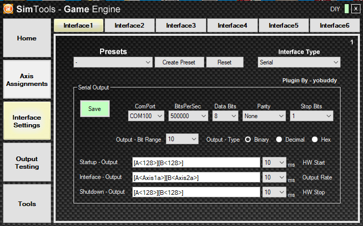

    Hi noorbeast, I have a little problem that I don't know how to fix:
    basically I would need that every time I finish the game, my platform has to keep the engines powered to keep them from crashing down.
    Is there a system?
    I tried to insert the values I found in another thread, but they don't work ... (see attached image)

  7. yobuddy
    5,374
    50,295Coins
    +5,149 / 18 / -0
    For SimTools 2, I think you would need a custom interface plugin, as the serial plugin only runs when is needed for a game.
    With SimTools 3 thou, you can use the parking location to have the sim lower itself to the lowest position before shutdown.
    Maybe give v3 a shot and let me know how it goes buddy.
