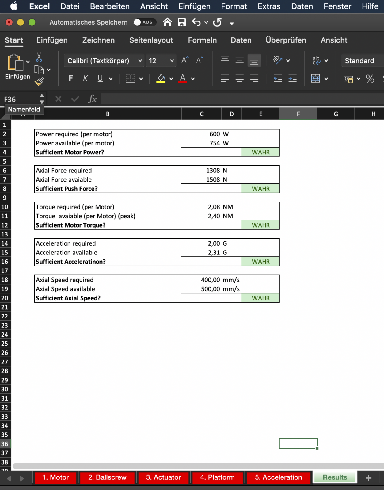

    I punched your motor and ball screw data into my Excel sheet and it says 'all good' :thumbs
    --> Download it here <--
    If you want to use it: Go through all the red Tabs and fill out all the red cells. See the results in the last (green) tab.

    +170 / 2 / -0
    yes thanks I already tested your awesome excel sheet :)
