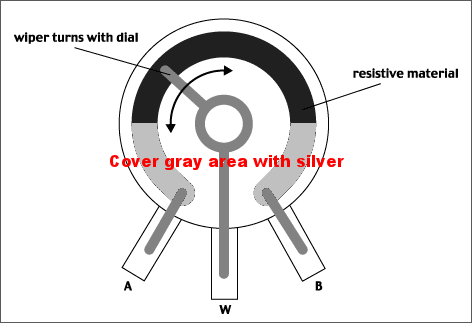

    i'm using cermet pots in my sim. Thgey got a rotation range somwhere between 0 and 280°. In my sim i only will use about 180° which will result in 1,6-3,5V. I can't get a mechanical solution for full pot movement so i searched around the internet how to increase my voltage electricly. I found this post http://electronics.stackexchange.com/questions/30719/analog-voltage-level-conversion-level-shift
    and build the circuit with the 2 potentiometers. Buit for me it isn't really working. I also found this circuit for 12V hall effect sensors and Opamp lm324n. http://3.bp.blogspot.com/_Yqa3j9ZhET8/SqBP73s9otI/AAAAAAAAAZ4/DhH-QrpshxA/s1600-h/circuit.png
    So did you think this will be working if i power my pots with 12 instead of 5? Sorry i'm really new to that electronics maybe someone of you got an idea or maybe demo circuit.

    Since the range you mentioned currently is 1900mv, if you supply your pot with 13.15v input instead of 5, you can get a 0-5v range using the same amount of pot movement. You will need to use the lower end of the pot because that is where the voltage will start at 0 and then go to 5v. The upper end of your pot will go from 5v to 13.15. Get it? Usually you use a separate pot to adjust the input voltage to your feedback pots, but in your case, if you are using 12v somewhere, you can use it directly. That would not quite give you the full voltage range of 0-5v but it will get you close.

    first thanks for your grat answer, but i think my english isn't to good to understand or i'm to tired :) i'll have a look at it again. If i understand right i have to set my pot voltaage from 0-1,9V and then increase with the pot hooked up to 12v theese 1,9V to 5? I don't really understand what you mean with lower and upper end.

    I assume that you have 5v going to you pots now. If you have 12v available, disconnect the pots from 5v and connect them to 12v. So the pots will now range from 0 to 12v instead of 0 to 5v. You have to use the low voltage range end of the pot where the voltage is 5v or less now. One half turn of your pot will now output 6v because you are putting 12v in. Just be careful that you don't accidentally put more than 5v into your arduino because you could burn out the input.
