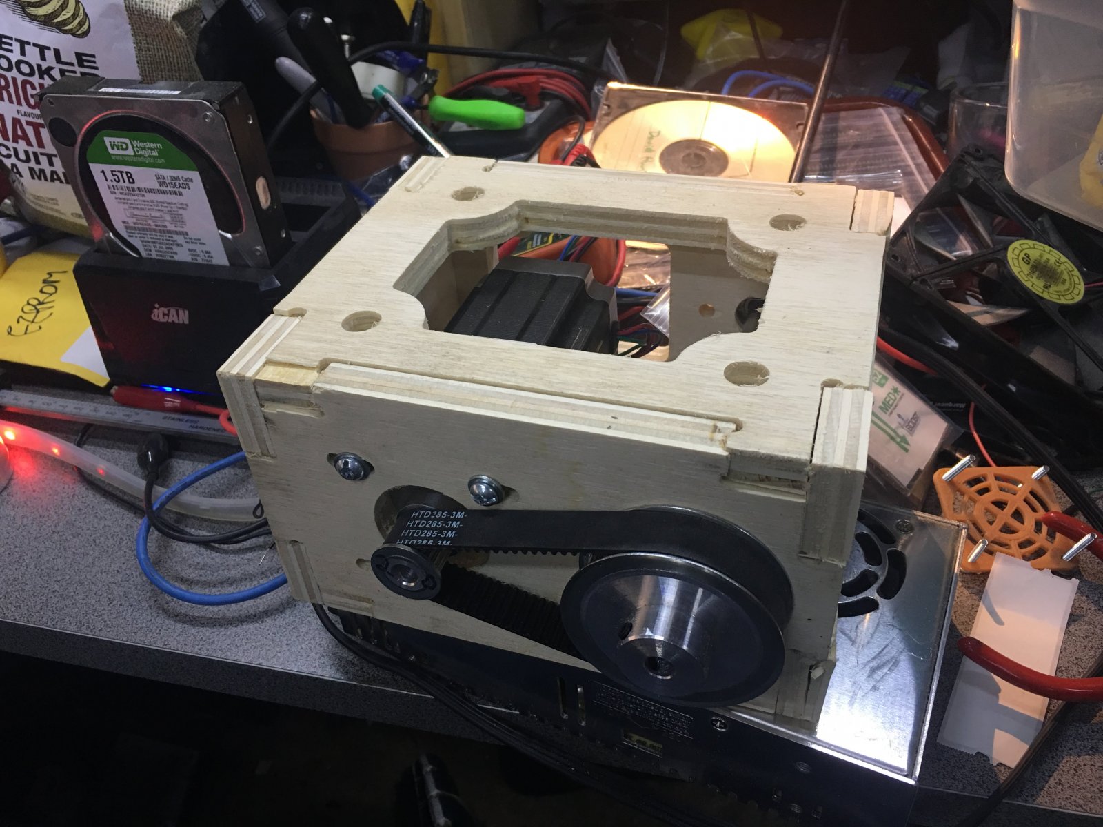

    As I mentioned above, I started playing with a Large-ish stepper.
    It is a NEMA 23 (57BYGH115-003B) 425oz-in.
    I am building it into a giant servo motor and am coupling it with a 3:1 belt drive to increase torque. With a 2 inch lever I calculate it to be approximately 40 lbs of lifting force.
    My current plan is to couple it with an arduino and drive it with a Servo signal exactly like your run of the mill servo. I will probably integrate a hall effect sensor for positional calculations.
    Rough dimensions of the "servo" are 6" x 4" x 7.5" and I am driving it with 24V on a Wantai Stepper driver at full step for greatest troque.
    BTW, I found SimCalc, what an awesome tool, thank you!

    Small update, I found a 10K potentiometer and quickly 3D printed up a housing to hold it. I wrote a very quick temporary Arduino script to read the "servo" position and then drives the stepper towards the set point and all works well! I then cut out a 3" servo horn and it's got some nice torque to it, but I'm not sure if it will be enough. ill play again tomorrow evening...
