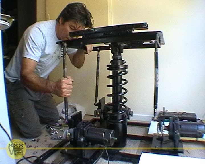

    Update: 16th March 08
    3DOF Rebuild.

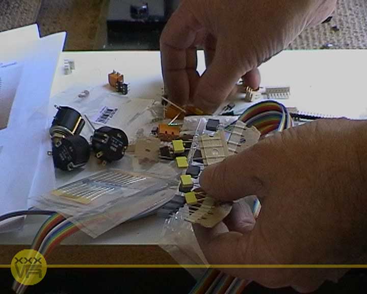

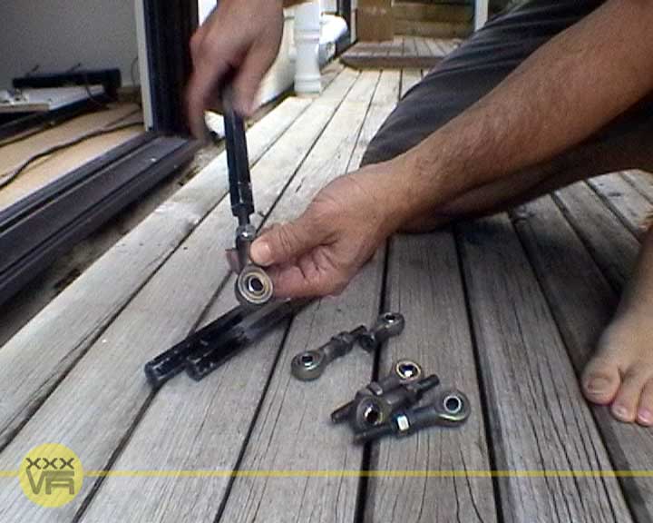

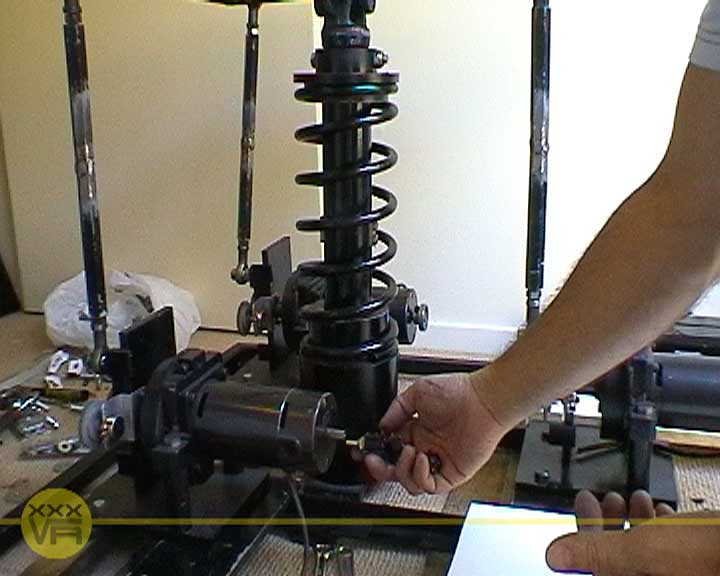

    Build 1 of the 3 DOF chair was a good primer, it showed areas which needed working on. Based on the current motor specs here are the changes being made.
    1. Repositioned 2 front motors further forward of axis point. This sets the fulcrum further away resulting in a reduction of the amount of effort required to tilt the platform and it also slows the speed of tilt. Will mean a less eratic and smoother ride.
    2. Conrods have been shortened to tension up the central spring. Should help dampen the jitter when the motors are awaiting commands at central position after a returned washout. (There is no jitter when motors are actually doing something other than for example holding the '0 degree' position)
    3. Potentiometers are being relocated to rear of motors where the shaft spins at 40:1. Multi-turns have replaced the single turn. A 2:1 gear reduction is being worked on.
    Thanos AVR interface components are being sourced and a PCB organised. Although there is no firmware for a 3DOF system yet fingers crossed Thanos may find the time to program one. Otherwise it may still operate as an over-engineered 2DOFa !

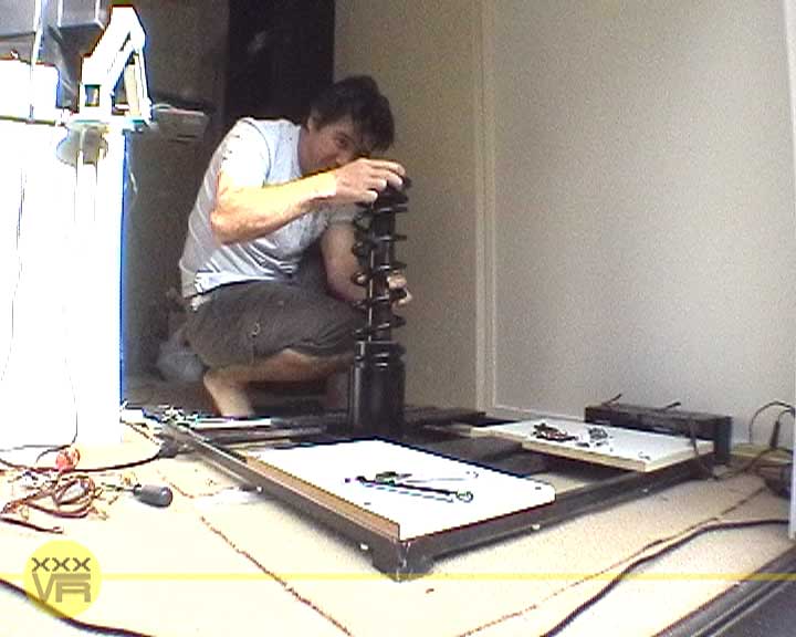

    Hi all,
    I have assembled the mechanical aspect for a motion chair which includes 24V DC gearhead motors. I'm working on the motor controllers now and also planning to assemble the Velleman USB I/O board when I get the chance. Once all that is done I'll be able to work on trying out the X-Sim software.
    cheers

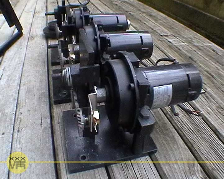

    Hi to both egoexpress and sirnoname and thank-you for your welcome.
    A gearhead motor is a motor with a gearbox built in.
    This particular one uses a planetary gear system.
    It has a gear reduction ratio of 40:1
    Shaft end the max RPM is 3200rpm / Gear end max RPM = 80rpm
    Torque shaft end 3.66kg/cm / Gear end Torque = 146kg/cm
    24Volt 7Amp 120W
    No it is not a windscreen wiper motor, I think you might be getting confused with CW's (a fellow kiwi enthusiast) system.
    The motors actually came out of an all terrain wheelchair.
    On my website in the video area there is a good example of their speed and power. But you if you are using Firefox web browser you probably won't be able to see them as they are embedded activeX objects. Let me know if you have problems streaming them and I will provide you with a link.
    Evan

    Yes it has been a while, being a prototype the chair took longer than anticipated to put together, but here I am!
    LOL when Mozilla presents multimedia as seamlessly as IE (for the mass population) then maybe I will look at crossing over, but that's not the topic of this thread - nice quip tho! ;-)
    I will see if I can find time this weekend to capture all 3 motors running. I'm avoiding running the chair until I finish the motor controller board. I am not intending to run the motor a full 360 rotation but perhaps somewhere around a 160 degree arc. I am a bit reluctant to flog the crank assembly too much while it is a wild ride. Once it has speed control then I will feel happy to try and run it to the ground.
    Yes I am very pleased with the speed and power output of the chair. It is a bit raw and harsh at the moment but I am working on a PWM motor controller and should be able to tame it soon - fingers crossed :)
    The All Terrain Wheel chair is an amazing buggy that can move forward in all angles. All 4 traction wheels counter rotate giving it amazing maneuverability. I wish I had asked for the motor controller for it when I bought the motors.

    Potentiometers have been mounted onto DC motors and initial tests with a 12V/25Amp bench power supply is successful. The motors are rated for 24Volt 8 Amp and even at 12V at slow speed I cannot stop them with my hand. Not long now until I mount them back onto the seat and test them with 24Volts and under load. Heres some pix for those who are interested. Also a video of the motor and potentiometer in action can be viewed on my blog.

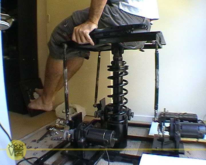

    Well since ppl are posting their working sims I thought I'd better update where I am at.
    I have the motion platform moving to pwm pulses. Max freq is 4khz and the feel is a little gravelly at this frequency but I don't think I have it set at full duty in the code. The washout is onboard at the mo.
    The pots on the motors (@10k) may need a bit more bracing from behind as I think they may flex a bit when I go for a spin. I have some pulleys as backup if bracing isn't effective.
    The floating charger and Sealed Lead Acid (SLA) cells are series and parallel wired to give me 26.9 volts at 18amps. But when the floating charger is on this gets boosted to 28.8volts. The H-Bridge drives are rated max at 28volts so I have tripled up 4 inline diodes (12 in total) and this has done the trick to reduce the voltage to 23.9v without trickle and 26.9v with trickle on. The diodes get very slighty warm and the H-bridges don't even get warm. Mind you I haven't gone hard out, just left the motors running and searching for '0' in the washout code for 30 minutes.
    Other than that I can start to look at some computer interface stuff as I feel the platform is more or less ready for it now.

    It is a planetary gearbox with a 40:1 ratio. On freewheel they do move slowly down if there is weight on the chair. I have tuned/adjusted each strut so the chair sits flat and the big spring has been adjusted (see the big solid cylinder and adjustable washer below spring) so the chair naturally sits with cranks at 180 degrees. Everything important on the chair is bolted and adjustable. (except for the seat rails on top dammit! they are spot welded on)
    I have posted a video on my website of the chair centering under power. On the video I push my hand down on the seat and you can hear the motors chatter as they fight against my hand to keep the platform centred. Washout is adjustable in the firmware. This is only a temporary control until Thanos releases his solution.
    http://extremevr.co.nz/media/torture-chair.wmv
    I think all the different sim platform designs have their merit.
    I chose the tripod design because I want 3 DOF and I am not as specialised just in car-simming, I want flightsim and fps-sim in the one chair too. I feel heave is important. I would like a 4th axis but maybe the next model.
    I think that the tripod design will be very fast in response time and transfer smaller vibrations a lot clearer with it's push rod action versus a swinging motion. The actions can be made dramatic with 2 motors creating a change in angle or for a finer motion just one motor moving the same angle. This is not very clear in the video because I was only testing by contacting a bare wire across the inputs so singular actions were clearer. Max = 100mm movements. Cranks could be extended but I wanna feel what type of effect 100mm movements transfering to the body are like. A very tight jap performance car?
