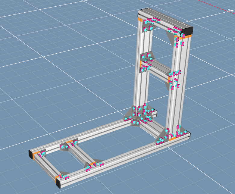

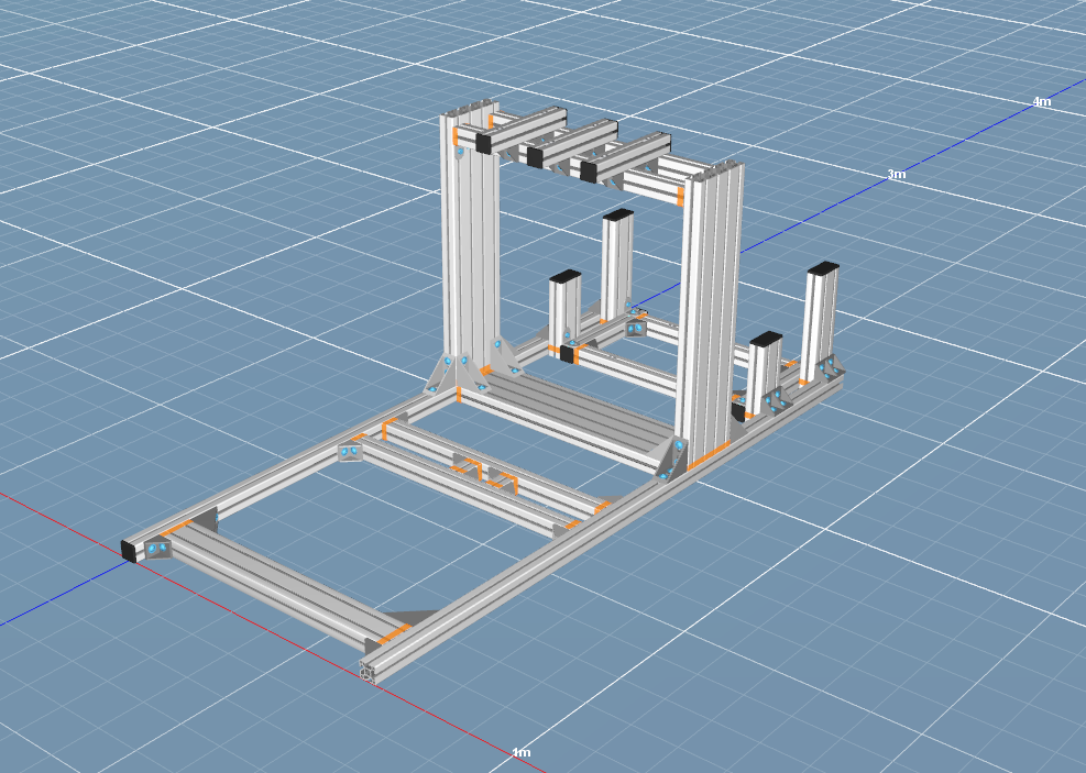

    I started with planning this rig out of mostly 40x40 aluminum profiles:
    With the wheel- and pedaldeck like this it should give me plenty flexibility and at the same time should be really sturdy once everything is set.
    The 80x40 profile in the back will hold my motors. The two in the middle will hold a cardan joint.
    The distances between the back bar and cardan part is not set yet. I guess thats something I will figure out when I am putting things together.

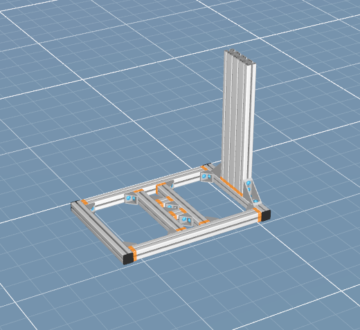

    This is what I thought to use as a frame for the seat:
    Here I am not sure if I need it at all. I might just mount the seat and the cardan on a metal plate.
    In that case I need to figure out how to mount the bars that go from the motors to the seat at shoulder height. The seat will propably be a sparco evo or some other not too expensive.

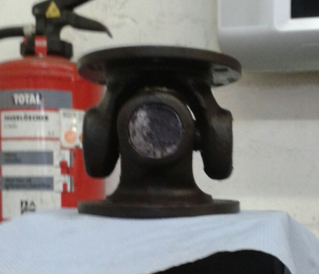

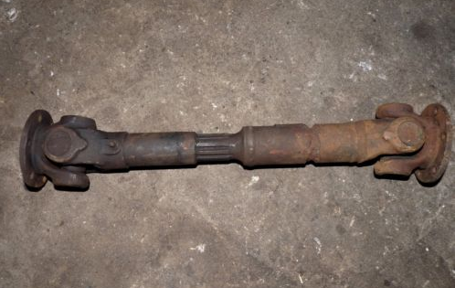

    I still have no cardan or anything for the pivot. Can anyone help me on this?
    Whats best to use with no welding skills?
    21,494
    150,584Coins
    +11,017 / 55 / -2
    Many use a uni flange from a rear wheel drive car tailshaft and you could find someone to just weld one to a plate for you, which would be pretty cheap even paying for the welding. You can buy double flange uni joints, but they can be a bit expensive.

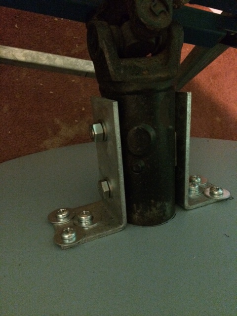

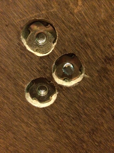

    @konterror - I attempted to weld my UJ to a steel plate and it was just not playing ball.
    I ended up just drilling two 10mm holes right through the middle and mounting to a piece of wood that will eventually be the base of my sim.
    The bottom of the brackets are held on with "T nuts" for extra strength in the wood from underneath. (not screwed all the way in so you can see)
  7. shannonb1
    shannonb1 Well-Known Member
    Mar 12, 2008
    1,107
    Sales Intelligence
    Virginia
    8,909Coins
    +598 / 5 / -0
    I strongly advise that you strengthen that....those bolts will snap on you and are not nearly enough to hold the proper weight especially when you add extra forces.
  8. bsft
    they will hold just fine, ive done that in the past, never failed on a full frame.
    Mind you , give it a weld if you can
  9. shannonb1
    Mar 12, 2008
    1,107
    Sales Intelligence
    Virginia
    8,909Coins
    +598 / 5 / -0
    Im 240lb...that would slump over in a hurry for me. What size bolts? What grade?
  10. bsft
    Ok then. Weld it up if you can. Not everyone is over 240lb

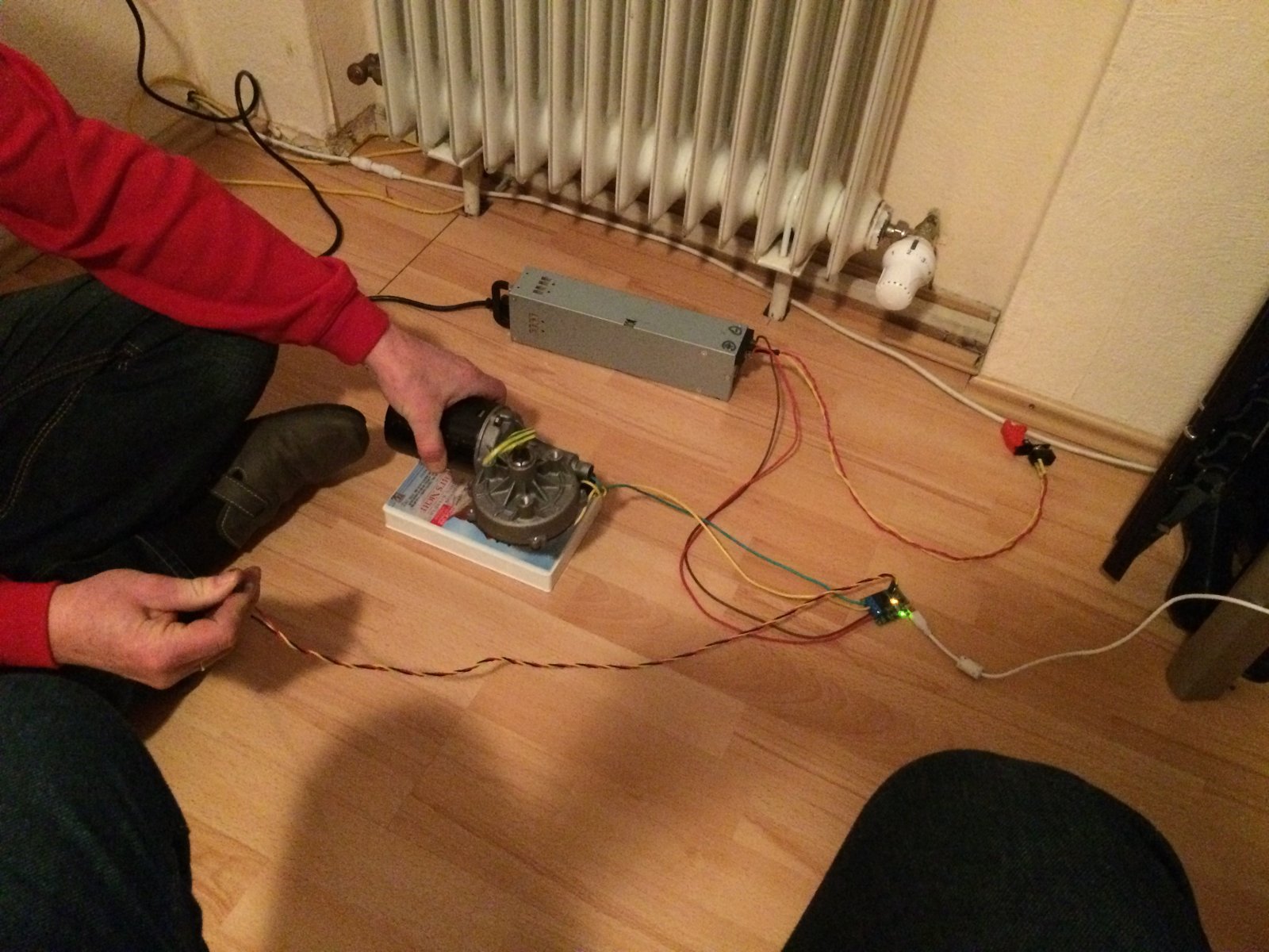

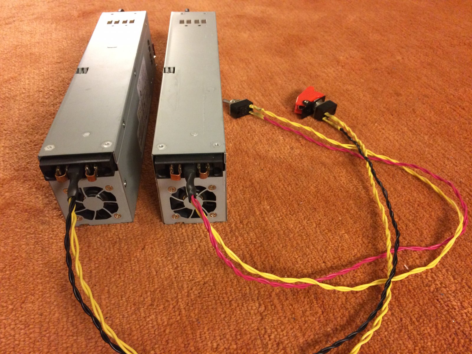

    I actually got something "done". With some help of my father (he is way better in electronic than I am) the electronics part is working. PSUs are modified, and wiring to and from the jrks is correct.
    Here are the completed PSUs:
    @Slider : Your tutorial is more than great, thank you very much! ( http://www.xsimulator.net/community...-server-power-supply-for-12v.5774/#post-60617 )
    Here is a picture of the temorary build to try out the jrks and see if everything is working (and it does work):
    @eaorobbie : Thank you as well. Your tutorial for setting up the JRKs awesome :thumbs ( http://www.xsimulator.net/community/threads/playseat-to-2-dofseat.5401/page-2#post-56352 )
    Here a really short video of the "function test". The pot is turned by hand as there is no mount for anything, yet.

    One of the most important things I got an Cardan of ebay for 5€ :D
    and my father was able to make a flange joint out of it:
    As before; in case someone is interested I can upload the CAD files as well.

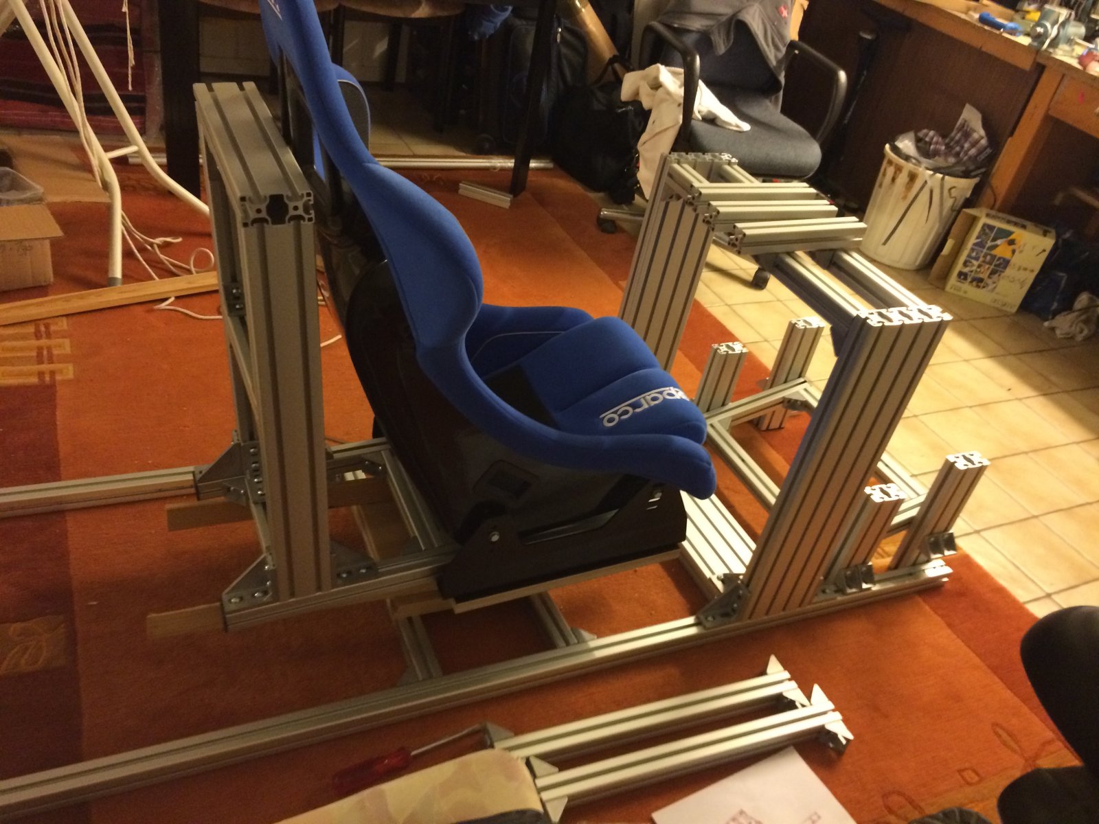

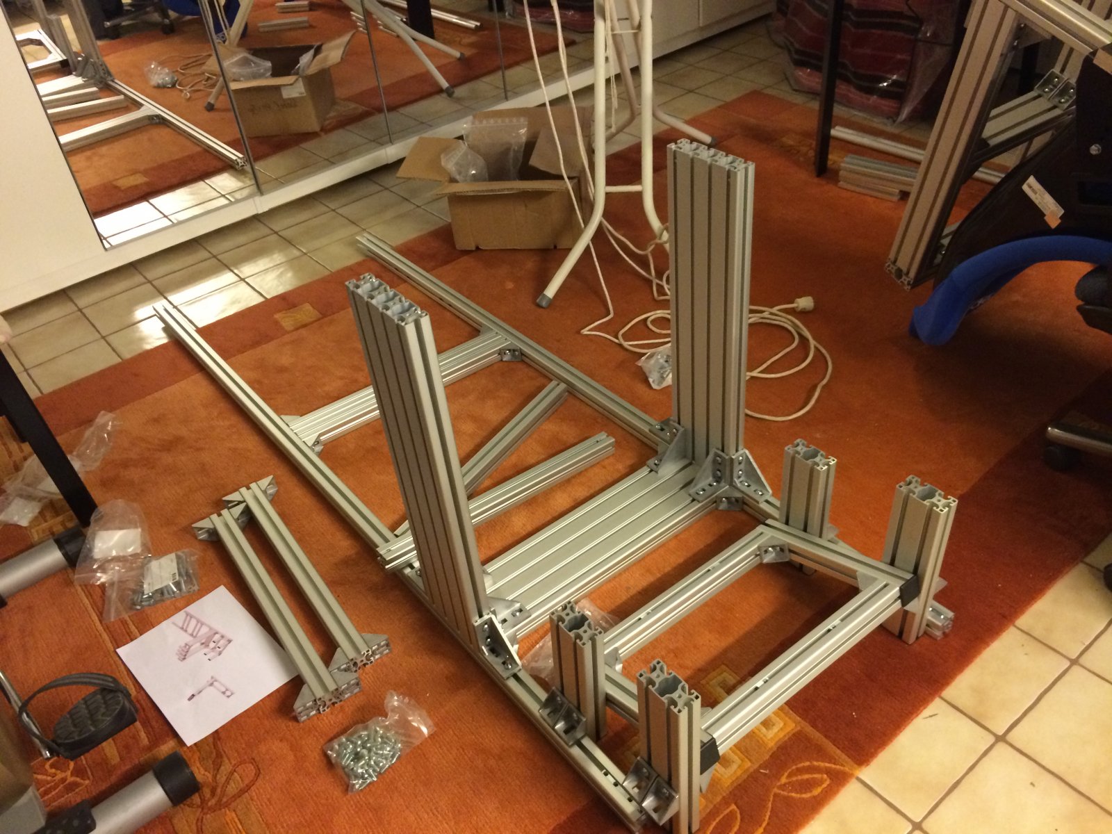

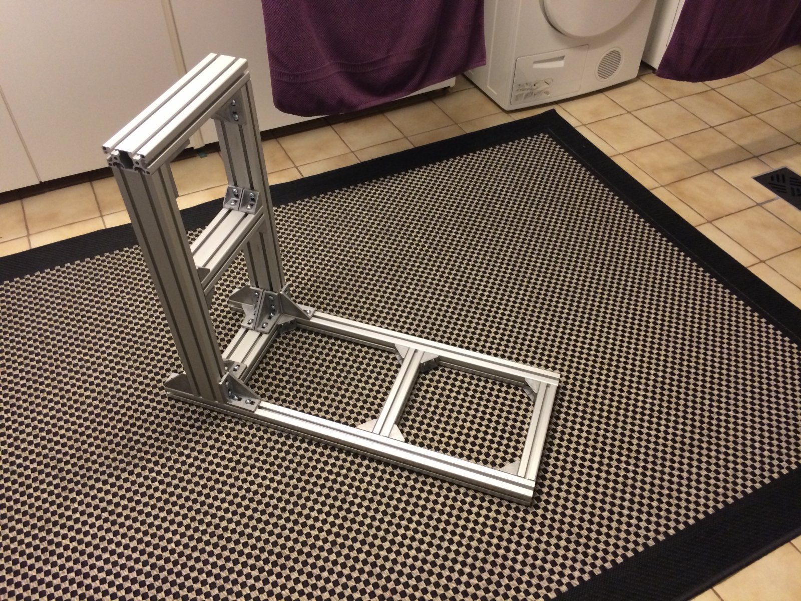

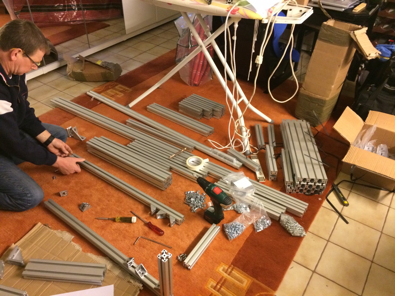

    I ordered tha aluminum two weeks ago, and got it last friday. So I started building (once again with my father :))
    This is what it looked like in the beginning.

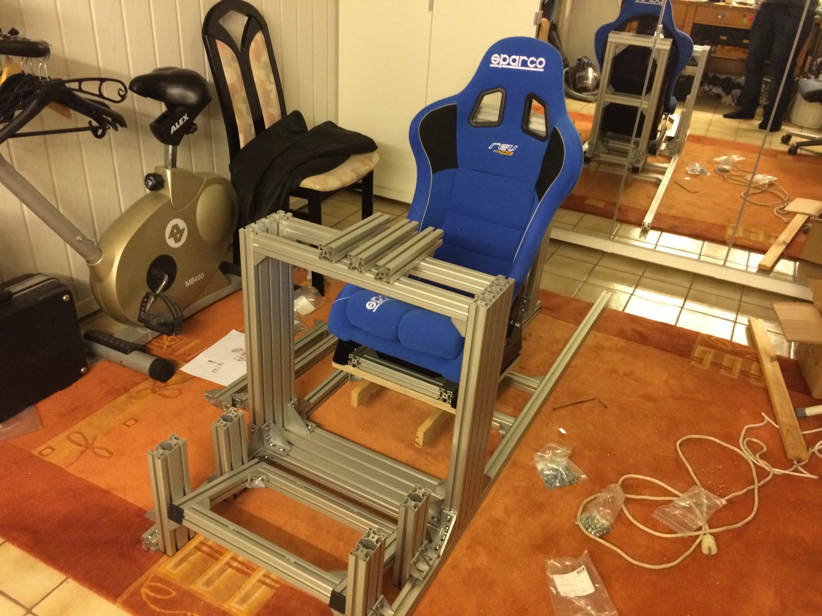

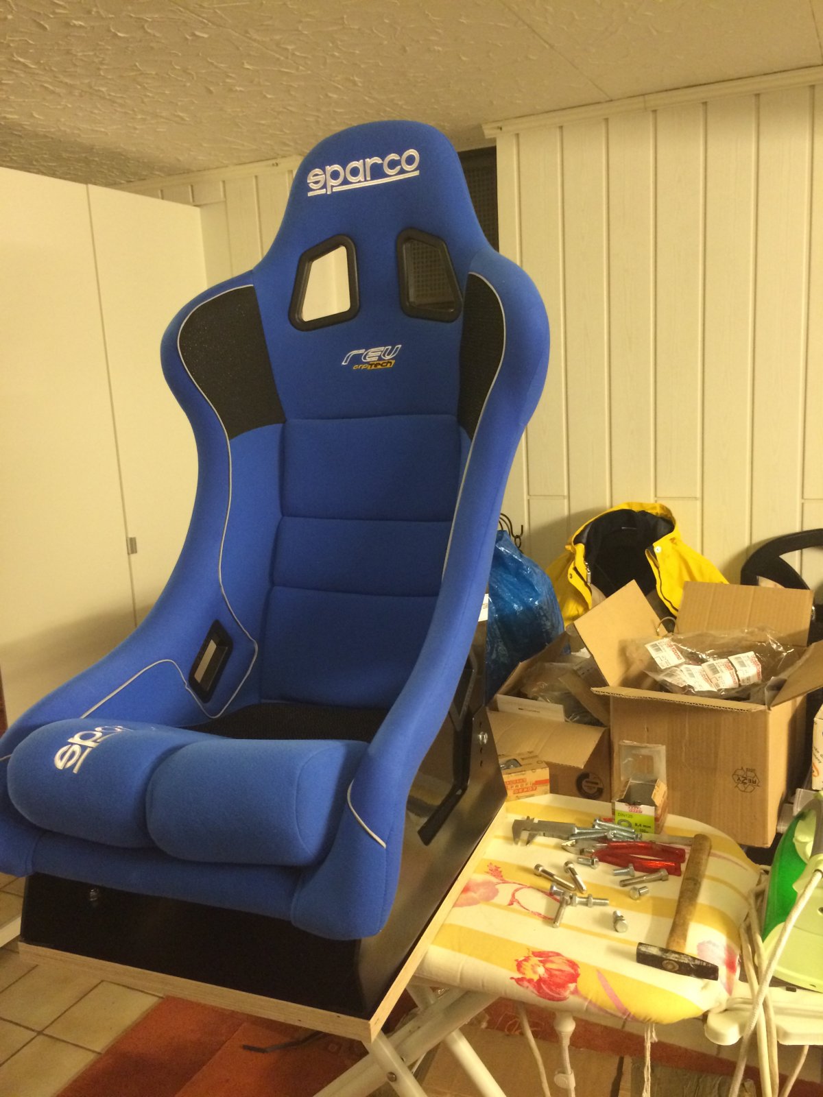

    After some time we got the seat part finished:

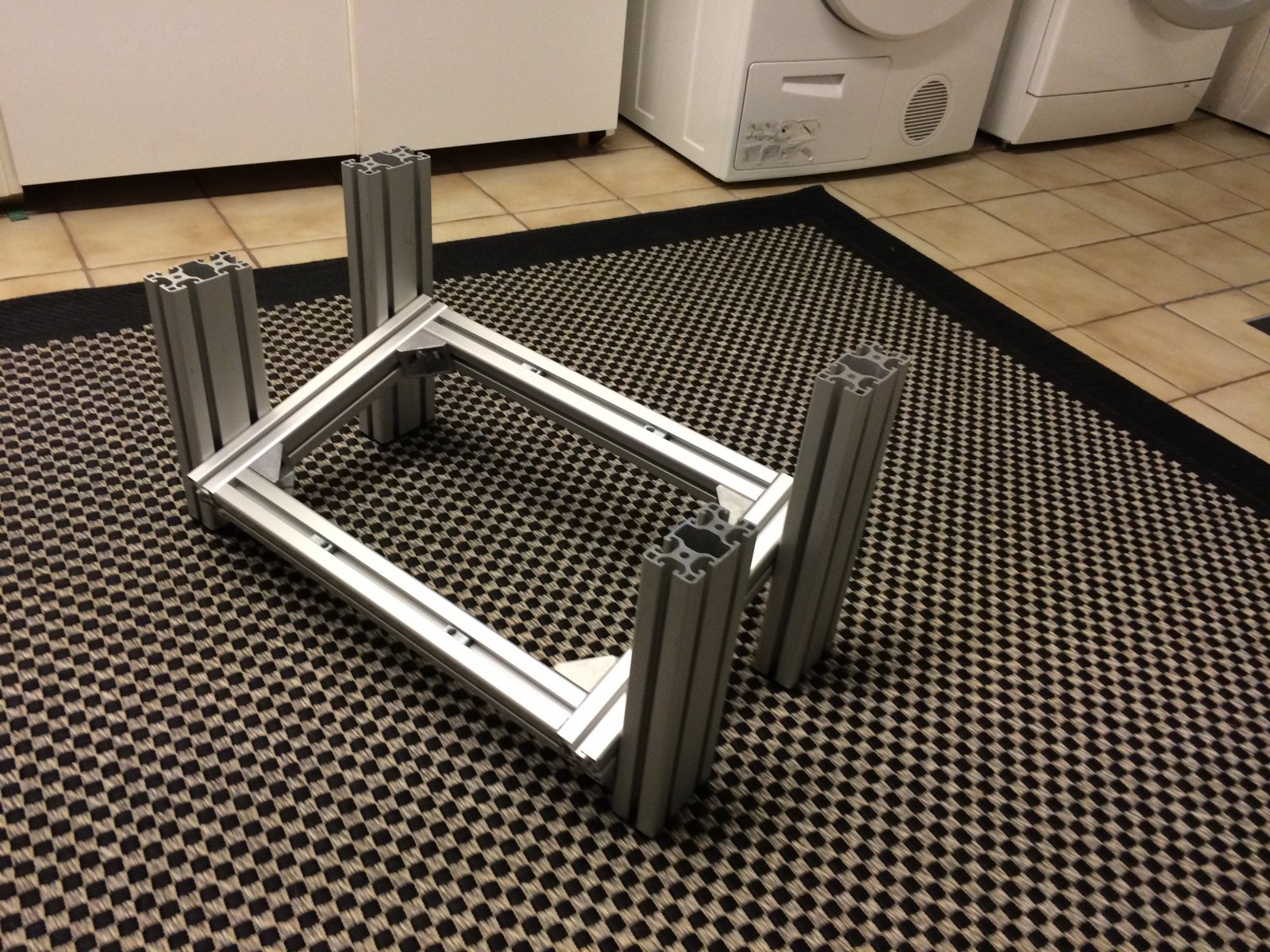

    And the pedale "deck":
    After that I figured out they send me a little too few of the sliding nuts (or however you would call them) so we have 142 screws left but no nuts :D They just forgot to ship those, they will be here this week. At that time building can go on and there will be more pics.

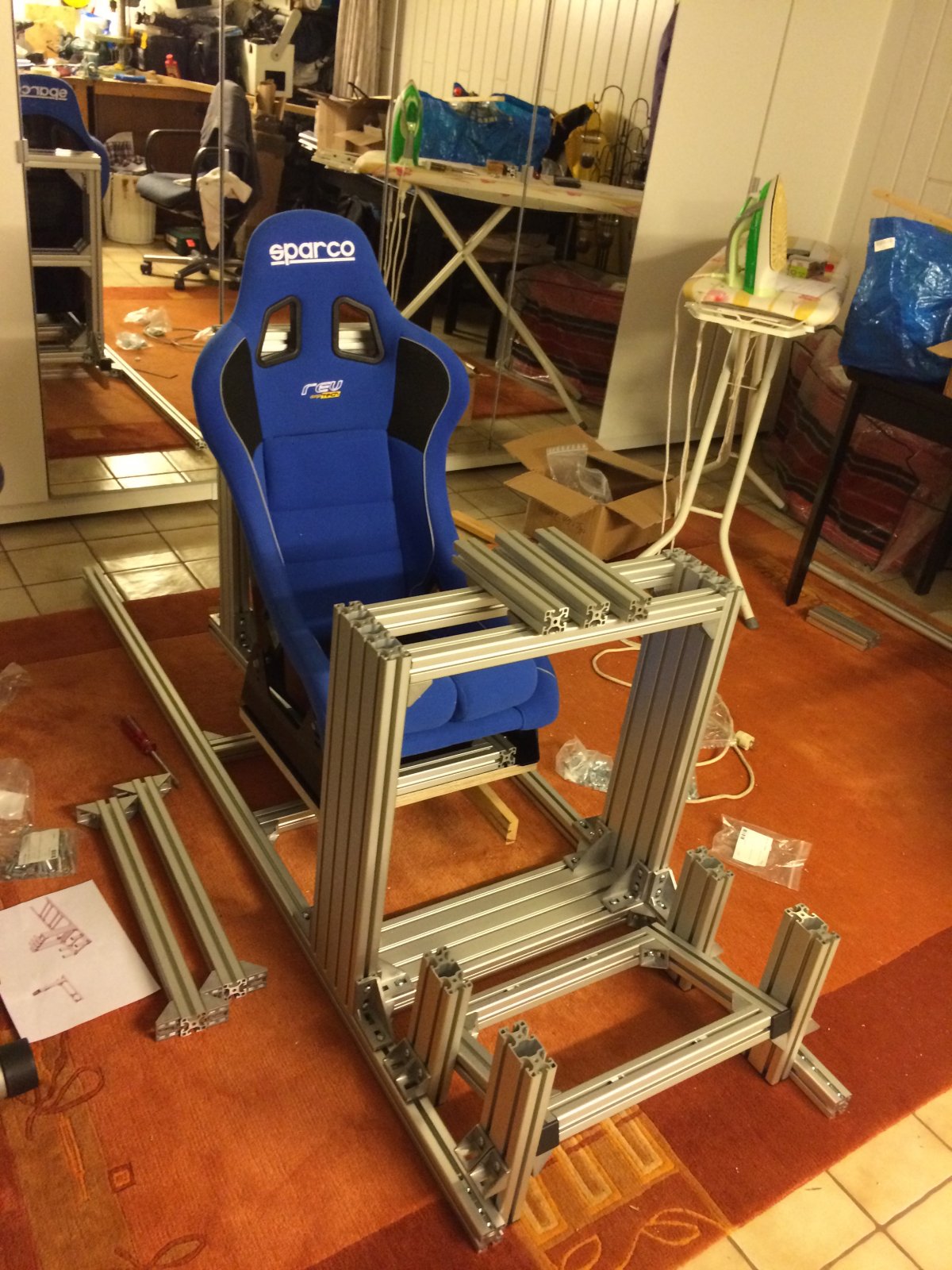

    Last but not least, a picture of the seat mounted on a wooden plate. That will be "married" with the aluminum part out of the second picture.

    I received the missing parts yesterday, so the building went on:
    Now it looks like this:
