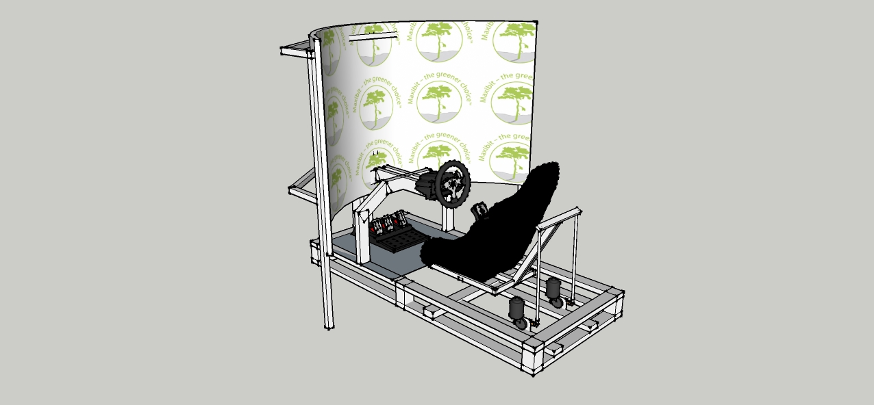

  6. Kiko Tocci
    Kiko Tocci New Member
    Feb 14, 2011
    26
    Brazil
    349Coins

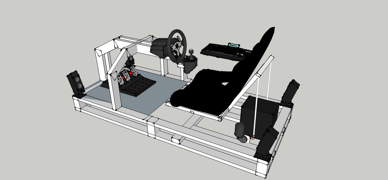

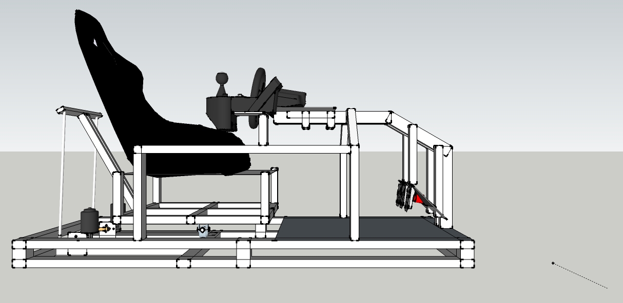

    I've been away for a few days, but now I'm back.

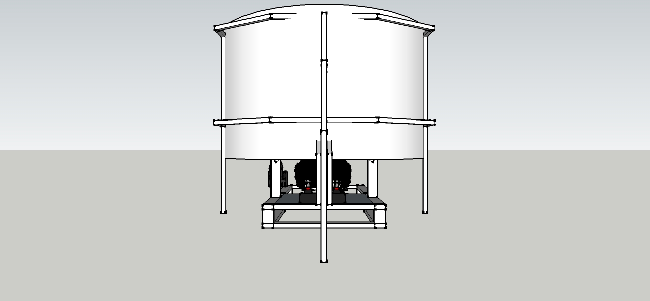

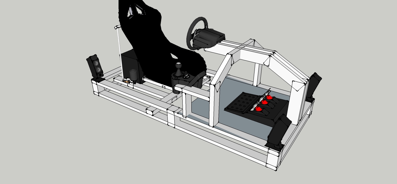

    While I hope the electronics parts arrive, I put a little time in the layout of my simulator.
    I'll post to you the 3D model I'm doing.
    I would like suggestions to further improve my project.
    Go there a few observations:
    1. The screen is removable, and may adjust a monitor or tv of any inch.
    2. Not yet finalized the support gear and keyboard, will be tomorrow.
    3. I wanted to observe more or less, measures and slope of the seat support for engines.
    4. The structure we intend to use is steel, because I want something very sturdy.
    5. I also wanted to observe the action on the seat, steering wheel and pedals.
    6. The wheel will be adjustable in height and depth, and the pedals are adjustable in depth.
    Thankful and a great weekend everyone.

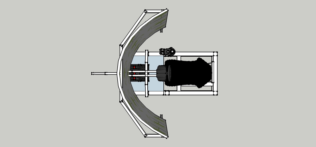

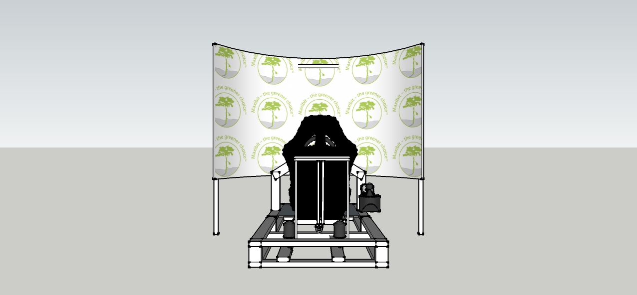

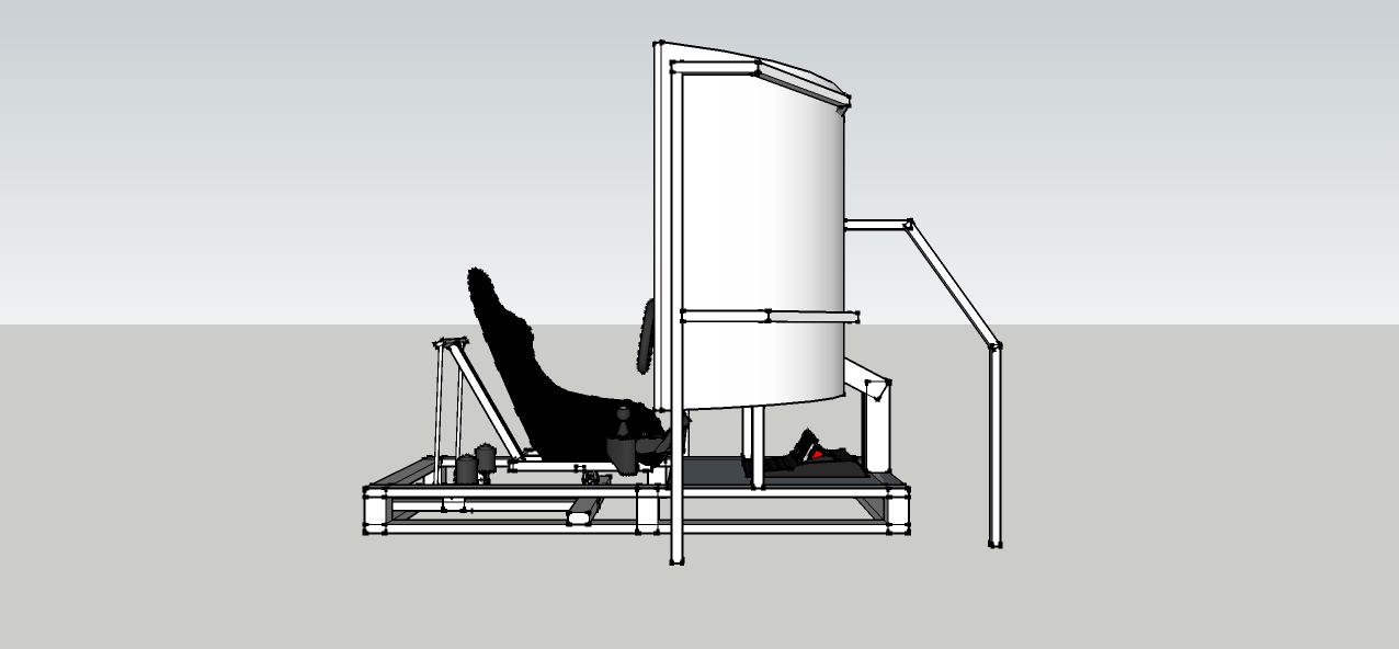

  7. Kiko Tocci
    Feb 14, 2011
    26
    Brazil
    349Coins
    More posts of the chassis, now on the projection screen.
    I await comments from you.
  8. bsft
    Nice design there! However, wouldn't it be better if the wheel and pedals were part of the motion seat? Just a thought.
  9. Frakk
    Frakk Active Member
    Apr 15, 2009
    1,144
    328Coins
    Good job Kikko, I like the front end! When you make the back end, make sure you have different positions to play with and tune the geometry.
    bsft: no, this setup will give better feelings with less amount of work from the motors.

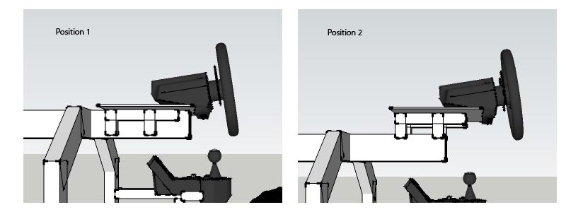

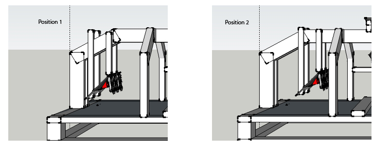

  11. Kiko Tocci
    Feb 14, 2011
    26
    Brazil
    349Coins
    I made some updates to the layout.
    As I said earlier, the wheel would be adjustable in height and depth.
    Note the position of the steering wheel in the picture below.
    The same goes for the pedals, they can be adjusted both in height and in depth.

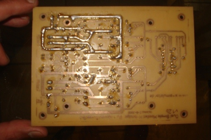

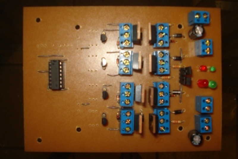

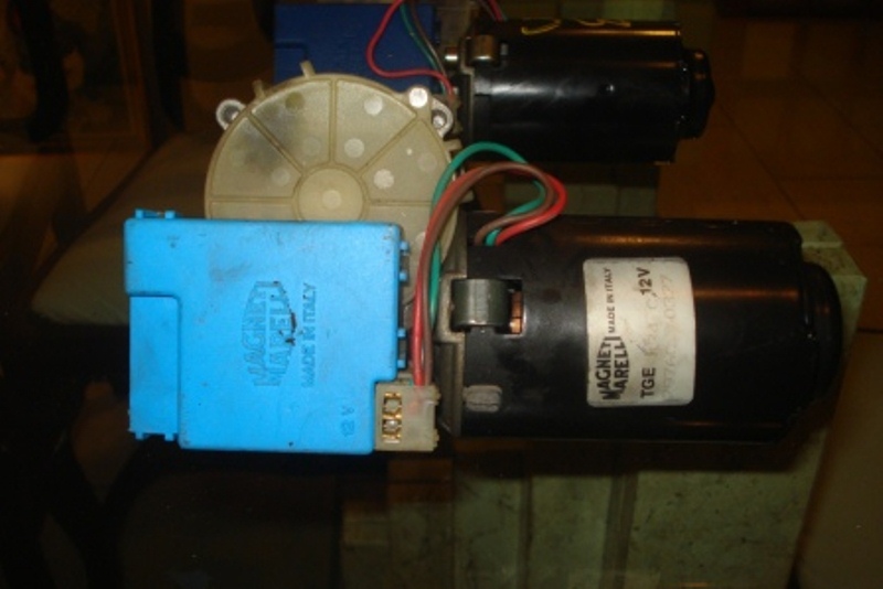

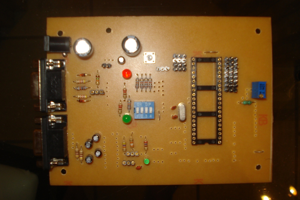

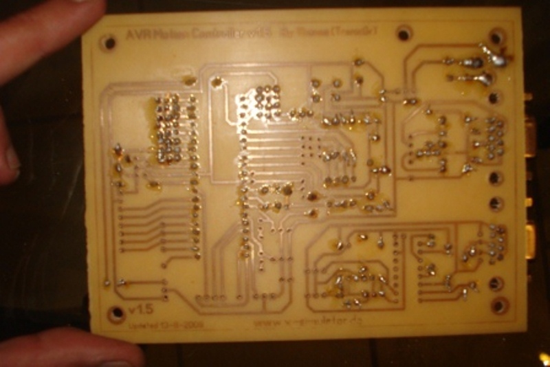

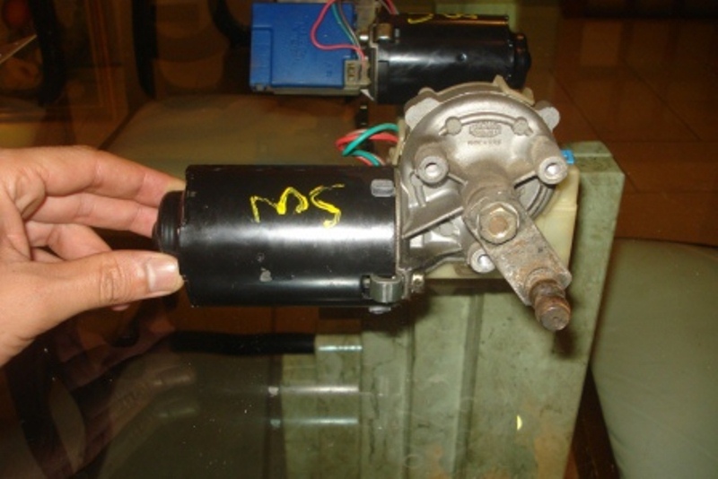

  13. Kiko Tocci
    Feb 14, 2011
    26
    Brazil
    349Coins
    Below pictures of the cards I'm doing and I just bought the engines,
    For those who could not even weld, I think I'm doing well ... rs
    After much reading follows from the work, but there are still some parts to arrive.
    I ask for the experts that give a look and tell me if it's alright.
    They can take a look at the weld to see if it also good?

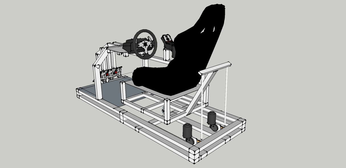

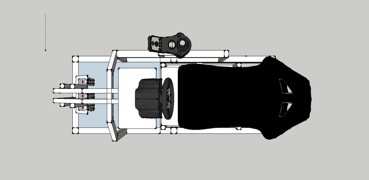

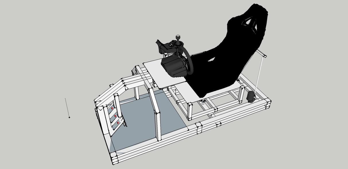

  14. Kiko Tocci
    Feb 14, 2011
    26
    Brazil
    349Coins
    Here is the latest update of the frame,
    I made some adjustments in overall width, in order to pass through the doors without any problems and also did an update at the seat, where it will be adjusted for height, inclination and depth.
    As I said earlier, this type of frame that I'm doing it can be used either as the GT and Formulas.
    The materials are already purchased and next week start production.
    As for the evolution of production'll post pictures.

  15. fermevc
    fermevc Member
    Jun 16, 2009
    126
    Networking and telecomunication
    Serbia
    5,956Coins
    +60 / 0 / -0
    Looking good :thbup:
    Try to remove solder residue (the greasy stuff) from DSMhb board, and you should solder the HB resistors before mounting mosfets (Thanos's advice).
    Keep up the good work :)
