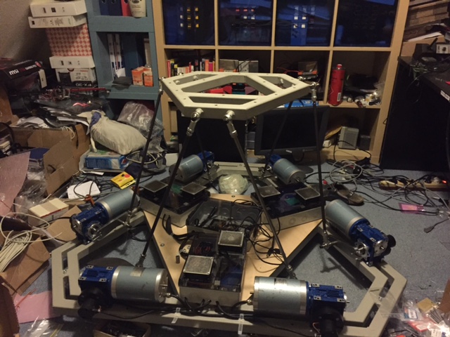

    Hi guys,
    In the meantime I'm also finally arrived the 6DOF / Oculus world.
    I want to show my 6DOF project and appreciate if anybody has some comments about it.
    At first some pictures how the current development is going on. At a later stage I also want to share all my drawings and 3D models to the community.

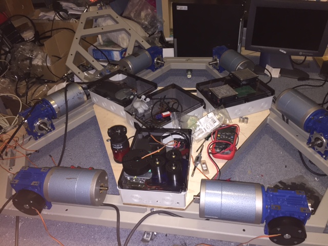

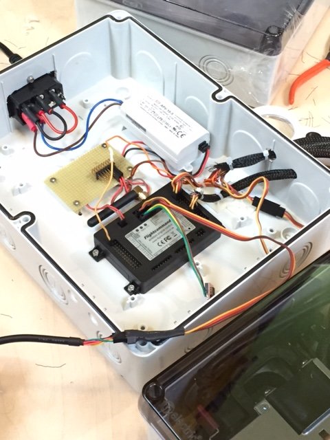

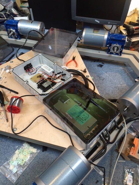

    Today I'd some time to wire the first motor control box. This box includes the power supply and H-bridge-driver PCB for two motors.
    more is coming soon....

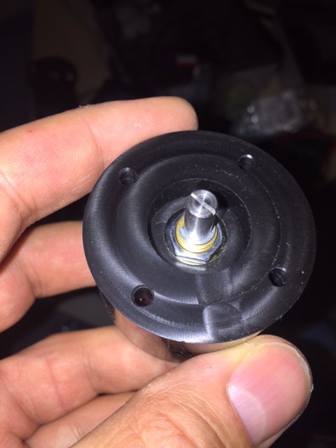

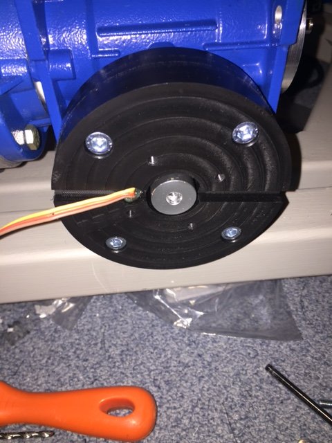

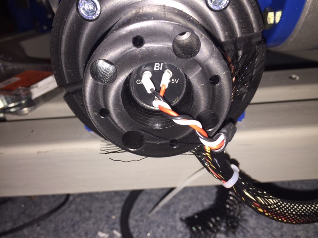

    At first, the Embedded HALL-Sensor end-switch for the servo lever. Just placed two neodymium magnets on the motor axis and used a HALL-Sensor for the detection.

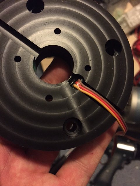

    The position Sensor is realized with an endless HALL-Effect Potemtiometer.

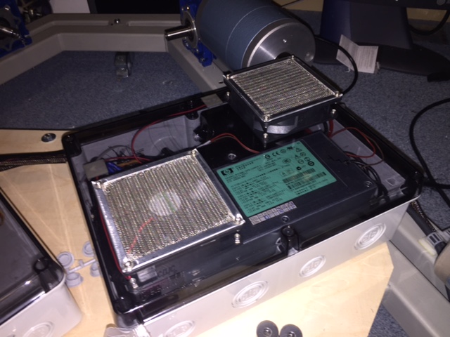

    For safety reason I add some fans (used cheap 12V fan) to guarantee proper airflow to prevent over heating.

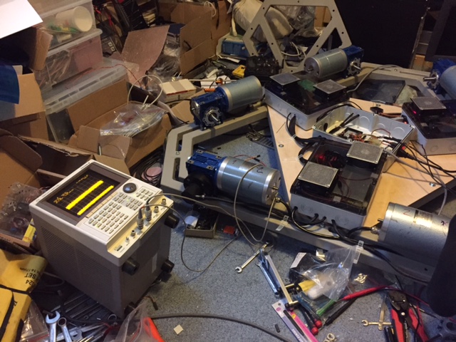

    All the electrical stuff is well assembled and everything is enclosed. So I guess next week I can start with first basic motion tests :)
    Some pictures will follow ...

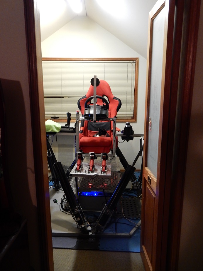

  9. SeatTime
    2,573
    I have a similar problem, but lucky to have the Wife agree to that :D.
    • Like Like x 8

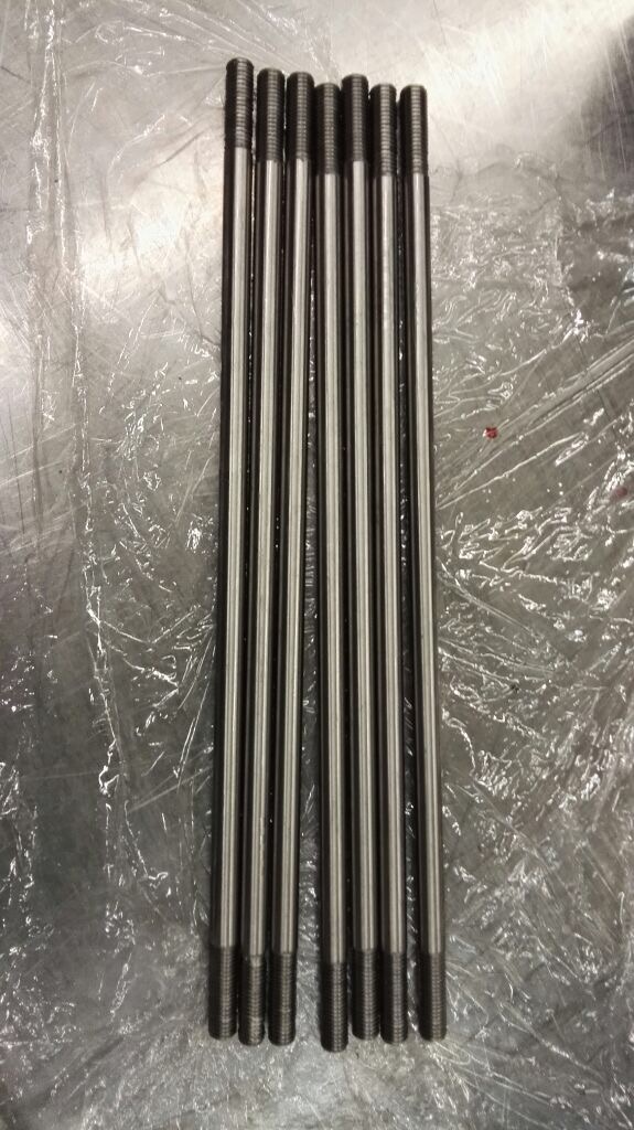

    I changed the length of the rods from 600mm to 400mm. I think this length fits better to the rest of the beast.
    One side has a left-handed thread the other side has a right-handed thread.
