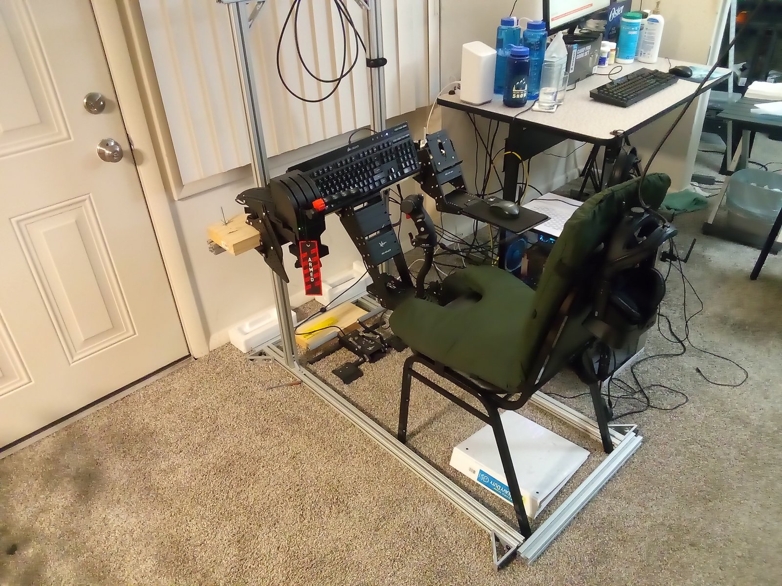

    Here is my current cockpit. It's very much a work a progress, but it's good enough to fly with. The frame is 1.5" extruded aluminum from 8020.net.

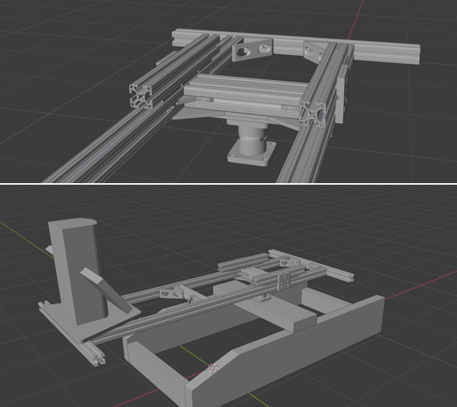

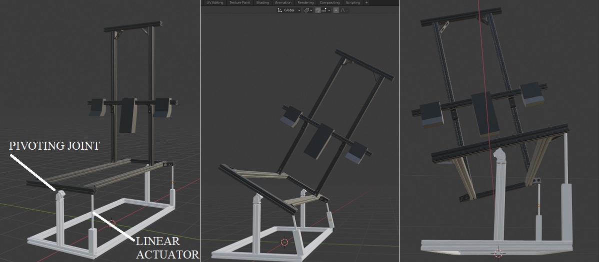

    And here's the notion I had, for a roll axis-only stopgap that I could build mostly out of leftover 8020 parts. I would only need to buy or make the actuators and motors, and the pivot joints. The dimensions need to be tweaked, and from what you said it sounds like I don't need that much actual range of motion, but you get the idea:
    It has the advantage of being cheap and quick, since I already have most of the materials, and I'd use actuators and motors that could be repurposed for the final hexapod platform. But I'm not sure those central pillars will bear the weight.

    If you are using 2 motors powerful enough to be repurposed for a hexapod you would get more value using a traditional 2DOF design, given your current rig perhaps a foot mount for the motors with a universal joint pivot under the seat. That way you get roll, pitch, sway, plus simulated surge and heave.

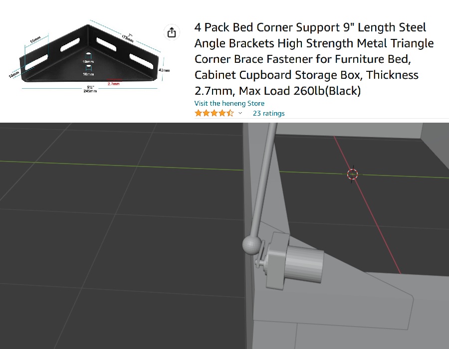

    Okay, I've added a new well-braced crossbeam to my cockpit to serve as the attachment point for a universal joint. Apologies for the crude mockup of the joint. :p Using extruded aluminum means I can slide it forward and back whenever tinkering with the cockpit changes the center of gravity, just by loosening some bolts on each side.
    I also designed a floor base, using 2x6 and 2x8 lumber to keep costs down. Is wood going to be strong enough? I have room to make it another foot wider if need be. It's designed with 15 degrees of rotation in mind--can I get by with less, and will I miss it if I do?
    Lengthwise I have plenty of room. Is there any other reason to choose a compact design over a shoulder mount?
    Since I don't have any motors or CTC levers yet, I'm not sure what inputs to use. How long should a CTC lever be? Is there an advantage to making it longer or shorter?
    In the help file it says you can improve pitch efficiency by changing the rest angle of the CTC lever to the proper position. What's the proper position?

    Wood can work, but consider carefully things like motor mounts having enough base so they don't twist, or compress wood.
    It is more important to have fast precise movement than large range, you can get away with less range, even more so if using VR, where having too much axis range just feels wrong.
    CTC depends a lot on the design and motors chosen, as it greatly affects torque. For a reasonably powerful compact design CTC is likely around 50mm, for a shoulder mount seat shaker 80-100mm.

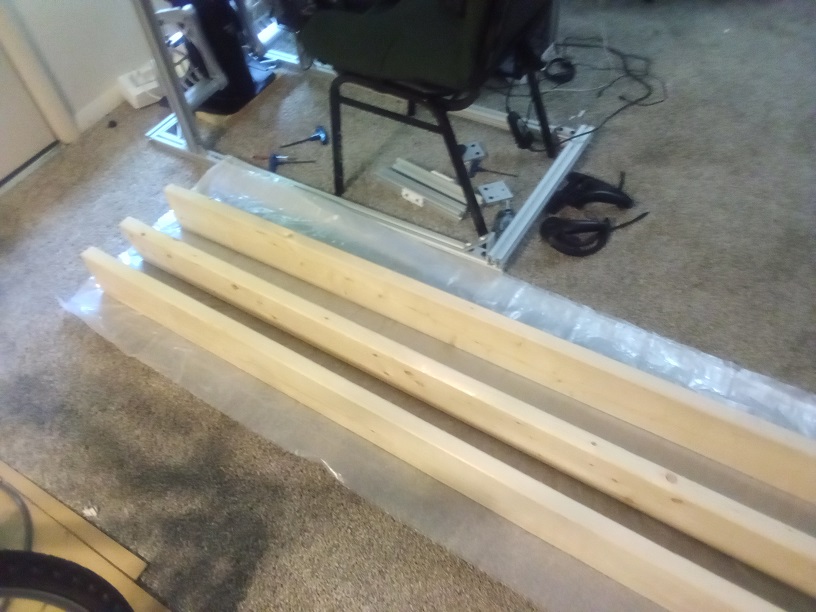

    I don't want to spend a whole lot of time or money on the base, since it's just going to be replaced when I move up to a hexapod. It only needs to last however long it takes me to afford the other four motors. Figure maybe a year or so. I can reuse the beams themselves for another project I have in mind later. Those corner braces too, come to think of it.

    I expect 8-10 degrees should be fine for a temporary 2DOF.
