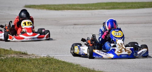

    In karting tucking your head on a long straight can help reduce drag. It kind of provides a DRS option to get a bit more speed. One option I am considering is a normally closed momentary button (like those found on car doors to control the dome lights) installed in the back of the seat so when you lean forward, the back is no longer pressing on it. Another option could be a proximity sensor somewhere near the steering wheel.

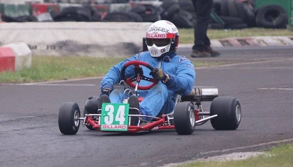

    The other sensor is to simulate riching up the air/fuel mixture into the carburetor. In karts, this is done by covering the air intake box with your right hand. I am thinking of a photoresistor inside a box with a hole so it can sense how much light is let through depending on how much the hand is covering the hole.
