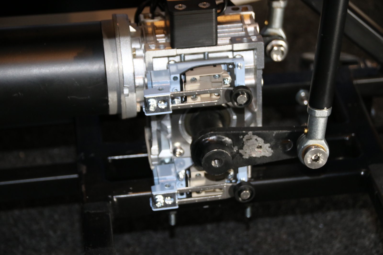

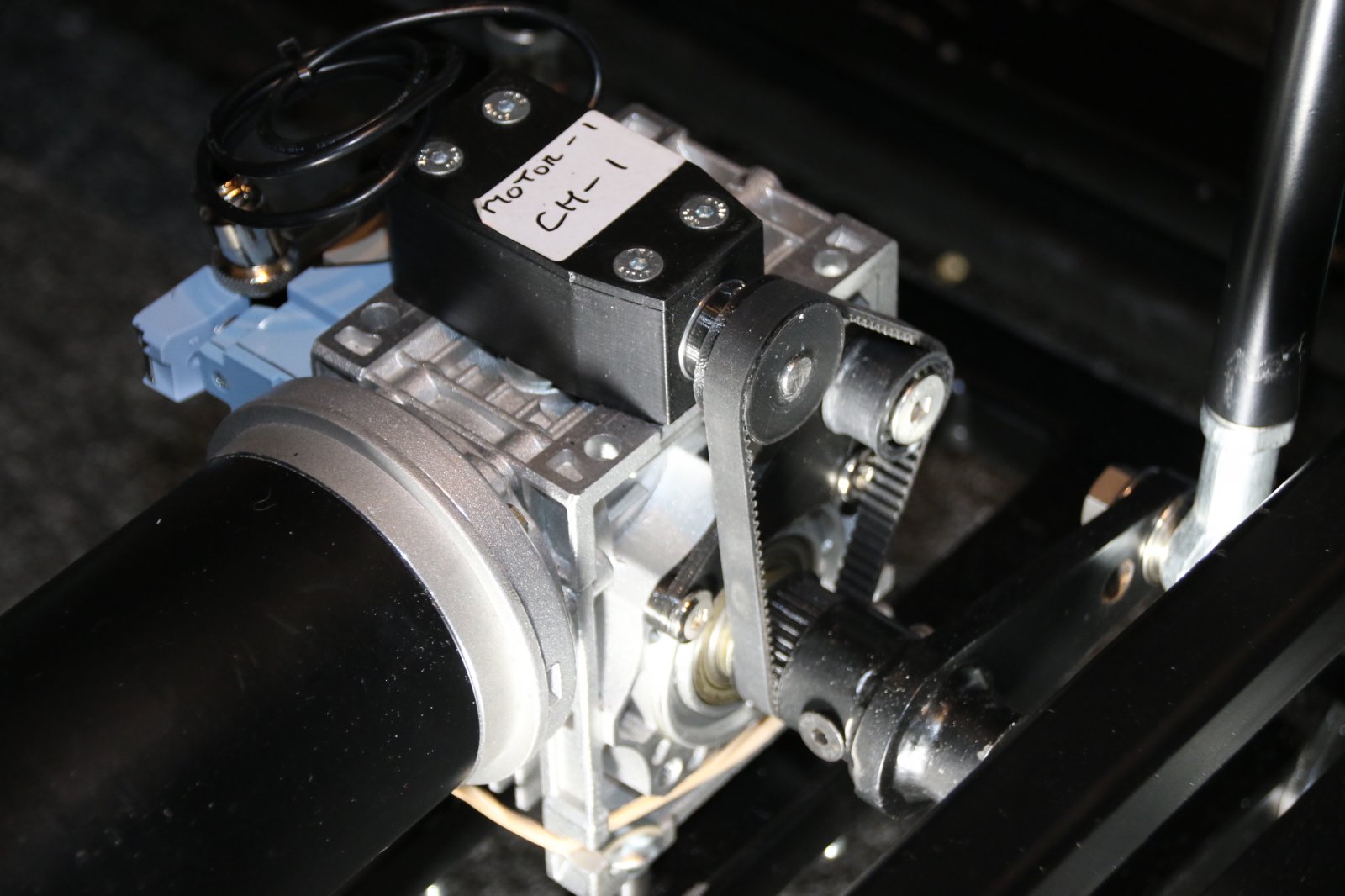

    what is your mechanical setup? some pics?

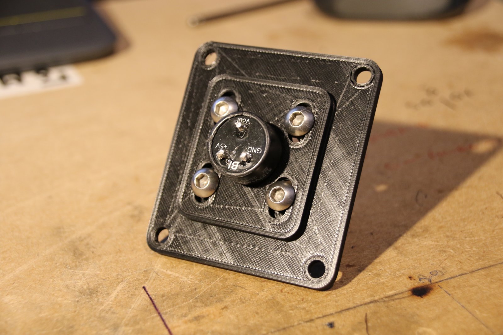

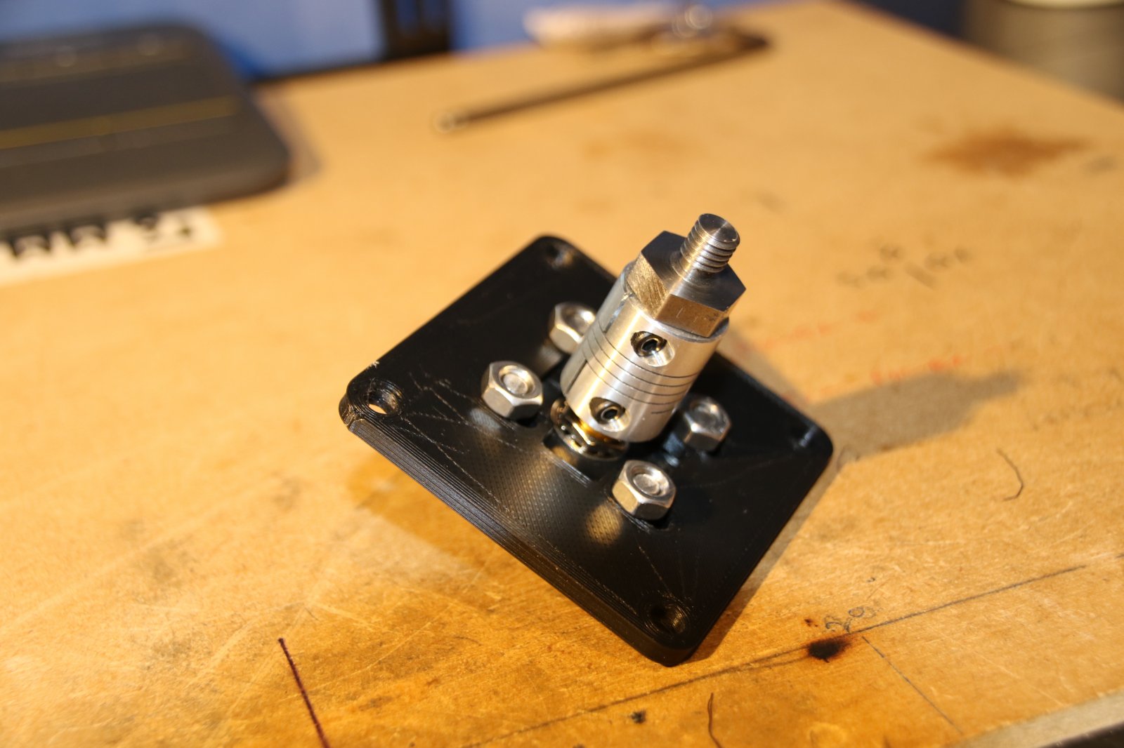

    I have also tried SMC again with problems, I think the root cause is in the design and implementation of the hall sensors, my first attempt was using a pully system this seemed ok but i am getting to many errors so I am in the process my hall sensor mounting to be driven direct from the motor.

    I think the root cause is in the design and implementation of the hall sensors, my first attempt was using a pully system this seemed ok but i am getting to many errors so I am in the process my hall sensor mounting to be driven direct from the motor, at this point to rewire my simulator to make this work.

    Oh ok. I have never used my motors in the DE software, to be honest I didn't know you could haha. I have had very similar problems to yours where a motor will oscillate when going one direction but move smooth the other direction. This was only prevalent in one motor for me and occurred after using the simulator for about a minute. The baud rate setting has been known to cause these really weird issues.
    I have my sensor direct driven, but I would experiment with the baud rate because your design could be fine. Try changing it to 115200 on the game engine and the Arduino code. Some off-brand Arduinos like the one I have cant handle 500000.
