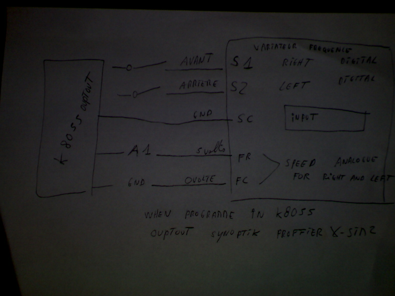

    DSC00147.JPG bonjour je suis francais j ai realiser un motion 2 dof ac electrique avec variateur de freqence voir
    http://flightmotion89.canalblog.com
    sortie k8055 digital pour left et right
    marche avant right digital ouptut 1 connecter sur s1 entree multifonction ok
    marche arrierre left digital ouptut 2 connecter sur s2 entree multifonction ok
    gnd velleman sur sc commun d entree de sequence ok
    sorti k 8055 analogique pour speed analogue output 1
    5 voltes sur FR entree de reference de freqence analogique ok
    0 voltes sur FC gnd de reference de freqence ok
    ma question
    its possible use x-sim2 soft in profiler for variation speed in 0 a 5 voltes in my variteur de freqence for the speed analogue+digital output let and right ?
    the variateur de freqence is not possible use the pwm speed and direction.

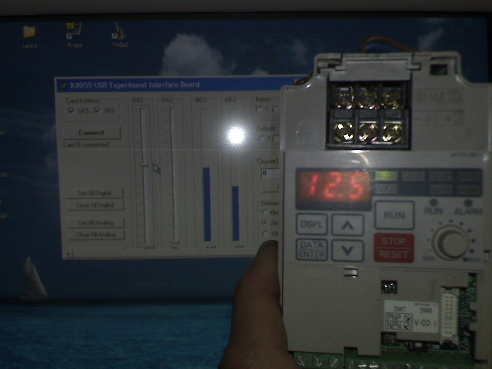

    DSC00149.JPG i am not use the 0 a 10 voltes
    i am use to 0 a 5 voltes the variateur is reglable in interne the freqence
    reglage normali the variateur is 0 a 200 % is very dangerous
    i have bloquer the variateur a 20 % the capacitei in 5 volte maxi is security is good mouvement programation interne variateur programme n46
    my reglage speed is to 0 a 5 voltes de 0 % speed a 20 % suffit amplement for my configuration is good for my simulator the reglage
    its ok
    my probleme is reglage synotik ouptut
    look attachement

    Hi scott,
    it is quite a bit of a challange to understand you. But here is what I have concluded so far.
    The motor driver is not your problem.
    Your motor driver accepts 0-10V analog speed input, and S1 and S2 trigger the motor turn direction.
    As far as I understood you are not getting analog speed signal from Profiler via the K8055 yet.
    I am not sure if A1 on your drawing means DAC. Because A1 and A2 are analog inputs!
    You have to use DAC1 and DAC2 outputs for analog 0-5V speed output to the omron-V7 motor driver!
    If you have connected it right, then you have to deal with the XSim2 Force-Profiler to output analog data to the K8055.
    I am not sure how far the analog/proportional output in XSim2 for the K8055 is, and how it can be activated. Sirnoname should be able to enlighten the issue better.
    Regards
    Christian

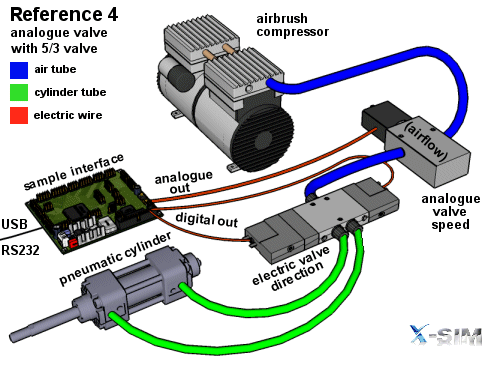

    GOOD MORNING my simulator and to connect up there taken out from velleman digital 1 and 3 on S1 left and right 1 and S2 who orders the direction of motors in axle x and the similar for the driving deuxieme for l centers there therefore two motor
    that I would like c the speed in taken out analogical of the velleman on l entree analogical of my dimmer in 0 - 5 circles is to order
    as on l example of the photograph which as an electrovanne and a debitmetre electronique 0 a 5 voltes
    exemple electric valve direction digital out velleman 1 et 3 (ok) = for me S 1 et S2 variateur ( ok ) for direction right and left axe x
    air flow analogique valve analogue out velleman 0 a 5 voltes for speed (ok) = for me input analogue 0 a 5 voltes variateur ( ? )
    I want to know how to make in the matrix of x-sim2 for gerer analogue valve speed in 0 has 5 voltes pneumaticscreen4.gif

    in the matrix everything is definitely to regler but when I turn has left ca augment the speed and have right its fall the speed to light start my probleme ca I do not see commaent he regle the speed of the valve you screen
    the out analogue the valve is speed no direction in the screen (yes no )
    electrovannr right and left direction ok
