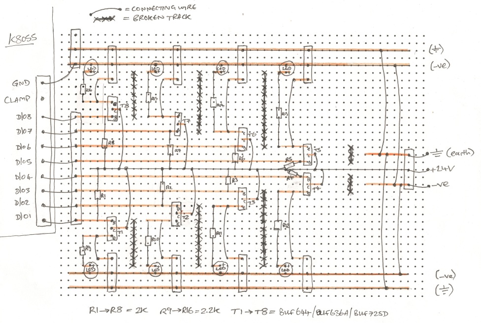

    As I will be working with many different pneumatic valve configurations, I have designed this transistor array as a convenience - the terminal blocks are much easier to manipulate than soldered wires!
    For those that followed the K8055 - Dual wiper motors... thread, the way that this board works will hold no suprises!
    For everyone else, here is a video explaining it at a very high level
    http://www.youtube.com/watch?v=ogUamuON2FY
    oops - I said relays at 1:28... meant transistors! :blush:
    I will draw up a circuit diagram for this later on in the week
    (I will be back in Amsterdam with work until the end of September, so should have some time to kill in the evenings).
    Unlike the relay circuit which already existed, I am proud to be able to claim 100% originality on this configuration and circuit design... yes, it is a simple enough circuit, but it is super cheap to build, very effectively controls all 8 outputs, and is very convenient when changing setup configurations.
    I have a design also for a circuit to incorporate PWM / Dynamic Voltage, which will be necessary for proportional valves; I will build and test that later, and share the design when I am satisfied with its performance... for now, this board is specifically designed to support experimentation with valve configurations and improved pulse routines (if improvement is possible).

    As promised, here is the circuit layout for my K8055/Pneumatic Valve test board
    Apologies that this is hand drawn - will replace as soon as I can with a digital version...
    this was drawn on the plane on my way home!
    The component view is from the top, with important tracks highlighted in colour.
    Component numbers and values in the top and bottom margins.
    Regards
    Tim

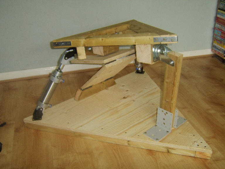

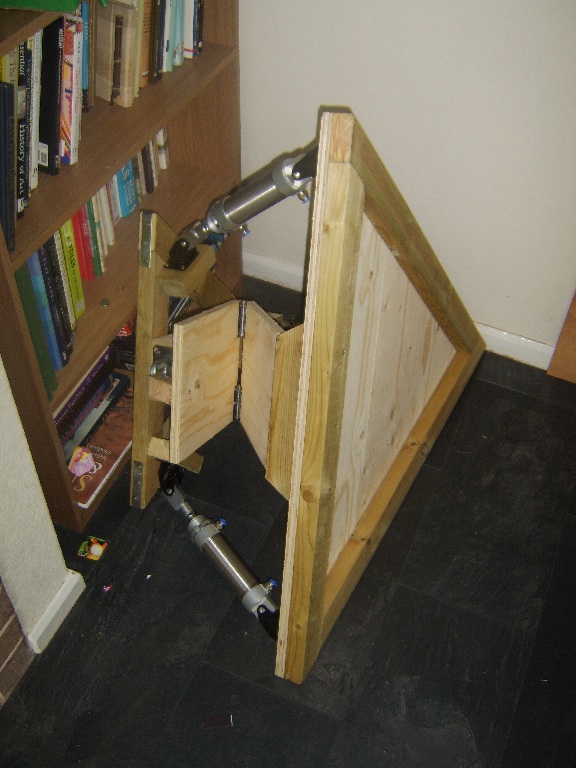

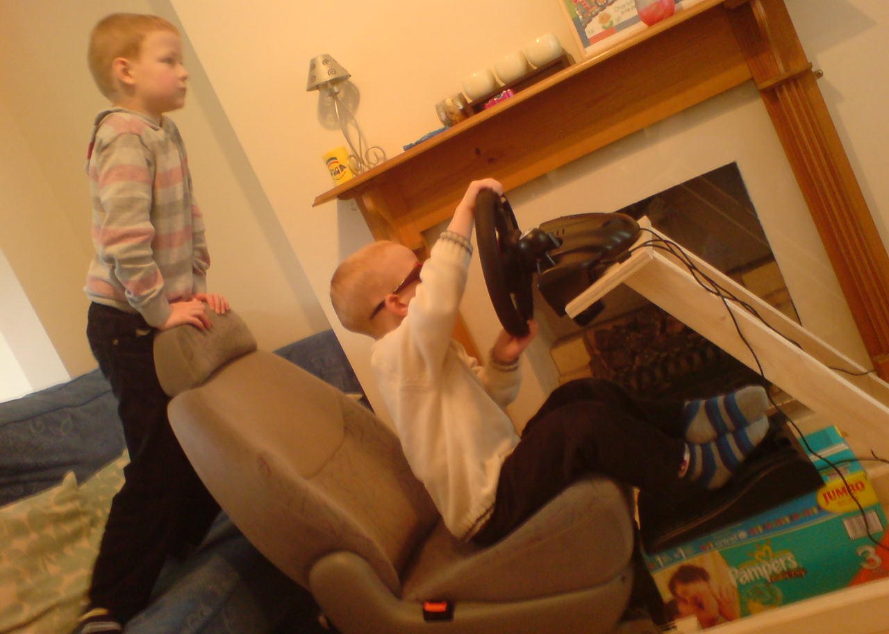

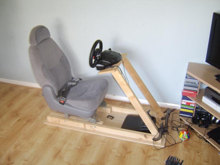

    Test rig
    Hi to all!
    Here are some pictures of my test rig. It is simple enough, but if anyone has any questions regarding the design, I would be happy to explain
    The platform itself is sitting angled down in the pictures - this is because it is designed to be level with the pneumatic rams in the centre position.
    The back leg will eventually be replaced by another cylinder, hence the spare space behind it. (I have a cunning plan on how to control that ;) )
    The frame articulation is made possible by the use of castor housings (just with the wheel taken out). 4 small ones for the pneumatic cylinders, and 2 large ones to control the central axis around which the platform rotates.
    The platform is able to move up and down, and rotate around the central axis (imagine this axis being front to back between the centres of the 2 silver castor housings) but cannot move from side to side; I must admit to being a little suprised at how incredibly stable the platform is - before I added the hinged section in the middle, the top was flopping around all over the place... with the hinges screwed down, I genuinely cannot move it from side to side!
    Making a frame that could be easily packed away was very important, as I dont have too much space, so here is a pic of the frame in its normal storage position... not too offensive - even for my wife!!
    For testing under load, I will simply strap the kids static frame onto it for now - complete with the spare car seat from my VW Sharan:
    well... OK - I made it for me, and it's a bit big for the kids, but they insisted and now won't leave it alone!! - heres a pic of my youngest son clearing the nurburg ring in an M3 in under 8mins... at 4 years old!... with a box under the pedals as he couldnt reach them!! - go-karting lessons all round I think...
    The final build? who knows... it is likely to be similar to the fourstar f1 simulator (http://www.youtube.com/watch?v=qIe9O529MR0) - I figure why not? everyone has seen it and drooled... we may as well try to get as close as possible!!
    It's a shame I didnt get more time this weekend to actually connect the frame up to the air, but at least now that I have the control board and frame prepared, it's something I can get straight on with when I finally get home!
    Tim
