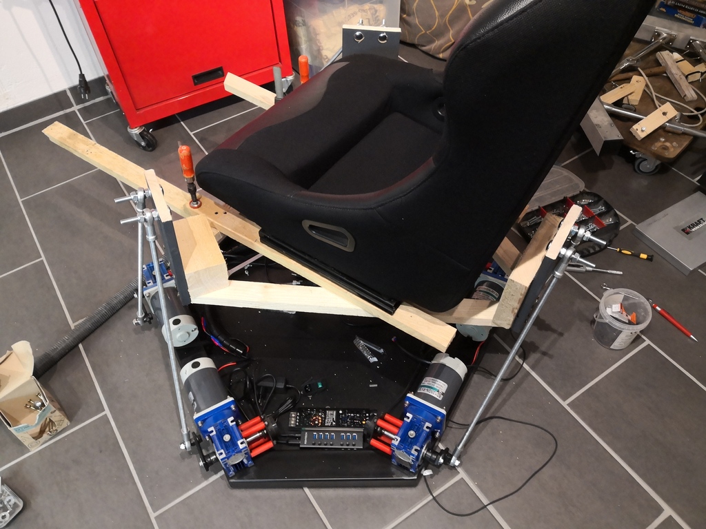

    small update :) Frame-part now painted black and wooden bottom installed + all motors attached.
    seat placed only for size comparison :)
    [​IMG] [​IMG]
    next step: welding the lever arms for the motors. attach it and make a wooden mockup frame for the seat.
    then do a small game test and if it works i will order the steel square tubes and put all electronic stuff onto the wooden floor.

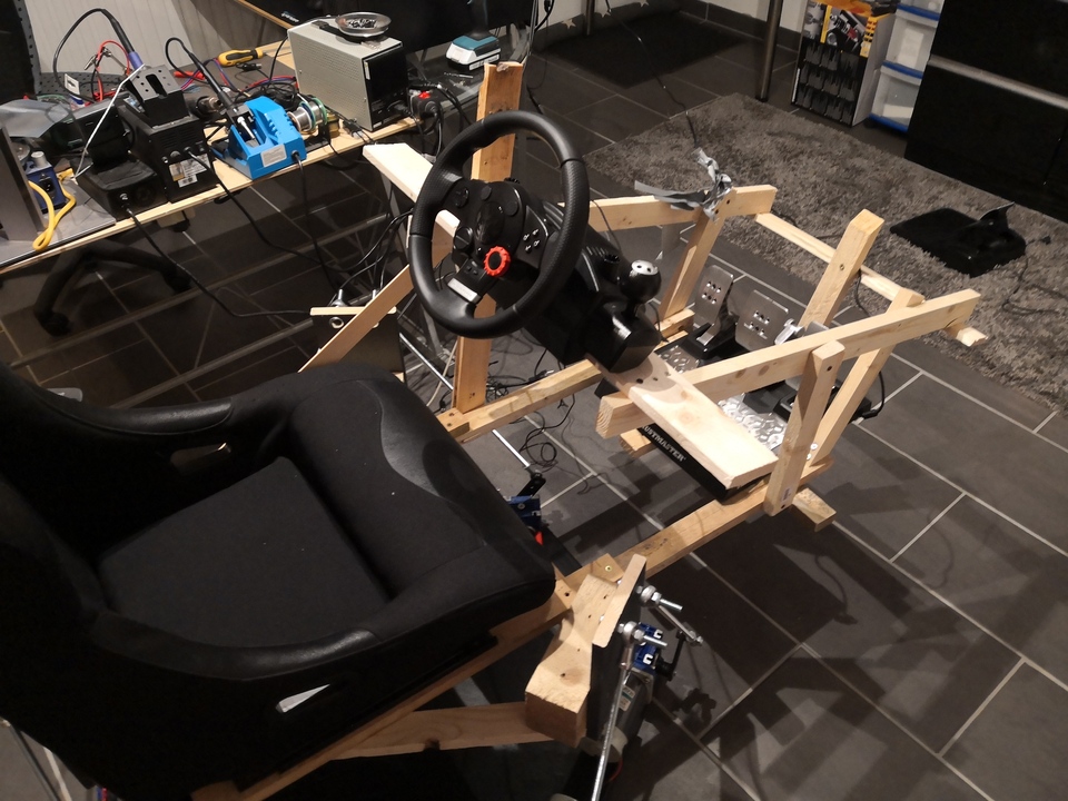

    Update, just hammered a wooden frame together for testing (and yeah it works - it holds also my weight :D )
    [​IMG] [​IMG] [​IMG]
    now, testing the movements and if the rods are not colide with any other parts ..if yes i have to alter the angles of the upper frame a bit. if its all final i order the steel square tubes to make it right

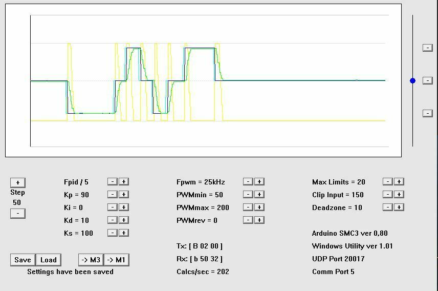

    i have a question. i have everytime movements in the motors - even the rig stands still .... that causes motor noises and heat. i set already the dead zone to 10. this helps a bit [​IMG]
    these are my actual settings .... maybe someone has a tweak ? why does the motor wants to correct something ?
    i got hall sensors on all 6 motors and the mechanical gap is minimal maybe too much cable connections and stuff ? there are many connections and plugs ( i want to remove as much as possible of these with direct wirings )

    set pwmmin to Zero
    pwmmax to 255
    set fpid to 1
    set ks to zero
    set kp to zero
    use the sine wave and slowly increase kp till it moves correctly

    Hi Gadget, thanks for the hint! i will try it later ;D great community here !!!

    Current state. Wood frame, Just for measurements and testing. Quick and dirty works well so far. My New moza r9 wheelbase will arrive tomorrow. [​IMG] [​IMG]

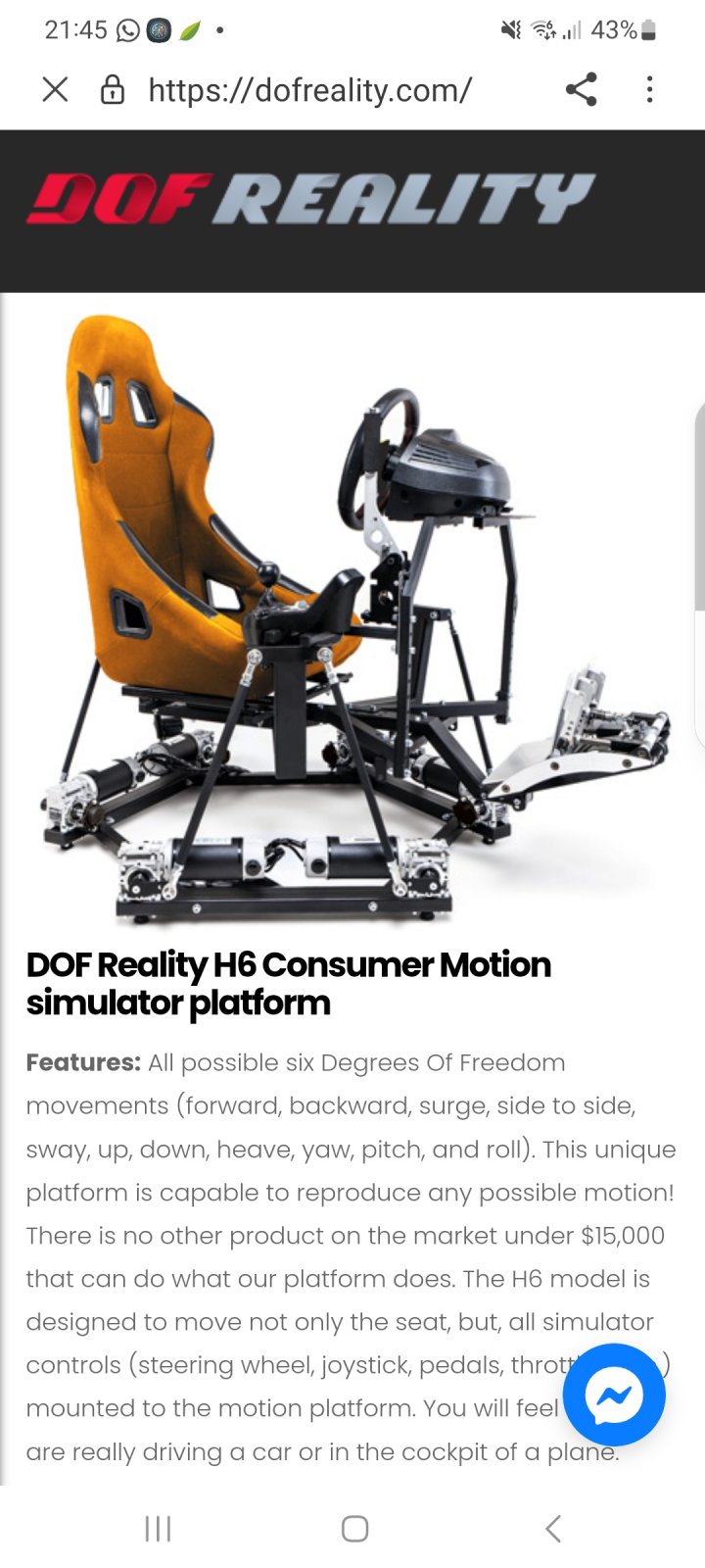

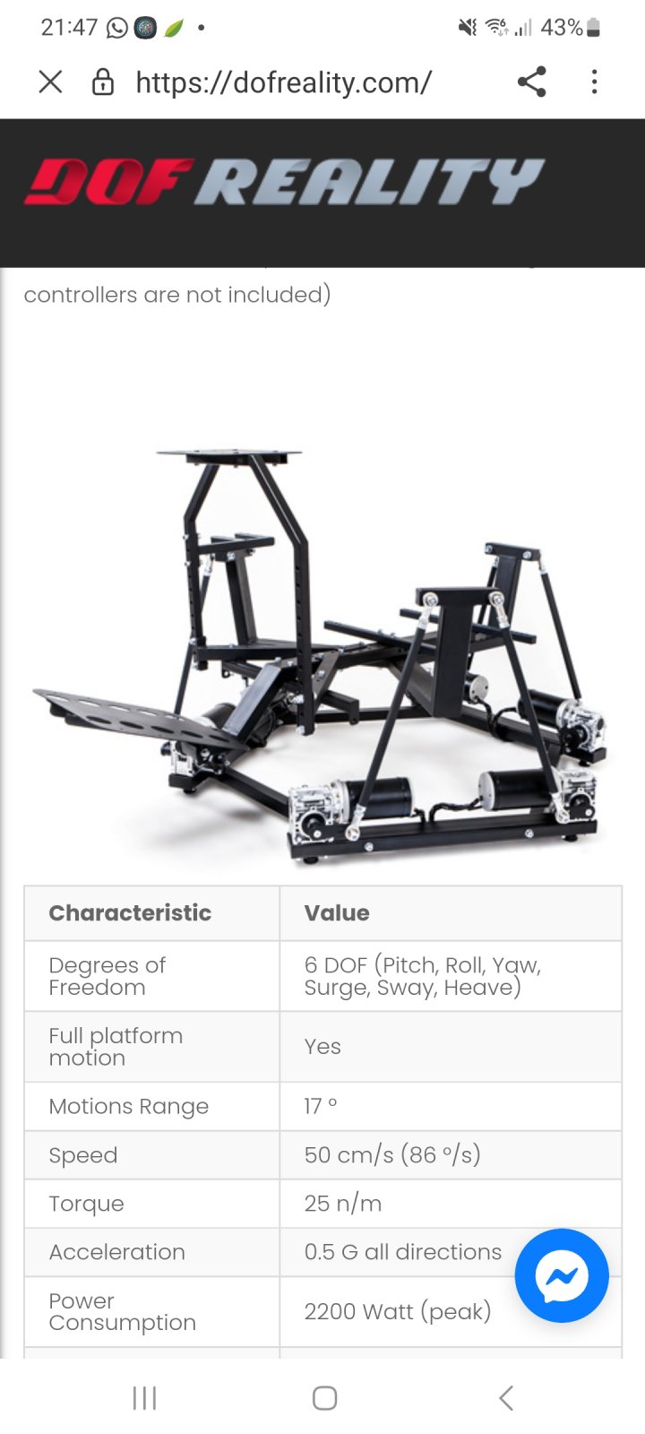

    Looking really good. I am just starting to collect together all the kit ready to start my first 6dof rig. I had in mind a very similar design to you. I was taken with the design on the dof reality H6. It is almost identical to your build. It might be helpful

    yes thats true, i wanted a really compact one. but sturdy, thats why i do the main frames in welded steel- not bolted and the front in light weight aluminum . the dofreality looks very wobbly
