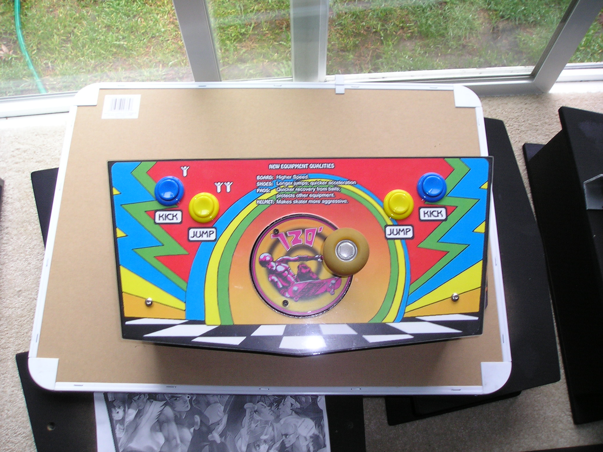

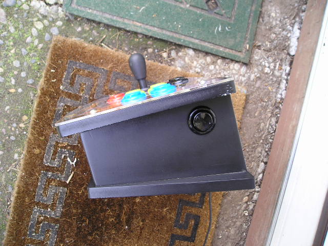

    Just thought I’d post a picture of my 720 stick I completed a few days ago. :yippiee:
    It’s a perfect replica of the original joystick with Delrina on Steal providing the friction rather that a stupid chain system found on the original.
    (Yes I have a 720 in my garage – lol)
    I removed the disk encoder boards from my original arcade stick and scanned them to my PC. After a few touchups, I made a PDF of the scan, and re-made the encoder boards out of PCB board. (Just like you would a circuit board) – lol worked perfect! And I can adjust tension on the stick to whatever I feel like at the time – lol.
    I have to set up 720 in mame as if it’s using a real arcade stick – lol
    I could even attach it to the real standup arcade machine If I wanted too.
    Now to put my 720 back together and sell it – lol
    Anyway, thanks for the look!

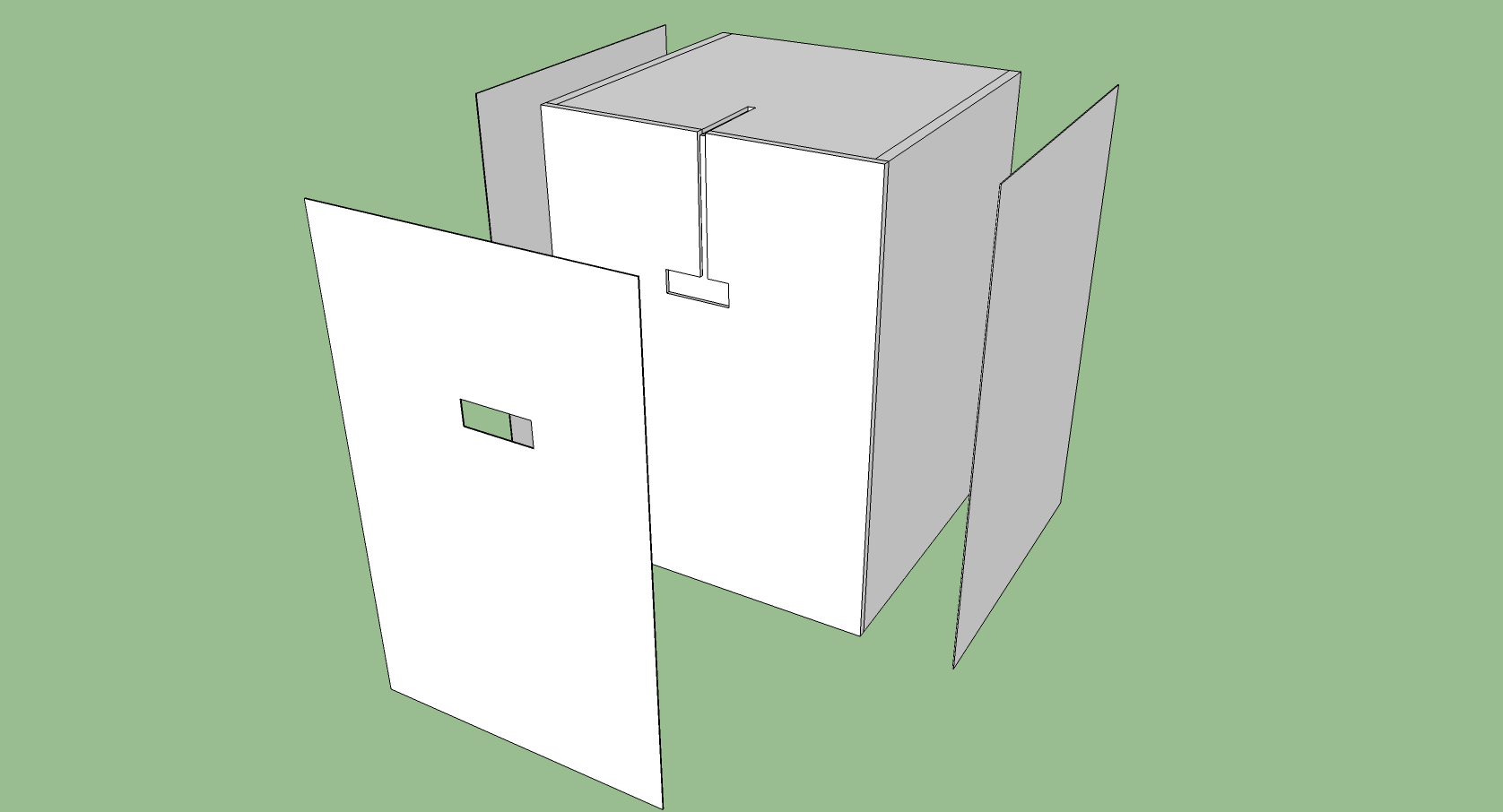

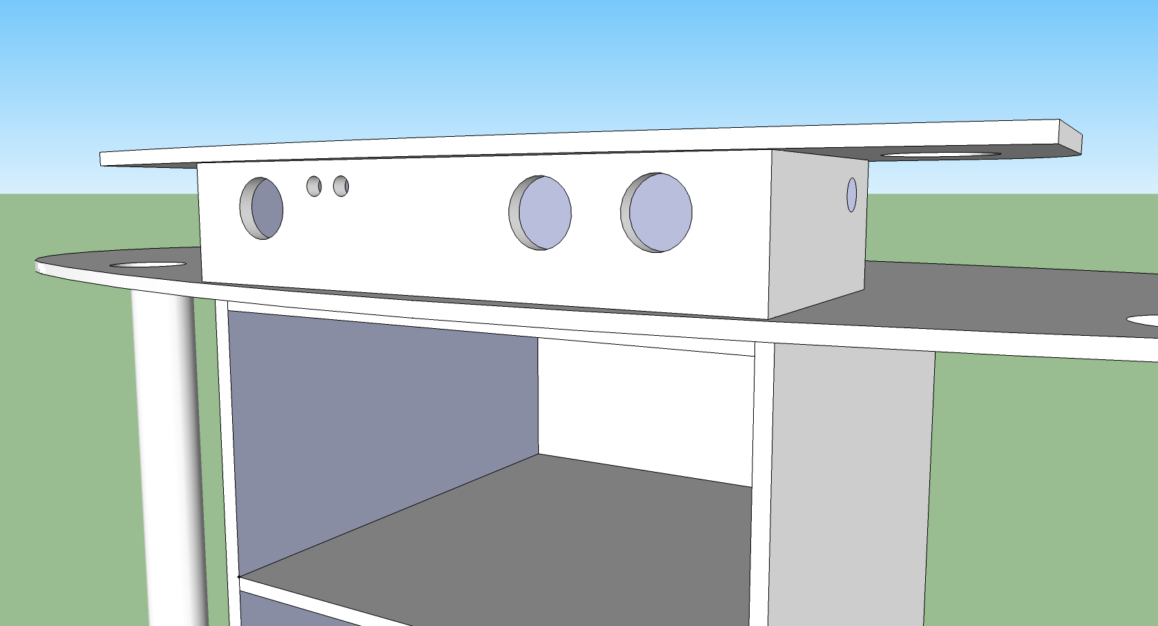

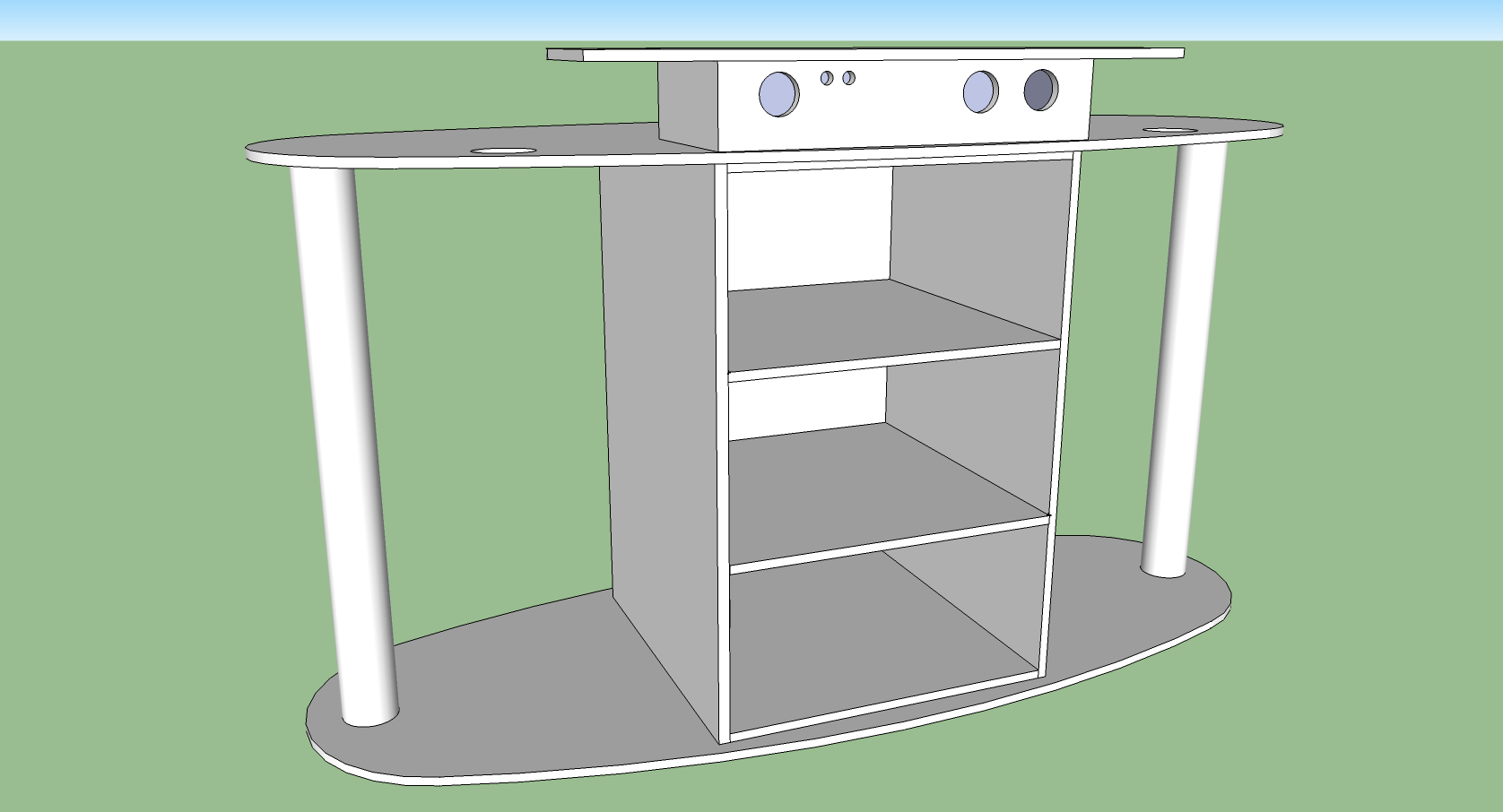

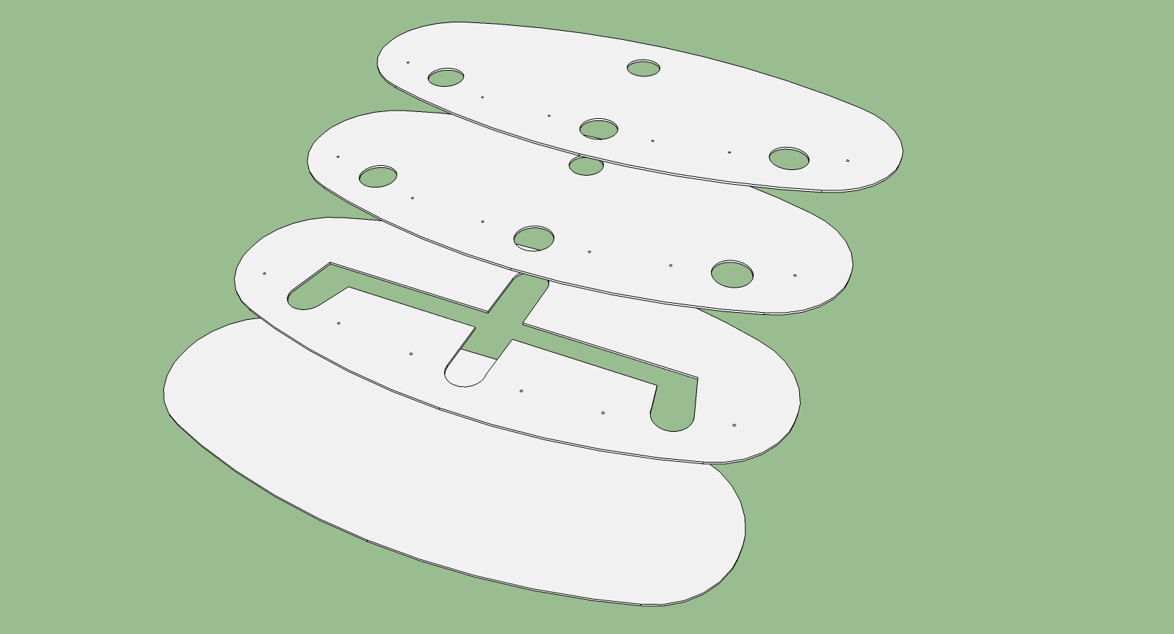

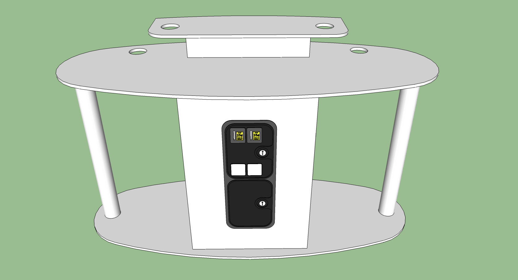

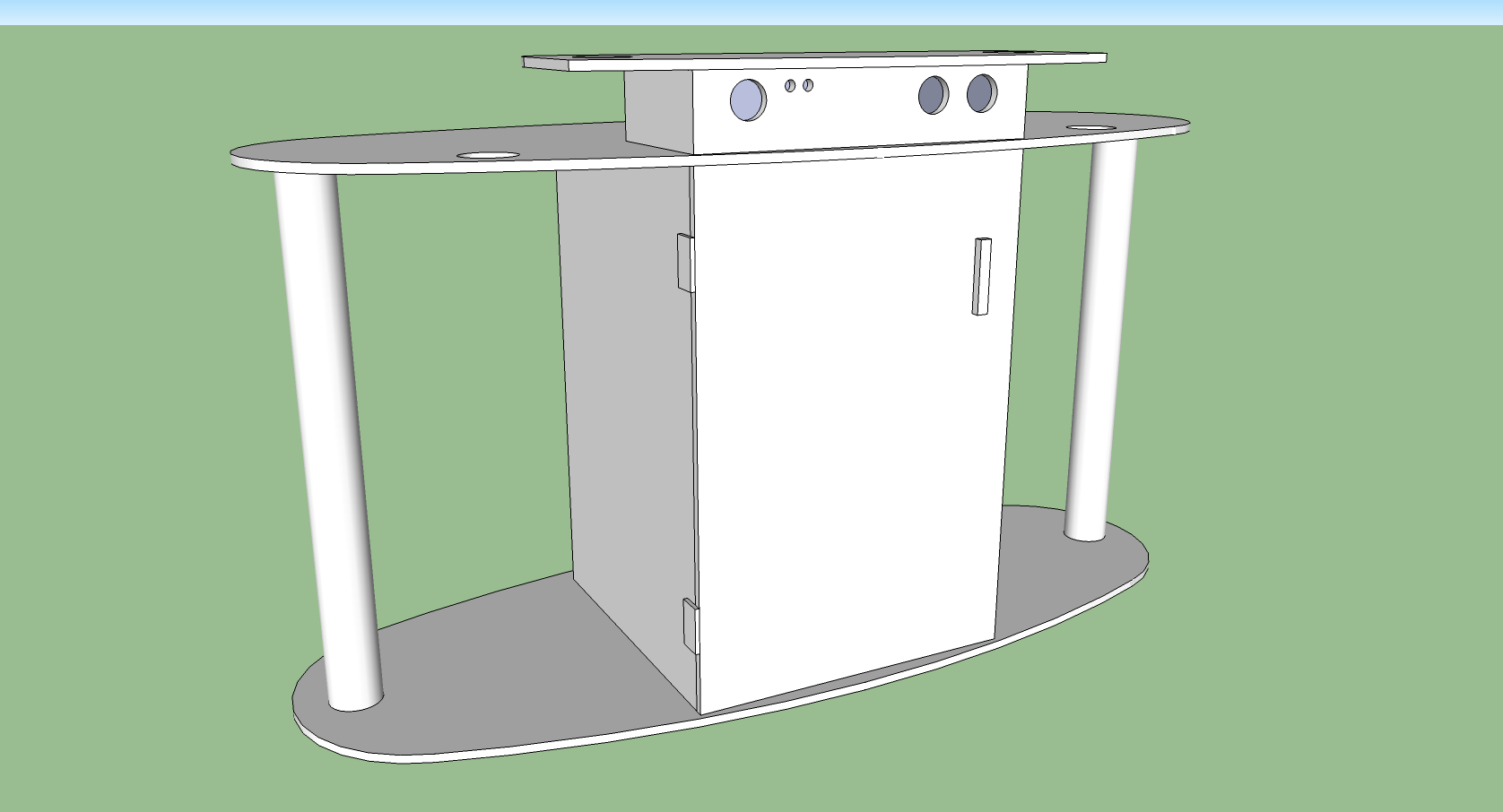

    Hi Fellas,
    Because I wanted a cab I could add on to later without needing a cluttered control panel.
    I decided to build a mini bar that will act as the cab and will also hold 3 one player joysticks.
    The 720 stick above is just one of the sticks planed.
    The joysticks will be connected by ribbon cable to the top of the cab and will be able to be easily swapped out.
    here are some pic's of the idea
    ribbon cable inlayed in the top of the cab
    Constructed pic
    Mini ITX pc housing
    joystick storage
    with door on
    8 way sticks (gave away for x-mas)
    pinball
    I'm in no rush to get this done - it's the project I work on when I have nothing to work on lol.
    So I can connect all joysticks under the sun I have collected
    1 A-Pac (Star Wars / joysticks)
    http://www.ultimarc.com/a-pac.html
    1 Opti-Pack (trackball controller / 720)
    http://www.ultimarc.com/optipac1.html
    1 Rotary Joystick Interface (ikari warrior sticks)
    http://www.ultimarc.com/rotary.html
    with all 3 of these connected to a 50 pin ribbon cable, it's then only a matter of connecting the right pins to each device for any joystick I build.

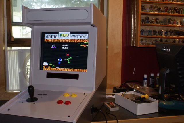

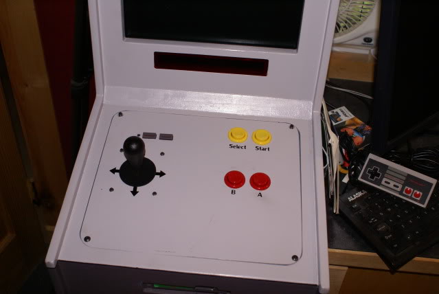

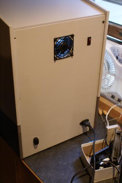

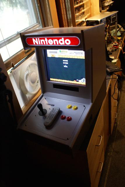

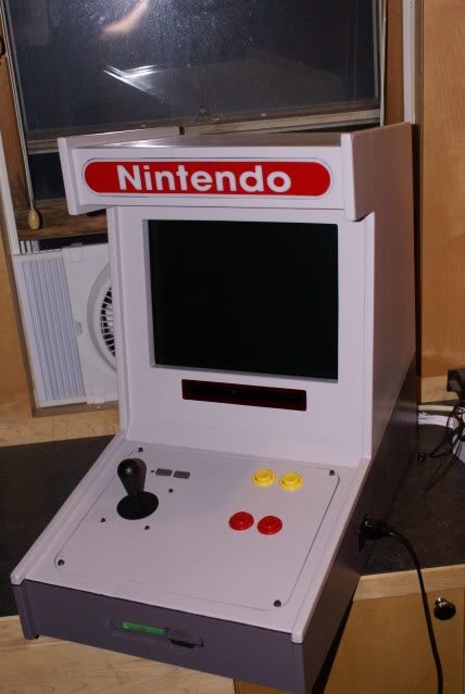

    These things are fun to build. I hope you do not mind if I share this in your thread.
    I built this a few years ago for a customer, he wanted a bartop cabinet for his Nintendo collection.
