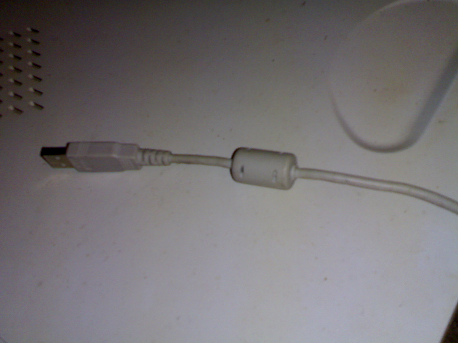

    Hi I have 3 usb cables:
    first : 140 cm
    second : 100 cm
    third : 100 cm
    Sorry for ignorance but.. how can I know if a USB cable is active? My 3 usb cables are normal usb cables I think..

    This happened to me periodically with one of my units up until a week ago. I replaced the internal usb cable(between the jrk and usb hub) with a shorter one and rerouted the power cables so that they were running farther away from the USB cables, and it's been perfect ever since.

    That is correct. I should also mention that I did lose contact with it before I installed the hub as well, when the JRK was connected directly to the PC.
    By rerouting the power cables I mean that I moved the high power cables for the JRK farther away from the USB cable, so that there is less chance of electrical interference.

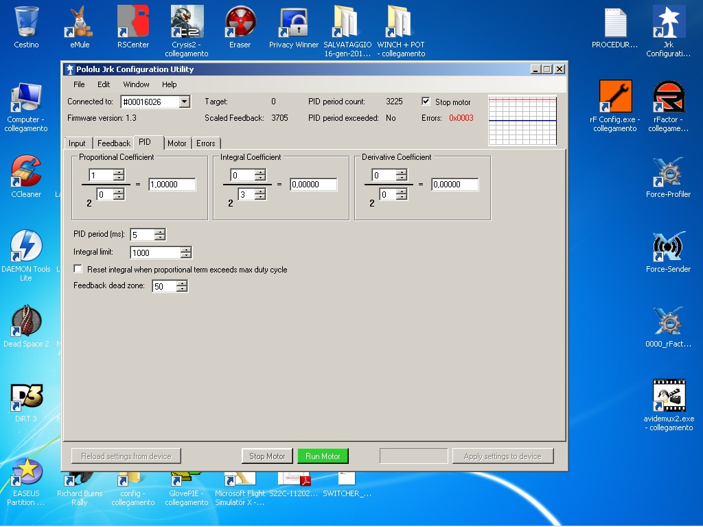

    Mmmm please look at this pic!:
    As you can see my PID period is a damn little 5ms!.. can be this the main problem here? and my PID propotional/integral and derivative settings are accetable? I never touched it from the start of my project to now..

    as bsft recommended, plus ya not really using the pid to its full potential one settings for pid i have used is 7/2,0/3,5/1.
    Having not real pid setting might be causing issues and sorry never picked it up in any of your earlier post on the jrks.
    Another that work nicely from memory was 2/2, 0/3, 1/1.

    Yes Aldoz, you have not touched the PID settings, try the generic of 2/2 0/3 1/1. I found p numbers help speed and twitchiness. Work them both at the same time, leave i ,and d controls overshoot of motors (motor driver error). A tricky one, but work the numbers both at the same time up and down, that and you may have to re-work profiles.
    My current PID is 4/5 0/3 8/8. If I lower d to say 6/6 or 4/4, by golly does the motion kick hard! Same with p, if I reduce lower number, it gets real nasty. I am still fiddling with PID on mine, every motor is different, so have a play with the numbers and see how you go.
