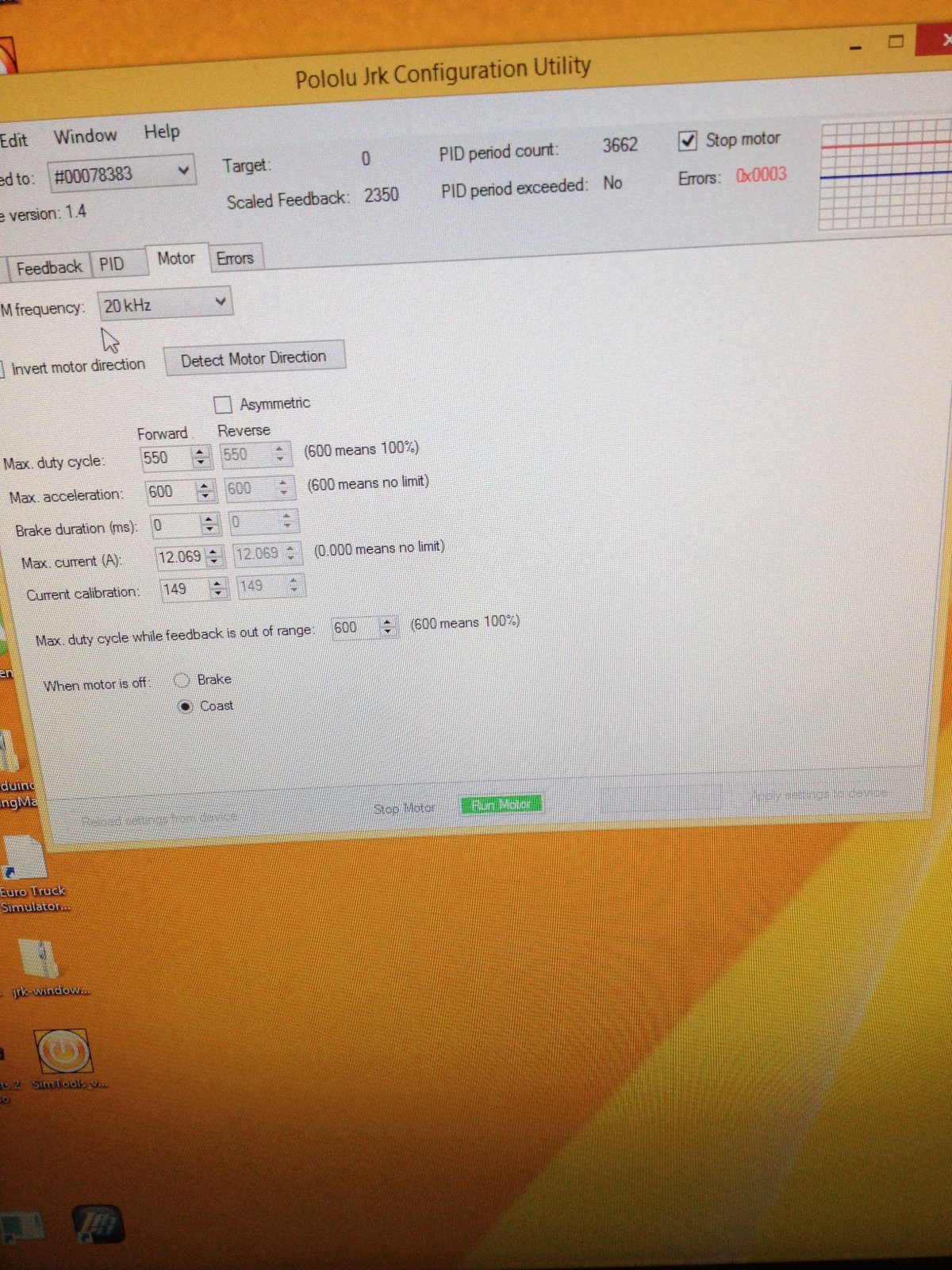

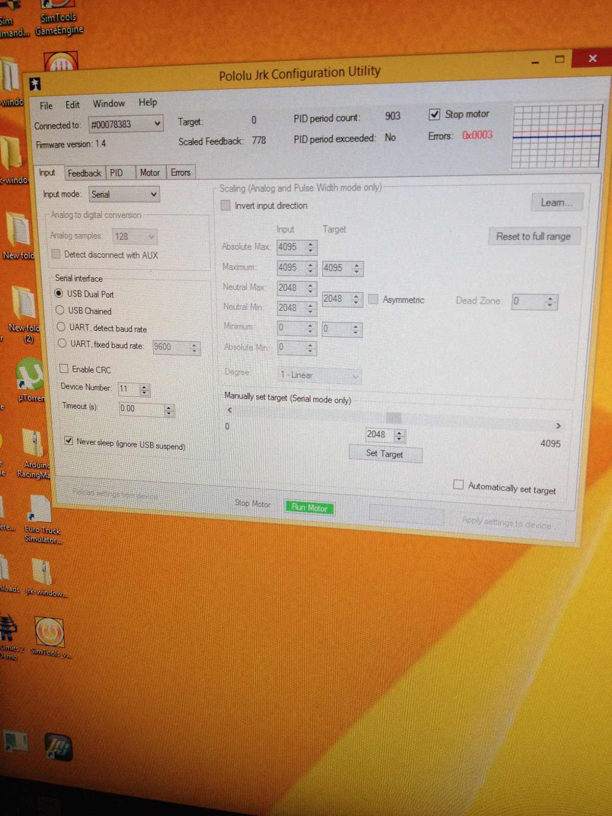

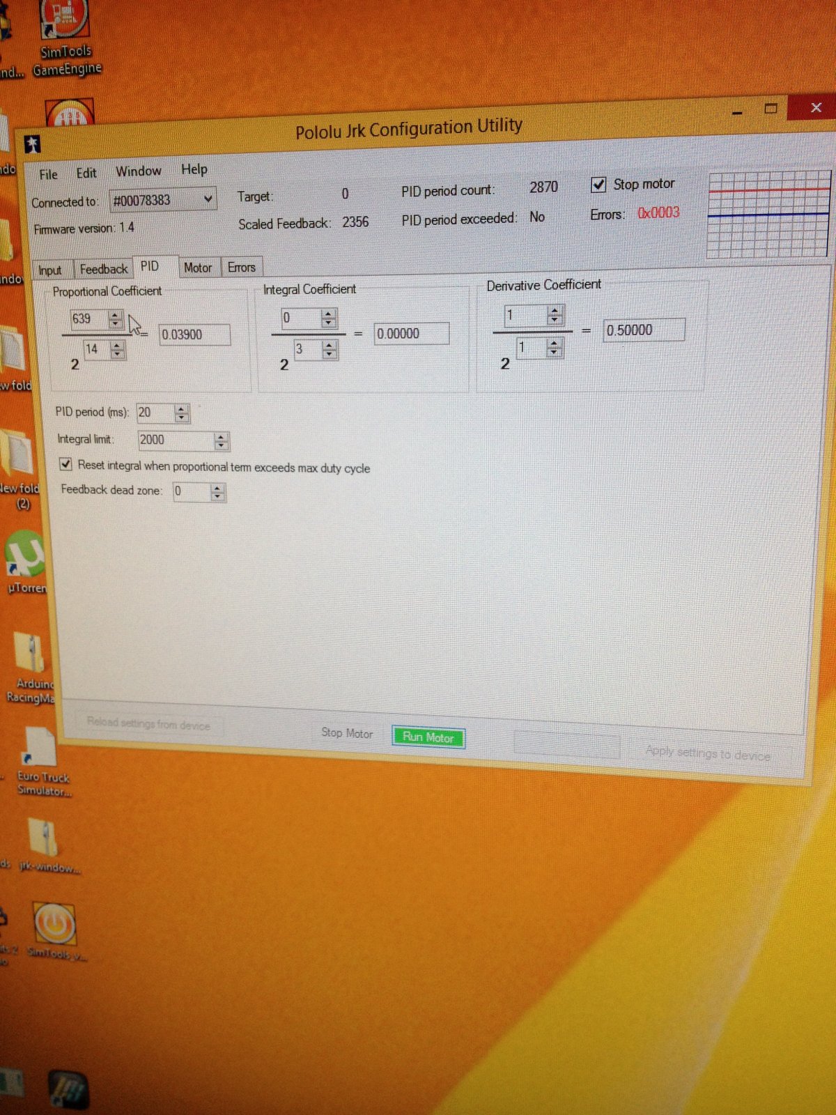

  9. scalhoun
    scalhoun Active Member
    Jun 20, 2014
    125
    Software Engineer
    Pennsylvania
    968Coins
    +136 / 1 / -0
    Should be all the settings. Wasn't sure if I should lower the max current value or anything else to keep it from tipping the power supply.
  10. bsft
    Max current is to stop jrk from sending too much current to motors, but set it t 0 (unlimited). The motors will only drain what they need.
    P in PID is low at 0.039, whack it up to 0.4
    Max duty cycle try at 400.
    MAx accell 400.
    Current calibration try at 130.
    See how that goes.

  12. bsft
    thats good, I also just noticed something else, bring the integral limit up from 2000 to 5000, or even 10000. That may reduce problems more as well.

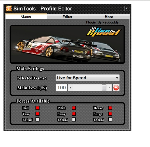

  13. Nick Moxley
    17,056Coins
    +2,506 / 30 / -2
    Umm, Try NOT running the Game profiler at 100%. You mention 575w PSU's so you have the Same as i do, 600-pb's and Ive pretty much figured out the Crashing issue ive had and is has to do with running your profile at 100%.....>knock it down to 97% and If you dont have any PSU Shut down's or even should i say, Motion Disconnects and when you exit the track Simtools Crashes.

    Thanks for the tip @Nick Moxley.
    I assume this is the setting you are referring too?
    Once again thanks everyone, your help has been amazing.
  15. Nick Moxley
    17,056Coins
    +2,506 / 30 / -2
    Correct, Just keep it off 99 or 100% I had One shut don on 98% but couldn't duplicate it after it happened, To be safe start at 95 and work up to 98

  16. scalhoun
    Jun 20, 2014
    125
    Software Engineer
    Pennsylvania
    968Coins
    +136 / 1 / -0
    So far he 98% trick and integral at 5k seems to be a success. I haven't tripped a power supply since those changes where made. :)
