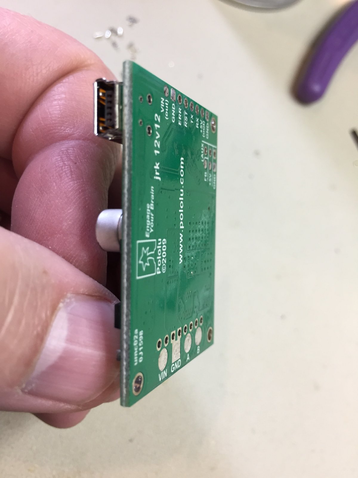

    Yep - the JRK 12v12 uses the ST VNH2SP30 H-bridge which has an internal thermal cutout/shutdown. You want to minimize how often that activates because it is stressing the chip circuits to get that hot.
    There's some more info in this thread but not a huge amount. (https://www.xsimulator.net/community/threads/jrk-12v12-overheating.10327/#post-133655)
    The JRKs bond the thermal pads on the chip to the bottom layer of copper on the board and the max current that the JRKs can handle is a function of the board copper area and how much heat that can dissipate. You can really increase the current handling if you heat sink the bottom of the board. Most heat sink the top of the chip but that doesn't cool all the heat generating parts and the plastic of the bridge has fair heat conductivity but only about a quarter of what the thermal pads do to the bottom copper. The bridge chip has an internal current limit that activates around 50 amperes or so. The JRK is only rated at 12 A continuous so if you heat sink the board, you can pick up a lot of headroom but I don't know just how high you can go.
    If you heat sink the bottom of the board, get some thermal pad material with high thermal conductivity and isn't more than a mm or thereabouts thick. You want to clamp or use mounting screws to get good contact across the bottom of the board and you need to be careful not to over tighten since there are only three screw holes to mount with due to the USB connector. Using thermal pad like that on the bottom of the board also means nothing can stick down and pierce the pad to short out against the heat sink. You probably will need to clip and smooth the feedback and power/motor connector pins to have those connections be flush with the bottom of the board.

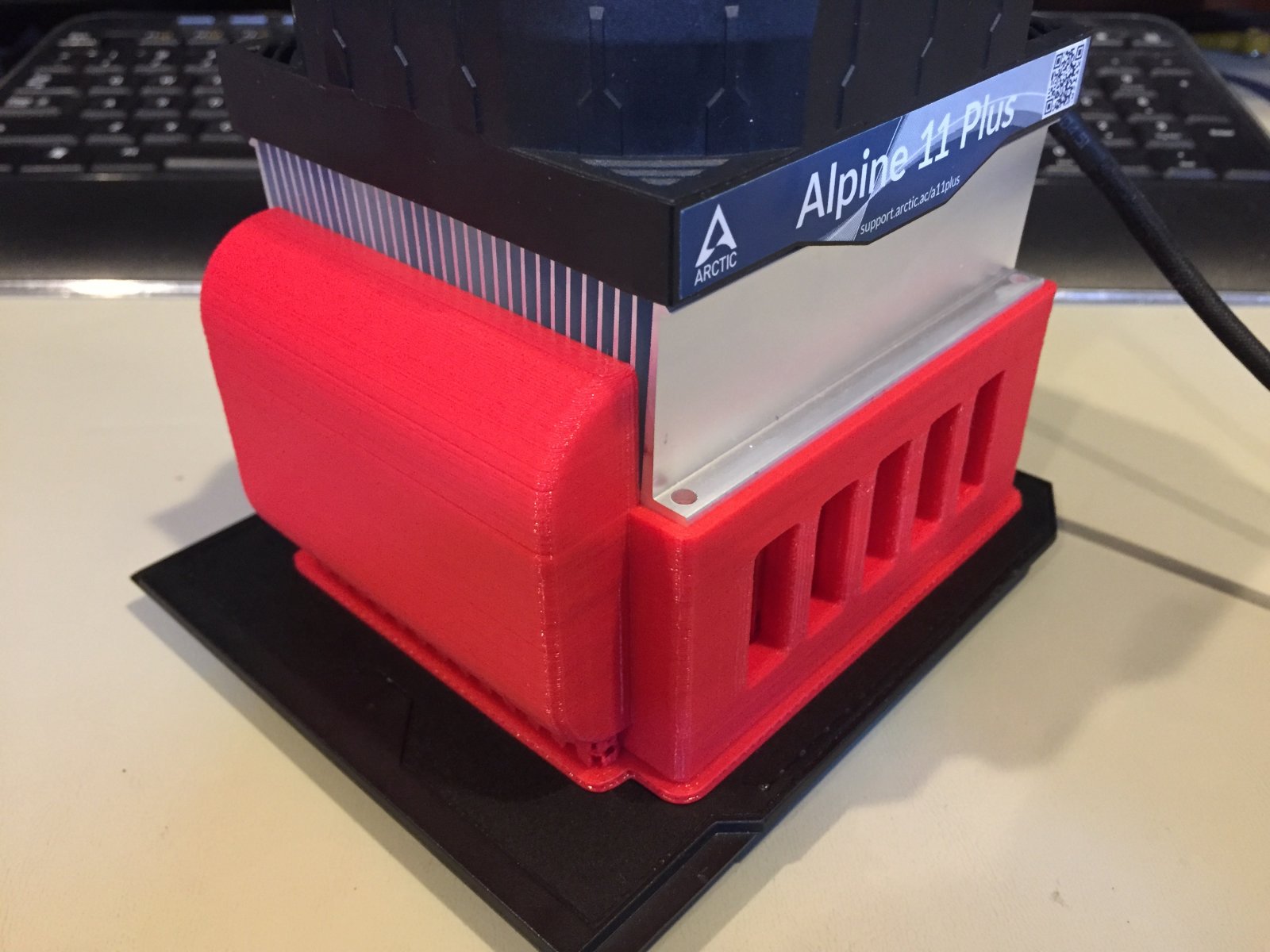

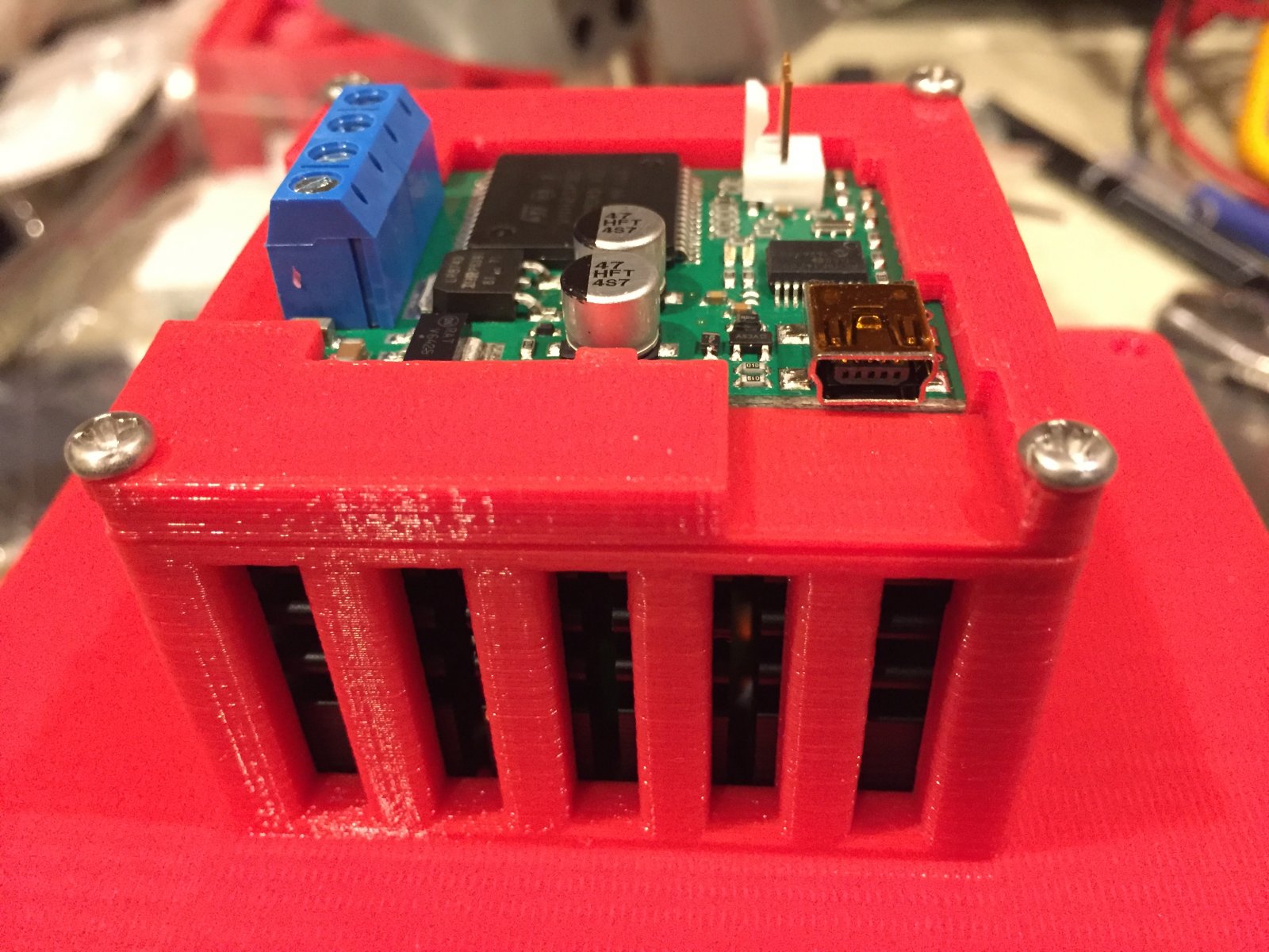

    This is how I'm mounting mine. Preliminary tests with two fans for a wind generator (about 12A but I didn't measure it to know) showed around 30 F temperature on the top of the bridge chip on an unheatsinked 12v12, and only 2-3 F rise on the top of the chip on a board with a heat sink. I haven't run them under heavy load yet but no reason not to expect an even more dramatic difference.

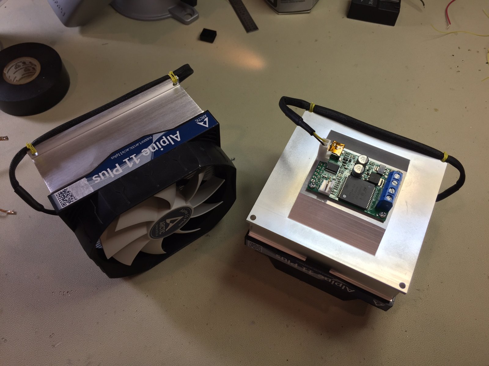

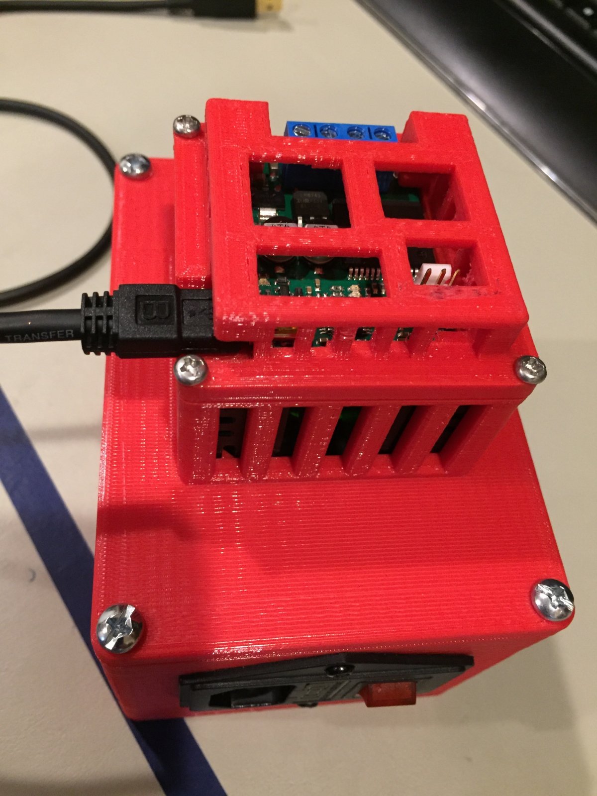

    The last pictures are a slightly different arrangement where I clamp (first photo was a clamping test to make sure the contact points were good) a JRK onto a heat sink on top of a box for a seat belt tensioner. Same thing, though. A fan is pulling air through the JRK heat sink and blowing it down onto the power supply. The photo of the aluminum heat sink and fan assembly is the big boy I'm using for my motion motors and should have much more cooling headroom. The first picture is how you want the JRK board to be on the bottom for this method - flat with nothing sticking out to short to the heat sink. The thermal pad is an electrical insulator but has high thermal conductivity and is also very fragile. Anything sticking down will poke right through and short out.
    But, as others here will also note, you can use a heat sink and fan on the top of the chip too. That's worked for lots here for a long time. The way I'm doing it is way overkill for most installations but I like keeping electronic things cool.

    Thank you so much for all the information. I probably will be sticking to a fan and heatsink type build for cooling the JRK's since I don't think I will be able to get the bottom part of the JRK smooth. I just don't have a lot of experience working with electronics and I'm more inclined to move in a direction that is an easy fix. I do see the benifits that your setup provides. Cooler is always better, and this seems like the best setup. What sort of material is the red stuff made of? Is that plastic? So you are using a regular CPU heatsink and just drilled some holes to mount some screws into?
  9. Zed
    Apr 4, 2017
    1,040
    USA
    5,842Coins
    +1,043 / 4 / -0
    That's it exactly. I used a 3D printer to print the boxes out of red PLA and the heat sink fan assemblies are cheap aluminum CPU coolers from Amazon.
