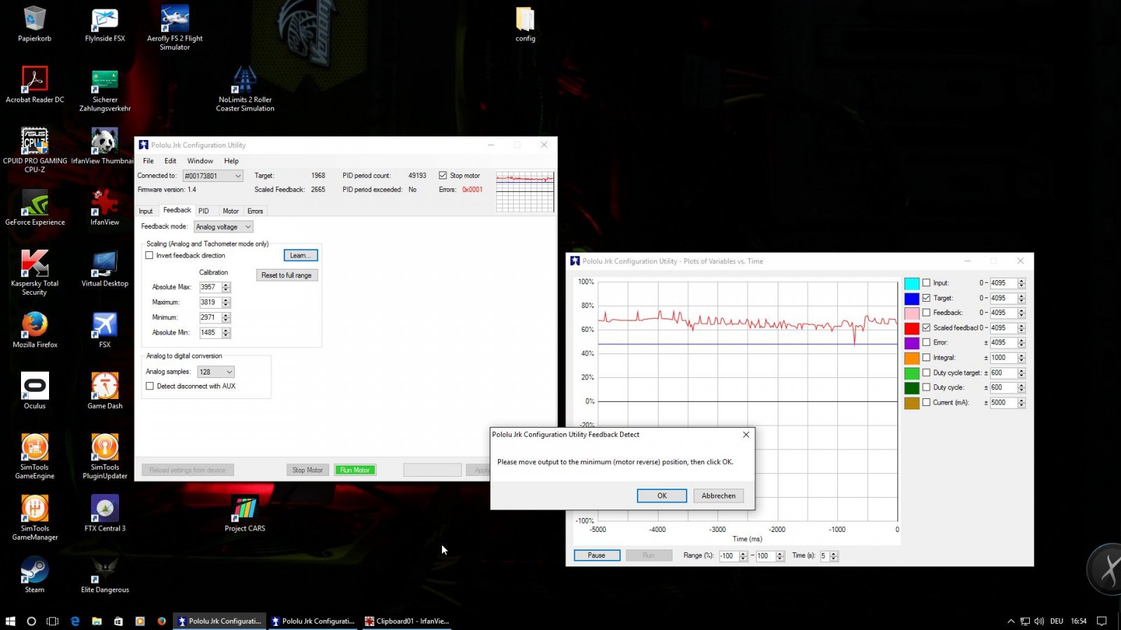

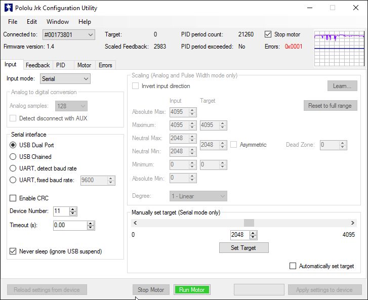

    Dear All,
    at the moment I have 4 JRK 12v12 boards installe on my rig:
    2 for my 2 DOF seat and 2 for my integrated G-Seat.
    The problem is that one of the JRK boards is not working properly: The red feedback curve is jittering so much, that it is not even possible to configure the board.
    Here is a screenshot of the JRK config utility with the feedback curve:
    All other 3 JRKs are working perfectly.
    What I did:
    I connected a different JRK with the pot and motor of the non-working board. Result: Works correctly.
    That means it is not a faulty pot and not faulty wires.
    Then I even bought a new JRK board and corrected it. Same result: Also the new JRK behaves in the same way.
    So either both JRKs are defect (maybe because of some mistake I did by myself), or it is a configuration problem.
    Did anyone of you ever xperience something similar?
    Thanks a lot for any hint,
    Markus

    It would help if you post all of your settings.

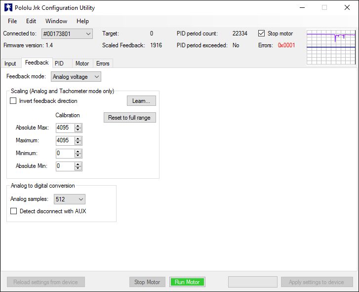

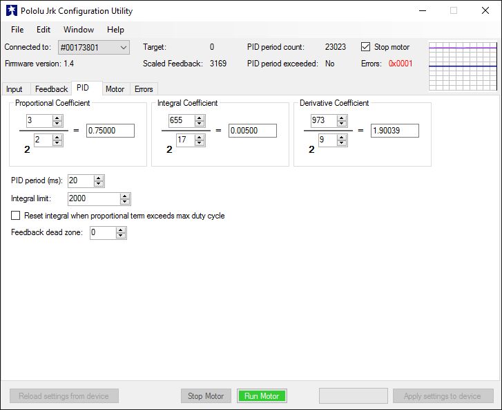

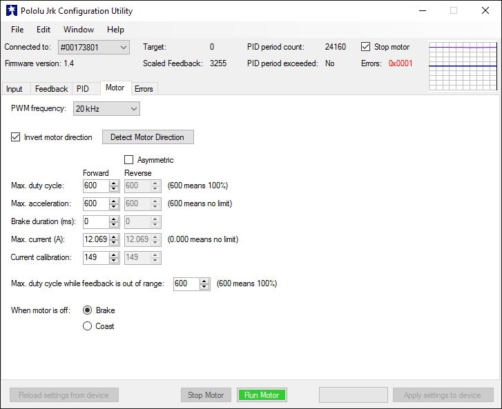

    @noorbeast: Here are screenshots of my settings:
    I have also added the exported settings file.

    Your don't look to have set the range in the Feedback tab by using the Learn button.
  5. MarkusB
    Jun 30, 2015
    552
    4,212Coins
    +594 / 2 / -0
    Yes, that's right. And that's my problem: I cannot do this due to the jittering.
    I can set the "max" value, because on this end the curve is not jittering that much. But when I turn the pot for reaching the "down" value, the curve starts jittering and jumping from one end to the other, so that it is impossible to set the value.
    20,549
    145,112Coins
    +10,778 / 52 / -2
    I would suggest you try changing the USB cable as well.
    Then reset the JRK to its defaults and start again with calibration, using recommended settings. It is in File ->Reset to default settings. In your first post the Analog Samples were not 512.

    Thanks, @noorbeast!
    I already tried 4 USB cables, and yesterday I installed the latest firmware. (Maybe it was already on it before, because it hasn't changed for some years.)
    I changed the samples to 512 when I compared the settings with those of a working board.
    Tonight I will follow your recommendation to reset the settings to their default.

    Unfortunately, reset did not solve the problem.

    Have you tried a different pot and wiring, rather than swap out the JRKs?

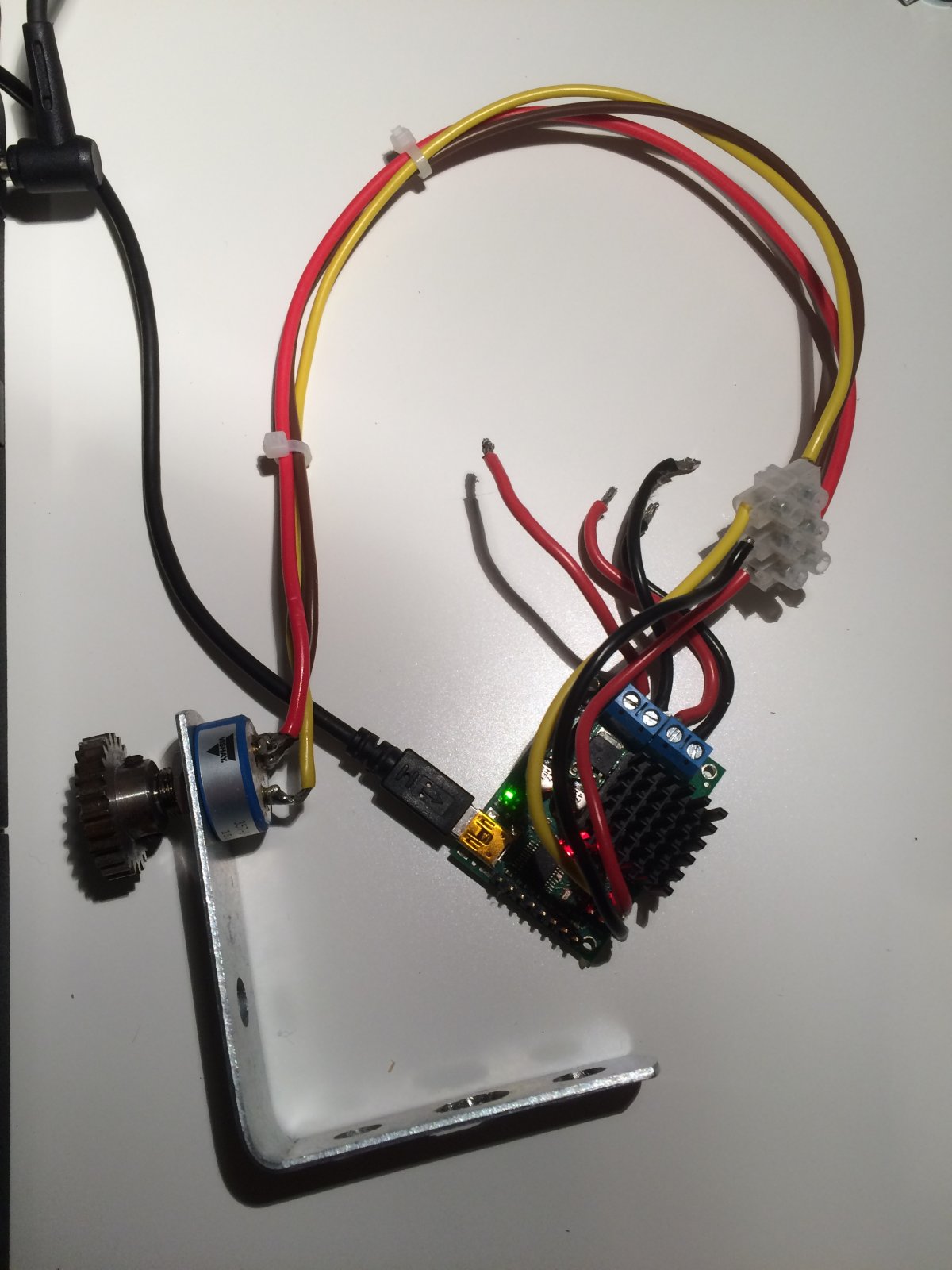

  10. MarkusB
    Jun 30, 2015
    552
    4,212Coins
    +594 / 2 / -0
    Yes, I tried a different pot yesterday without success.
    Today I dismounted the JRK and a pot from my rig and just did a minimal setup: I just connected the JRK to the pot and to a USB port, i. e. without PSU and without motor:
    Same result: The curve was jittering.
    I have 2 JRKs and 2 pots separated from the rig, and I tested different combinations of them forth and back, and suddenly it worked.
    Now both boards (still separated from the rig) work with both pots.
    I have absolutely no idea what I did differently compared to my tests yesterday, and this is a bit frightening. However, at the moment the curve is perfectly smooth.
    Next Saturday at the latest I will connect the JRK to my rig again and do further testing.
    For now thanks a lot for all your thoughts and hints, @noorbeast.

    Progress is progress, but it sure would be good to pin down the source of the interference.
  12. MarkusB
    Jun 30, 2015
    552
    4,212Coins
    +594 / 2 / -0
    Agreed. Maybe some tiny piece of metal sticked at the remaining soldering flux and I removed it when cleaning the bottom of the JRK. Otherwise I have no idea.
    I really hope that from now on my 4th JRK will work as reliable as his three colleagues.
    Then I am confident to finally have my rig fully functional next Saturday evening. In this case I will provide a report in my build thread.
