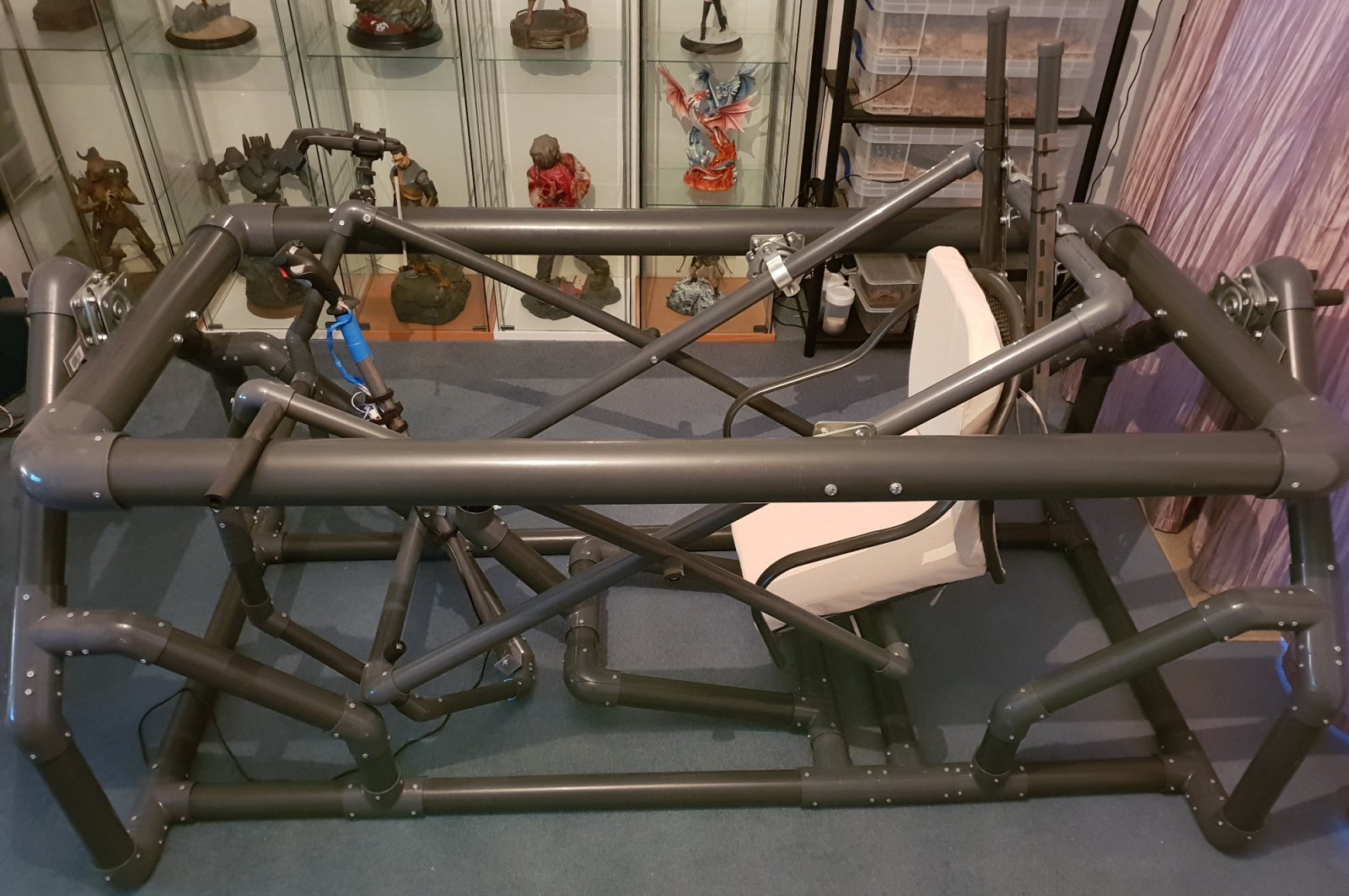

    Hi all, very new to all of this, so I'm not sure whether this will be of any interest to anyone seeing as there are some spectacular projects here.
    I was unsure whether to post this in the DIY or VR section, but the Joyrider is the star of the show, so I'll settle here (mods - please move this if it's in the wrong section.)
    Anyway, here are some shots of my take on the classic Joyrider, which I've dubbed "Winona".

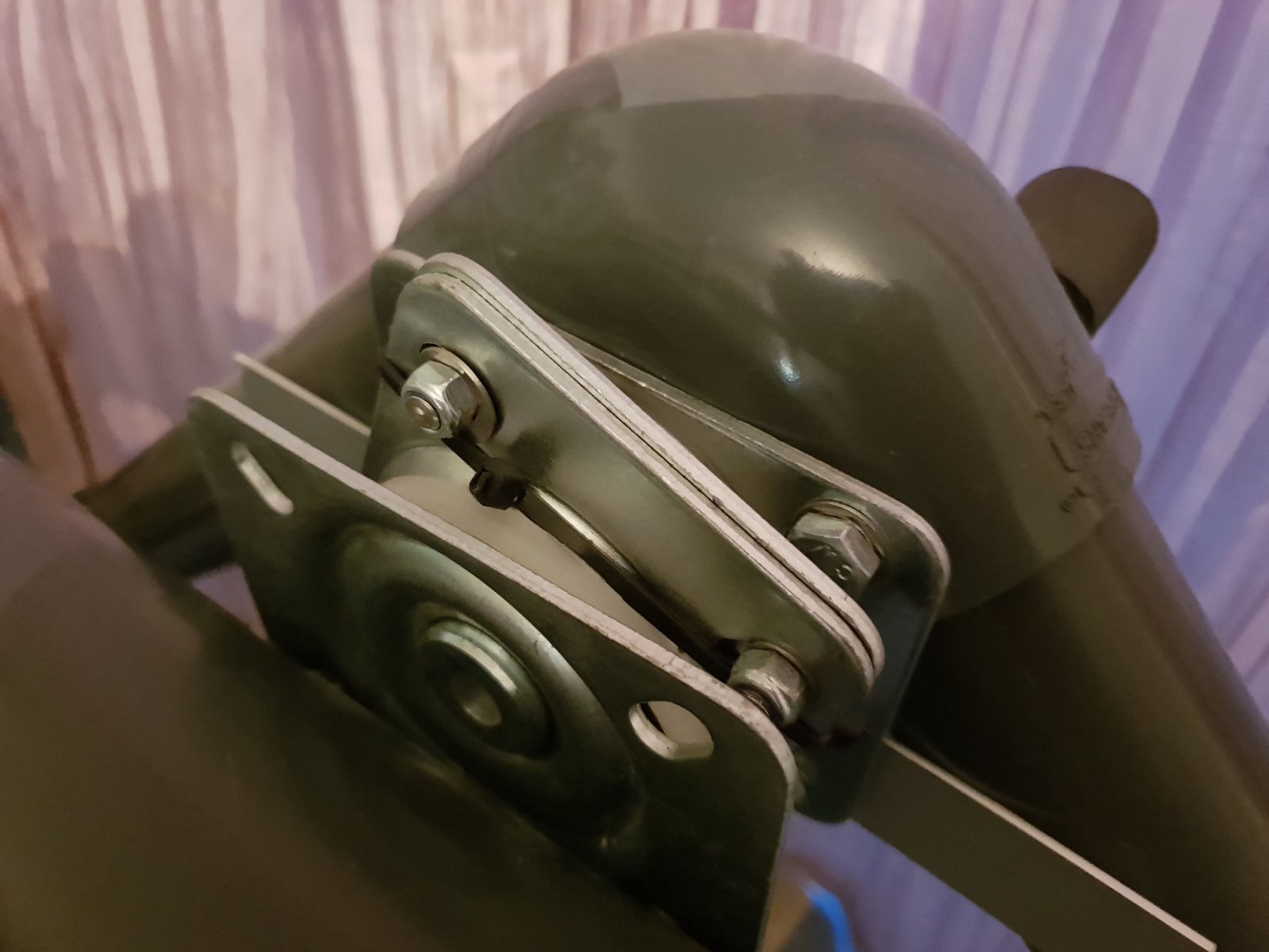

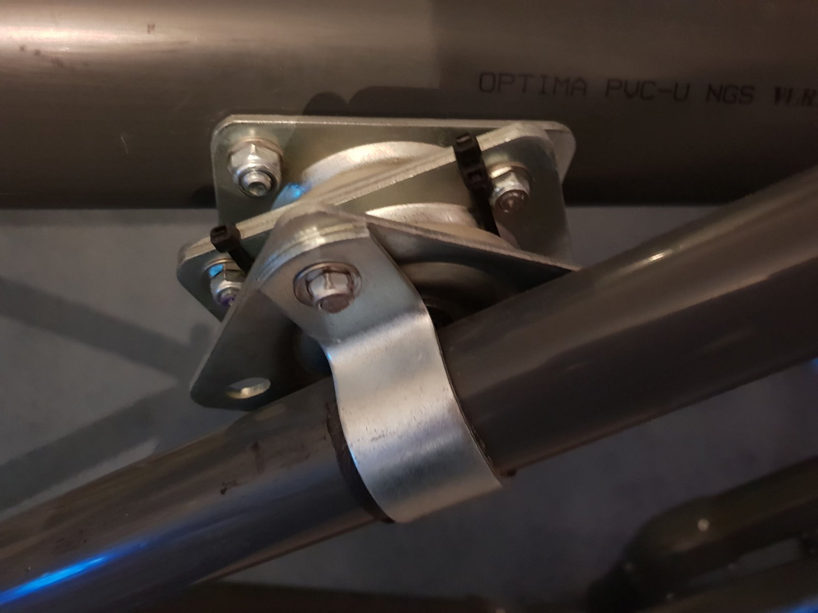

    You'll see that she's made from U-PVC for extra strength, and has dual-plate castors (dual-race) rather than the modified castors in the instructions.
    The seat is very low-tech, as you can see, but its comfortable and does the job (many thanks to my wife for quickly whipping up some foam seat/back pads.) It's still a work-in-progress, so the headrest will be added at a later date.

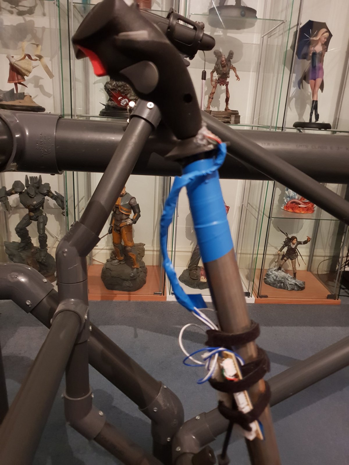

    I modified an old, but very comfortable 90's joystick and rewired the internals so that button presses are registered via USB.

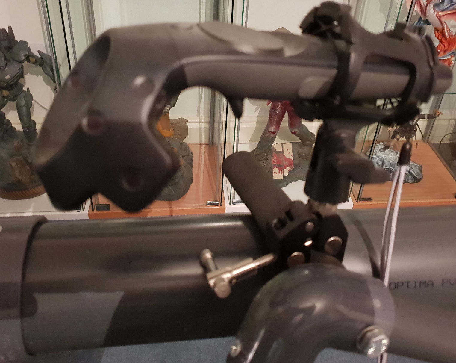

    I mounted a Vive controller to the frame for motion-tracking
