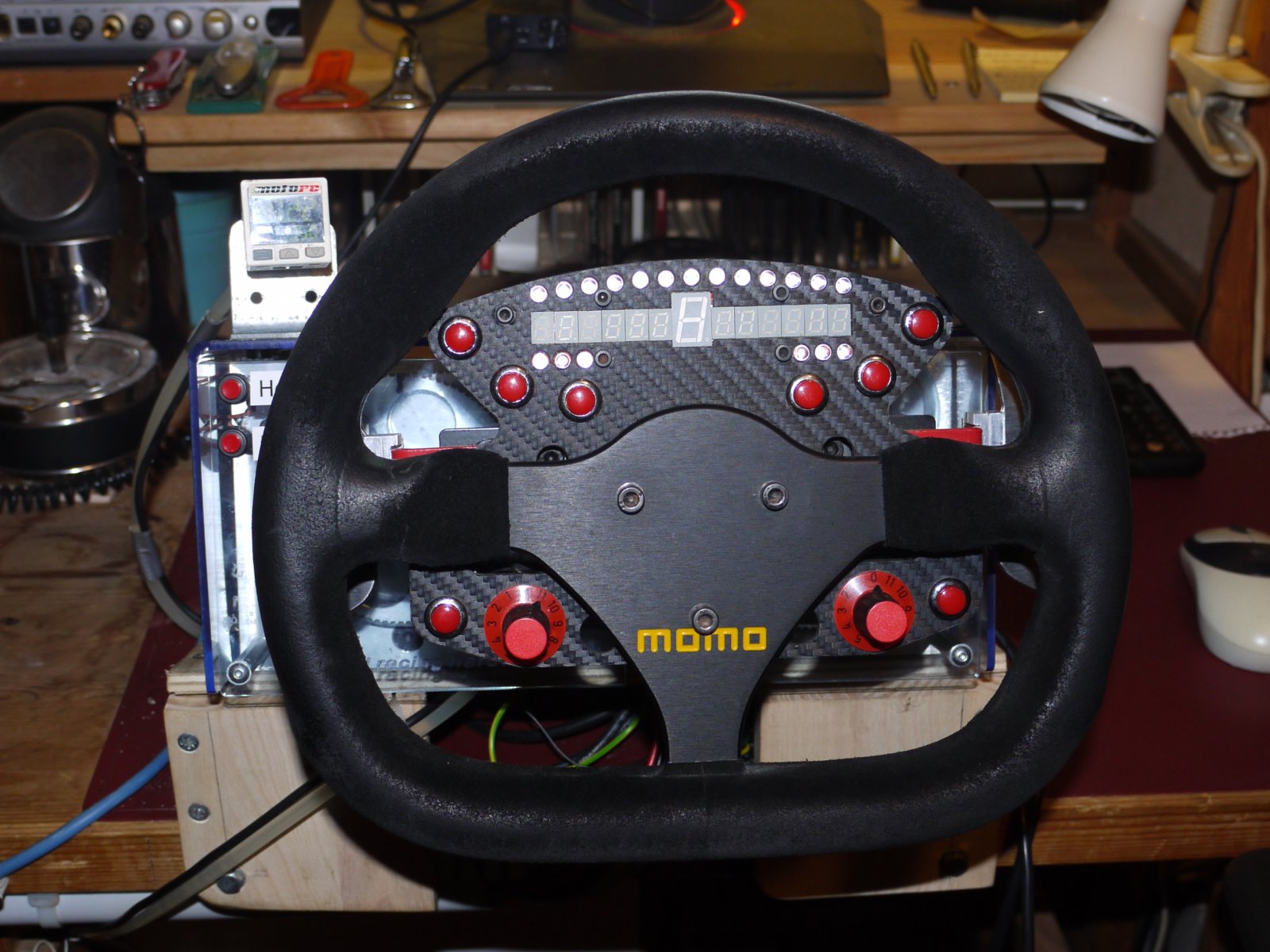

    I'm new to this forum. I'm from Germany and living in the surroundings of Heilbronn.
    In this thread I want to document my JL-G27-Mod. JL stands for Jo Lueg. JLVRH (Jo Lueg Virtual Racing Hardware) is no longer producing this wheel. The wheel consists of an excellent engineering mechanics. It's a belt drive wheel with the two parallel motors and the electronic board from the G27. The overall gear ratio is 1:25 (1:5 for the first gear and 1:5 for the second gear). The wheel is a D-shape MOMO (270 mm) with a SLI-PRO, eight buttons, two rotary switches (each with 12 positions) and two paddles. I've bought this wheel in 2012.
    This is a documentation about what I have done. This is not a tutorial. My way is not a cheap way. My target was to realize the best available performance for this excellent wheel with a good reliability by minimizing the mechanical changes.

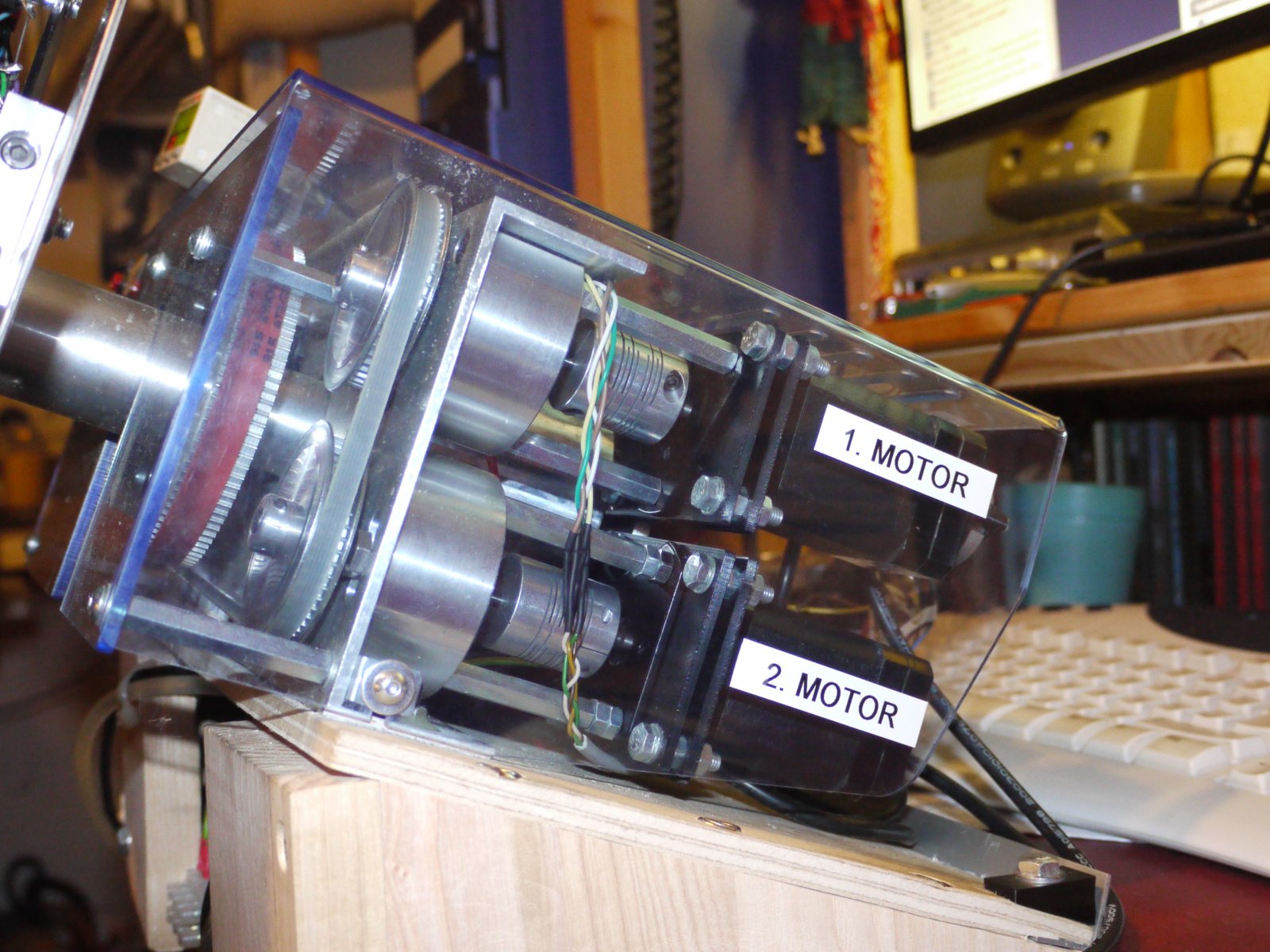

    Starting in October 2015 I've replaced the original and weak motors by two BL42-63 motors from Granite Devices (peak torque = 0.6 Nm). The original board was thrown away and substituted by an IONICUBE 4X board with two IONI Pro drives from GD (after discussing with Tero). All Logitech G27 equipment is in my opinion scrap: the two toy motors, the damageable board, the simple optical encoder and the plastic mechanic - except the wheel.

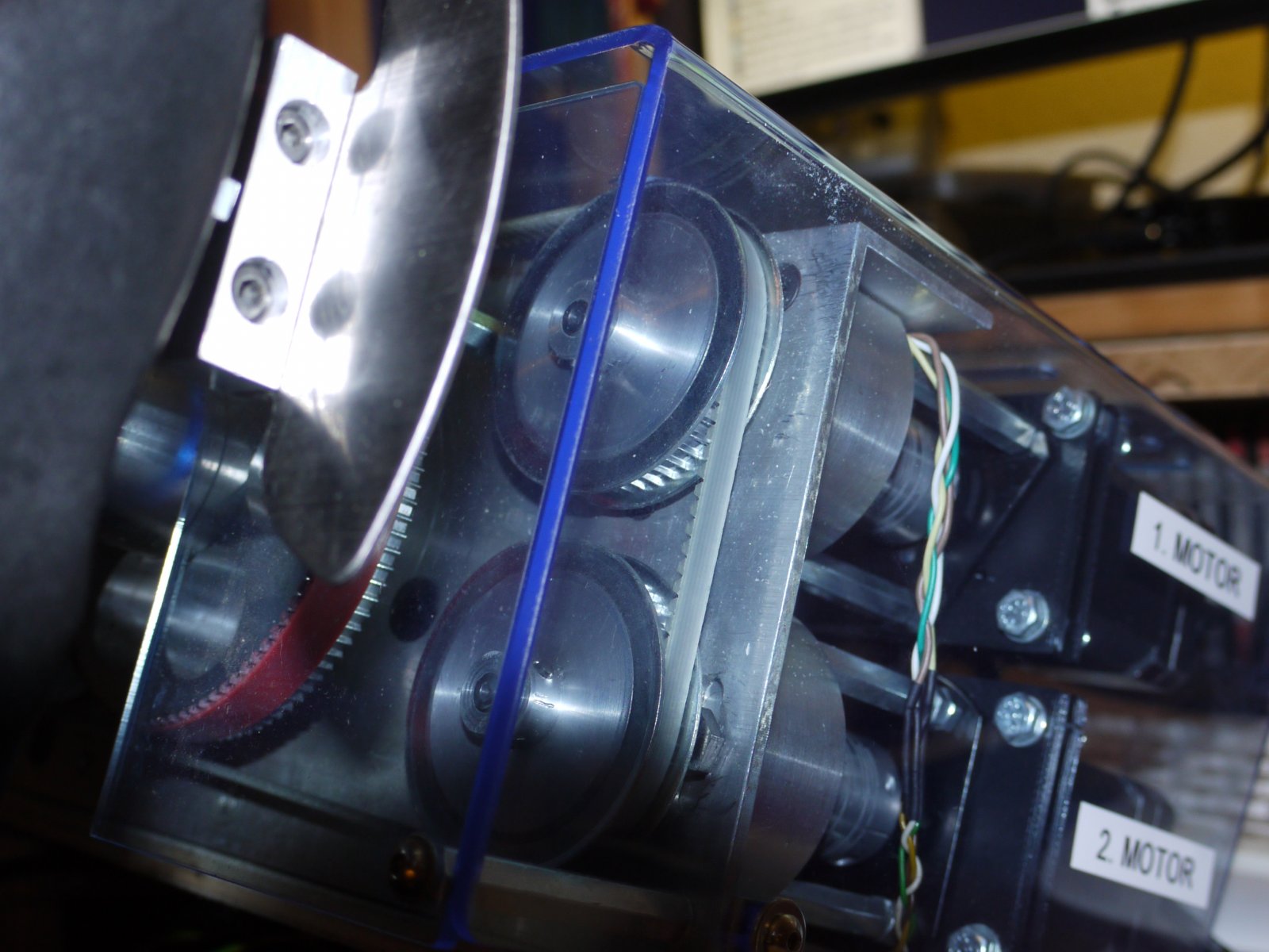

    To optimize the speed of the wheel I changed both motor pulleys from 20 teeth to 52 teeth (from RRG). Changing the gear ratio will increase the speed but decrease the torque (but: max. 30 Nm are too much - in my opinion for a wheel with a diameter of 270 mm). The change of the motor pulleys included the change of the primary belt from 600 teeth to a Synchroflex 6 AT3-648. So the original gear ratio of the JL-G27 was changed from 1:25 to overall 1:9,615 (first gear is now 1:1,923; second gear remains to 1:5).
    The result is a speed of a little bit more than 300 rpm and a maximum torque of round about 12 Nm at the wheel axis (based on max. current assumed as RMS). For my opinion this is absolute sufficiently for a wheel with a diameter of 270 mm. The outcome of this is a force of 80-90 N (single-hand) or 40-45 N (two-hand) at the wheel.

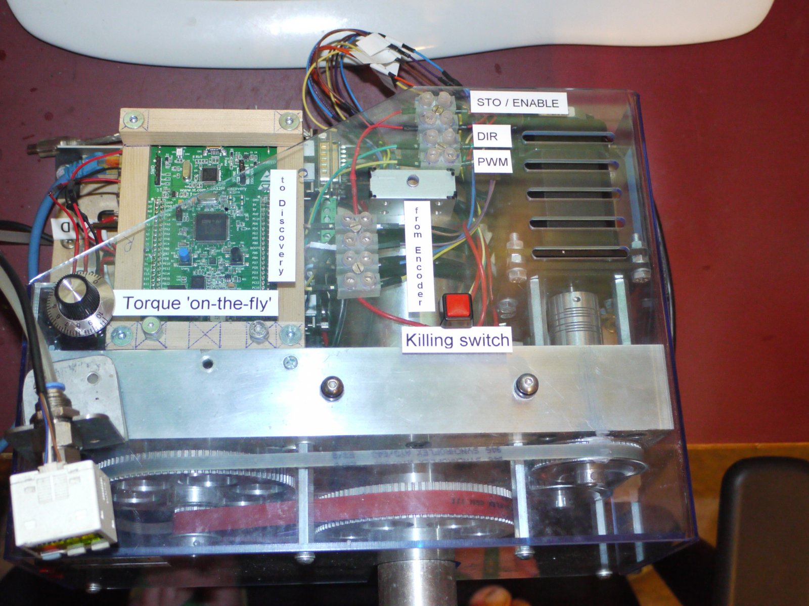

    Additional features were implemented:
    - killing switch,
    - adjustment against unlimited and uncontrolled wheel spin,
    - potentiometer for adjusting the torque 'on-the-fly',
    - two push buttons for homing (for exact adjustment).

    New adapter plates for the motors must be designed and test versions must be printed. New couplings had to be tested. At least I used the couplings from RRG. The ECCI-paddles were substituted by the Logitech-paddles.

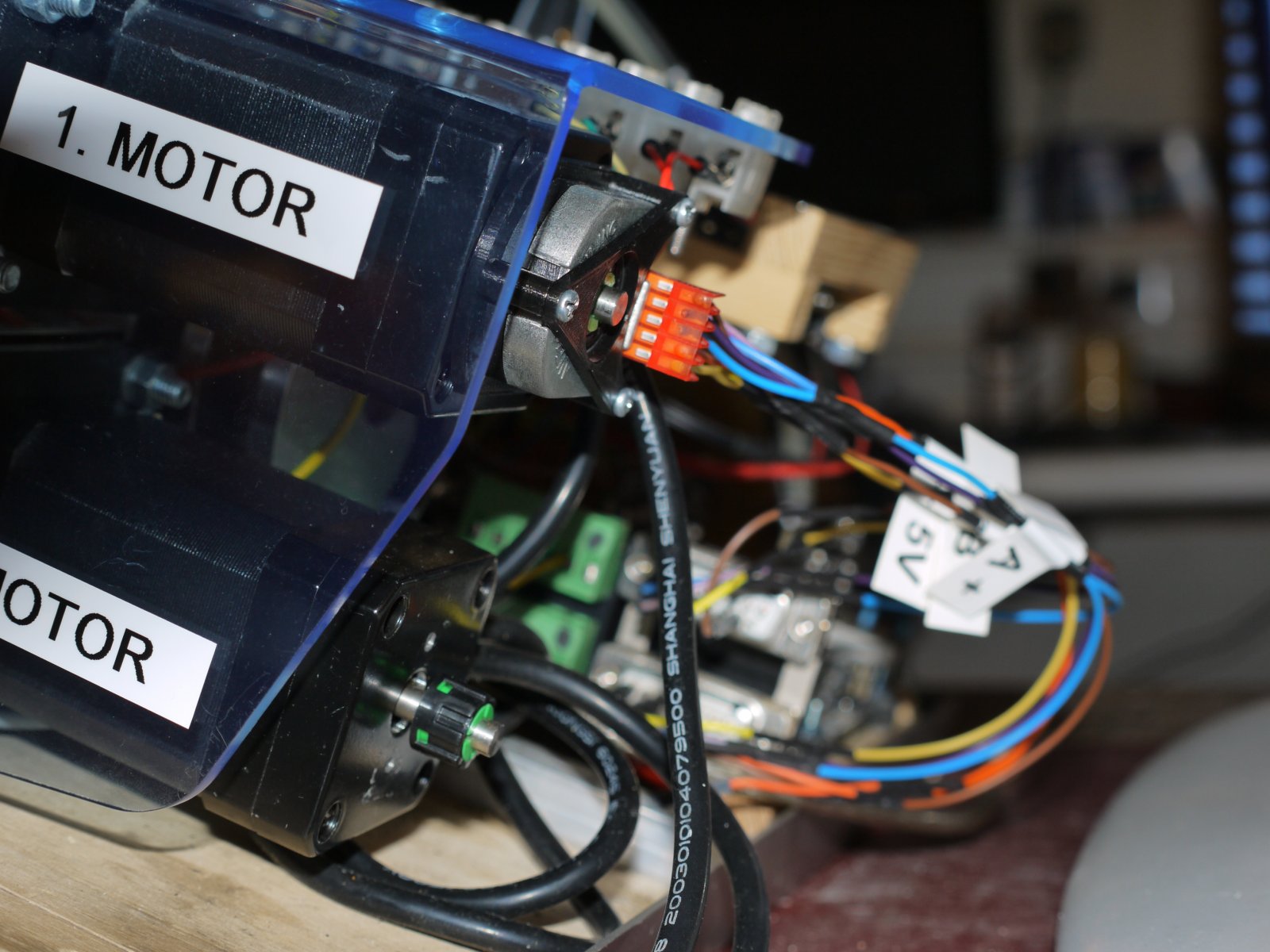

    The whole wiring of the equipment was a challenge for me. I'm not really an electronic freak. I drive the two motors in a master & slave configuration. The upper motor is the master with the encoder. The lower motor is the slave (with no encoder) which receives the encoder signals from the master. So a triple split of the encoder signals was necessary: first split for the master (connector X6 for slot IONI_X), second split for the slave (connector X6 for slot IONI_Y) and the third split for the discovery (pin GND, PA1, PA0, PA2).
    The encoder was adjusted by the dip switches to 512 PPR which means 512 PPR in the Granity software and 19692 CPR for the setup in the MMos software. The resolution of 512 PPR came from the former gear ratio of 1:25 (512PPR*4*25=51200 CPR). Because of this starting point the original encoders of the BL42-63 motors were demounted.

    Here are some pictures of the modified wheel.
    JL-G27-Mod
