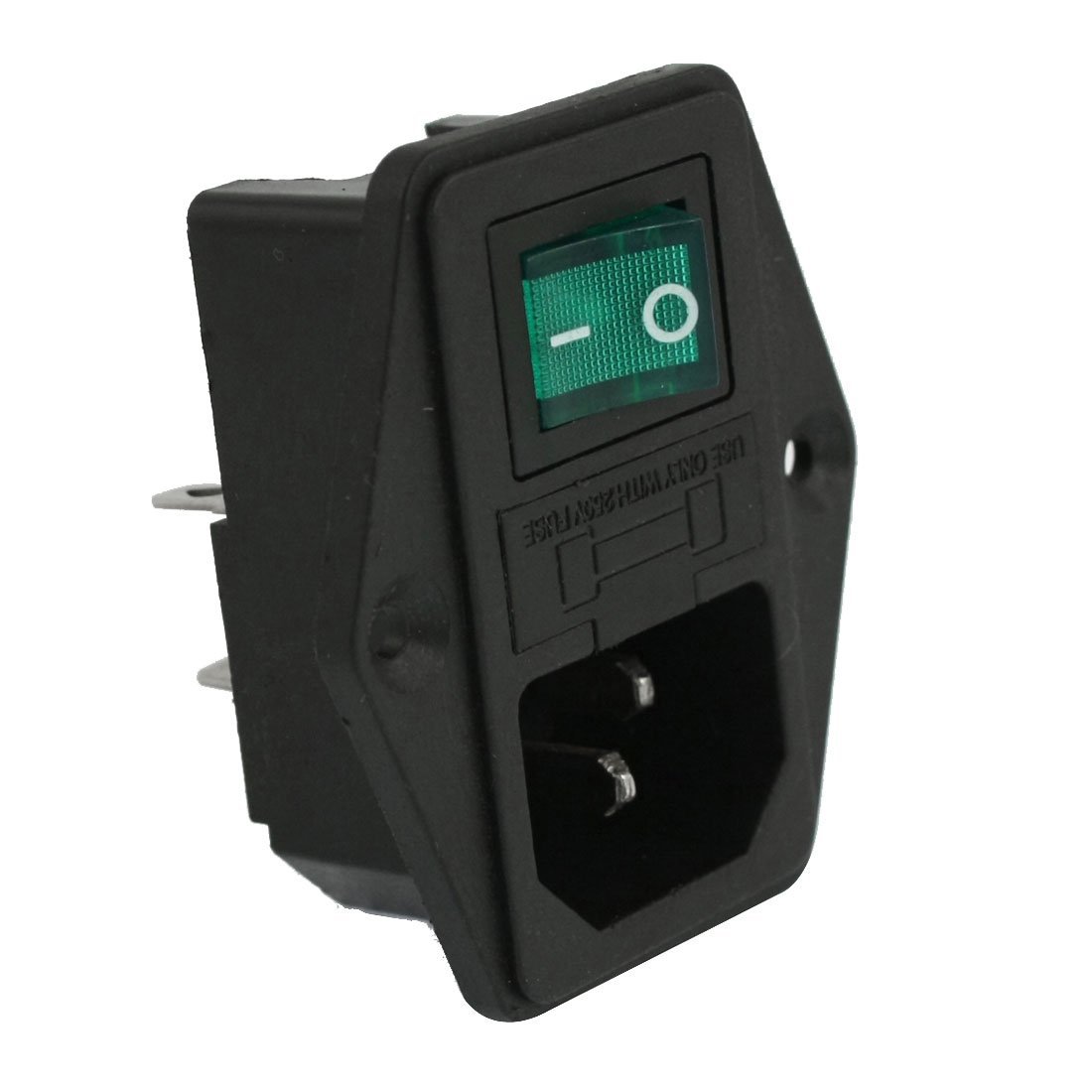

    So quick question, right now I have my 3 power supplies plugged into a power strip:
    If I moved them into a case and cut the ends off the power cords and wired to one input like this:
    amazon.com/URBEST%2525C2%2525AEInlet-Module-Switch-Socket-IEC320/dp/B00ME5YAPK
    Anyone see any issues with that or should I suck it up and run 3 input jacks for power on the case? :) I have the 575w power supplies so looks like my max load ever would be 15A total, but I don't think it ever gets that high. Now my problem is those sockets are only rated at 10A.
    Any suggestions?

    What the power supplies draw and what they put out is irrelevant. Ive got a 10 way power board on my sim, plugged in is the PC with 1100 watt power supply (uses about 850 watts), 2 x 12 v 40 amp PSU, 40 "tv, speakers, wheel and pedals, not a problem, in fact, when I had my 2 hire sims, I could run them BOTH off another extension lead from the 10 way power board. So potentially 3 sims running flat out off one 10 amp 240v socket.
    Power supplies are designed to put out more power at lower voltages than what they draw. So you could have a 12v 100 amp PSU running off a 10 amp main plug. Its because of the components in the PSU that decreases voltage but significantly increases current. Thats mosfets for you, marvelous little buggers.

    Looking at your locations, it's important to note that, in the USA, wall outlets are 120V and not 240V, so in the USA, you could NOT have a 12v 100A PSU running off a 10A mains plug.
    Running 3x 575W PSUs off a single 15A leg is possible as long as nothing else is on that circuit. Also, understand that when you first turn on the PSUs, the inrush of current as the capacitors charge might trip your breaker (some breakers are very picky, if it happens more than once, I'd replace it, the next one probably won't be as picky). I recommend not using that switch, but instead one that's rated for 15A. The problem with using underrated switches and wires is that, over time, they heat up, which increases the resistance, which causes them to produce even more heat (they are a higher fraction of the total load), and eventually results in failure and possibly a fire. The cost of a properly rated switch, compared to the deductible for your home owners policy, is tiny.

    I run 3 600pb's Plus My PC(850wpsu) and My Stereo 500w Pioneer, And my 47"TV+22"side monitor, And everything else, Shaker's(single gamer 2 90w a,p and 2 mini LFE's on a dayton 150w amp, LED's, Fans for cooling, Cable box ect ect ect, on a combination of 2 separate wall plug's, Both of which are on the same breaker which has never Once tripped.

    I would be very very concerned. While the stereo and computer will both use far lower than their rated capacity, if your cable box is the DVR type, they can chew up a couple hundred watts all by themselves. A 120V 15A breaker is typical for north america (both USA and Canada), which equates to 1800W. This is for everything on that leg from the breaker box.
    Circuit breakers are an important safety feature, but they aren't perfect. Some trip faster than others, even from the same manufactured batch, and they can go bad. If they go bad by staying open, easy peasy. Pop in a new one, on come the lights. If they go bad by fusing closed, you might not know you have a problem until disaster strikes (a fused breaker is not in itself a fire hazard, but a overload that can't be interrupted most definitely is).
    About three years ago, I had a breaker get fused, it was a dedicated one for the fridge. I had no idea that it was fused shut until one night, the fridge door came open while we slept, the compressor overheated, and rather than the breaker tripping, we had a wall fire. No real damage, we caught it in time (smoke detectors), but that breaker was replaced and the others checked immediately after the fire. We also had to replace wiring in the all, not cheap.
    A working breaker is the difference between inconvenience and disaster.
    If you have access to a meter or a "Kill-A-Watt" device, please confirm that you aren't over 1800W and the breaker is not tripping.
    NOTE: Your power supplies consume more or less current depending on what the motor is doing. A rapid change of direction under load could come very close to the power supplies rated maximums. I *encourage* you to run a separate power cable, as 3x 600pb power supplies will consume most of the available current all by themselves when running at capacity.
