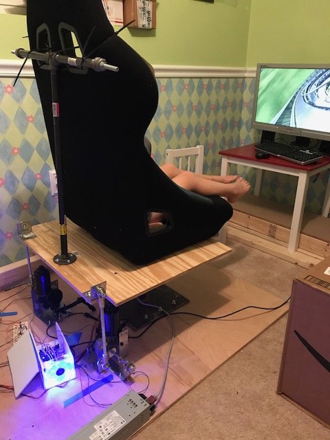

    I really just wanted to make something that worked before I spent a bunch of money on parts and gear. I already had several arduinos so the monster moto was an easy choice at the time. I actually love the building and coding process too so I usually go that route with most of my projects!
    Details:
    Standard 2DOF Seat mover with Arduino/monster moto/wiper motors
    Motors - wiper motors are from a pick-n-pull type junk yard. These came from Ford Expeditions - my thinking was a bigger truck like that was likely to have beefier motors. These have not be stressed too much, but they have been working great so far. No ground isolation was needed for these and they already had a beefy arm on them. The motors move me around pretty well and stay cold to the touch so they seem to be up to the job. The plan was always to get bigger ones eventually but these are working well for now.

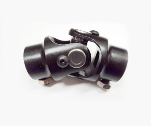

    U-joint - I bought something very similar the pic below and took it to a local welding shop to fabricate a way to mount it. I got something usable but I feel like there is some slop in it so I may end up replacing it with something better.
    Software - I started with @RacingMat's arduino code and refined the code a bit and got it running pretty well. I then found the SMC3 code from @RufusDufus and am currently working on getting it tuned. I do like that it is a full-blown PID controller, although so far I don't think it feels any different than my customized code. I think once tuned it will probably end up being pretty good.
    The seat is a standard cheapo ebay racing seat and the frame is nothing more than a sheet of 2x2 plywood and some threaded pipe. Its not pretty but it got the prototype working quickly and without having to pay another welder!

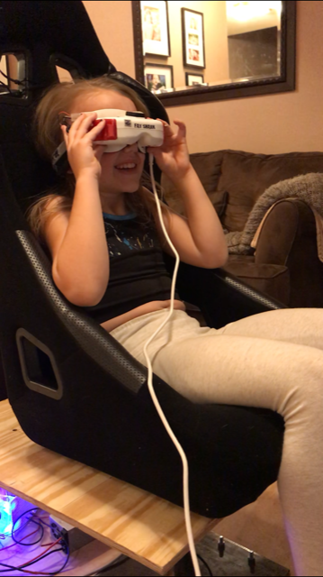

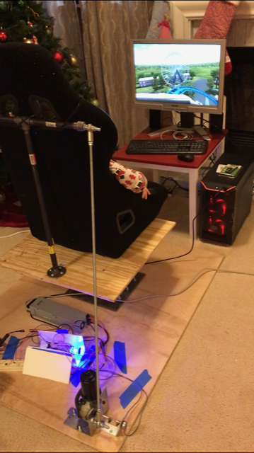

    Here are a few pics of it with my kids on No Limits 2 (great fun by the way!)
    I don't have an Oculus Rift (yet) but even these FPV goggles add a lot to the immersion! I need to start saving my pennies as the Rift + PC upgrades will make that an expensive addition!

    So the prototype is a success, at least with No Limits 2! I am working on a crude wheel and pedal stand so I can test out some racing games. That will be crude and ugly too at first!
