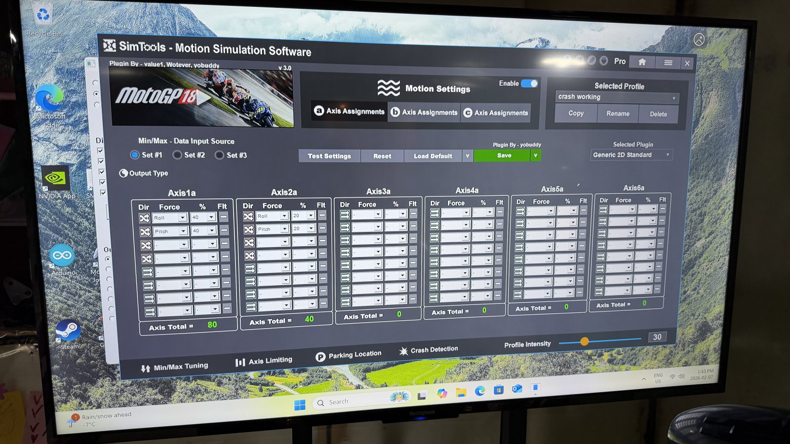

    I built a motion sim out of a Kawasaki ninja. This wouldn’t have been possible without this amazing community. https://youtube.com/shorts/6dWYKVgAZjE?si=R1eSIPgawQSK0Pdv I am running an arduino, sabertooth 2x60 and have SMC3 working perfectly. I am running 24v power supply with large batteries as well. The issue I’m having is whenever I’m playing the game it will randomly start shaking like crazy and won’t stop. The only fix is to hit my emergency stop button, then unplug and re plug the usb. But then I need to close the game and re open it. This makes it unplayable. Been trying to figure out what triggers it and I believe it is when you crash or hit a sign in the game. It states shaking like crazy. I have played with crash settings in simtools v3 a ton and just cannot figure it out.
    Any help would be greatly appreciated.

    Can you please provide pictures of all your SMC3 and SimTools setting.
    Additionally, can you provide any further context, other that time as to when the oscillation starts, have you hit anything, is it in the same spot, does it seem to have any consistent basis as a trigger, like thermal issues?

    The image below shows SimTools and SMC3 running at the same time, that will cause a port conflict:
  7. 204flightsinmotion
    204flightsinmotion Member
    Aug 28, 2023
    43
    227Coins
    This was just to take a quick photo for you guys.
