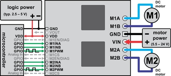

    I am using a Dual VNH5019 motor driver shield with an Arduino UNO R3 where the Arduino is powered separately by the Notebook (jumper is off)
    The issue: I get some big noise on the pot feedback line ONLY coming from the M1/M2PWM lines (VNH5019) to the Arduino and ONLY if the PSUs (24V) are on.
    Second there is something which makes me stunning: the mouse pad of my notebook does not respond respectively there is a big lag on it, ONLY if the PWM line is shared to the Ard and the PSUs are powered on.
    To be clear: no 5V line is connected from the VNH to the Ard, ONLY the PWM line is shared.
    Electronic gurus, any help is much appreciated :)

    The Ard and the VNH need to share a common ground also. Connect a wire between the Ard's gnd or its power supply's gnd and the VNH's gnd on the control side of the board, not the motor side gnd.

    Hi Pit, I know you have tracked the problem to the laptop PSU but can I ask what you have done with the VNH5019 M1EN/DIAG and M2EN/DIAG pins? Are they connected or not?
    The datasheet for the chip says they need to be connected to an external pullup. There is an external pullup on the pololu board schematic but if you don't have the 5V connected from the Arduino I don't see how it is actually pulled up to anything?
    Also I note your pots have long wires on them. Make sure in the final build they are twisted together. What value pots are you using? I would suggest using something around 5K with those long wires.

    I don’t know if this the cause of your problem but according to Pololu the minimum connections require Vdd on the driver be connected to the Ard’s 5v for the pull up resistors and also the control source and the motor driver must share a common ground. https://www.pololu.com/product/1451

    There is some misunderstanding about my explanations...
    I connected the Ard and the VNH this way:
    Then I noticed when the PSUs have been powered on the noise on the feedback line.
    At least I localized the noise coming from the PWM lines only, that said even if only the PWM line is connected, the noise persists. This was my conclusion that the PWM is the source of the noise, but it was not due the notebook issue.
    Definitely it works now.
