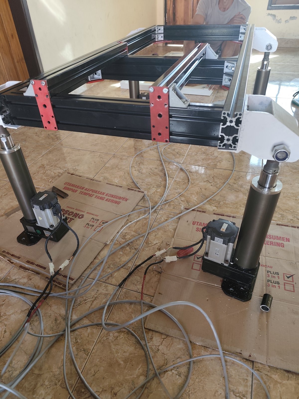

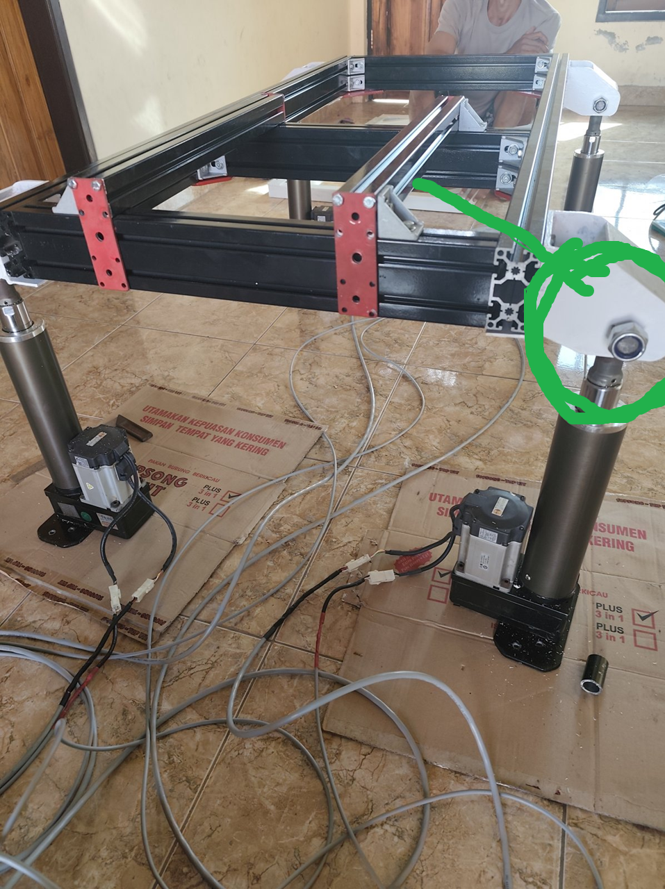

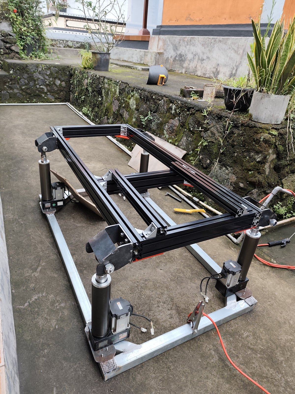

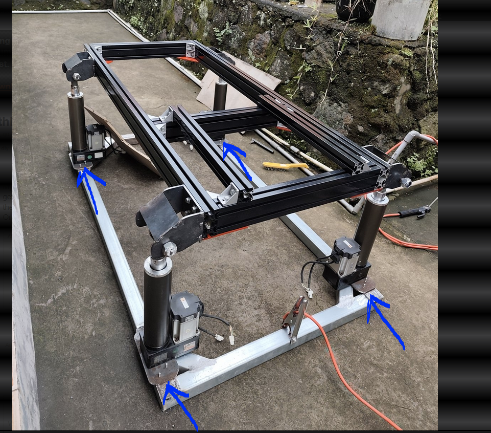

    My desain is 4 actuactor on corner, but i dont upsidedown the actuactor. Like on the picture, its will work or will get trouble?? Base of actuactor is fix welded on the base rig, on the stroke of actuactor with rod end(ball end) to the up rig..
    Or i need to make it upsidedown??

    Need to add some joints. When the actuators move, the angle of the upper frame will change, which will require changing the installation angles of the actuators (this requires joints at the bottom) or changing the linear dimensions of the upper frame (which is impossible in this design)

    If pur botem joint the rig will falldown, because on the up already with rod end ball joint sir

    Yes, you're right, but that doesn't change what I wrote.
