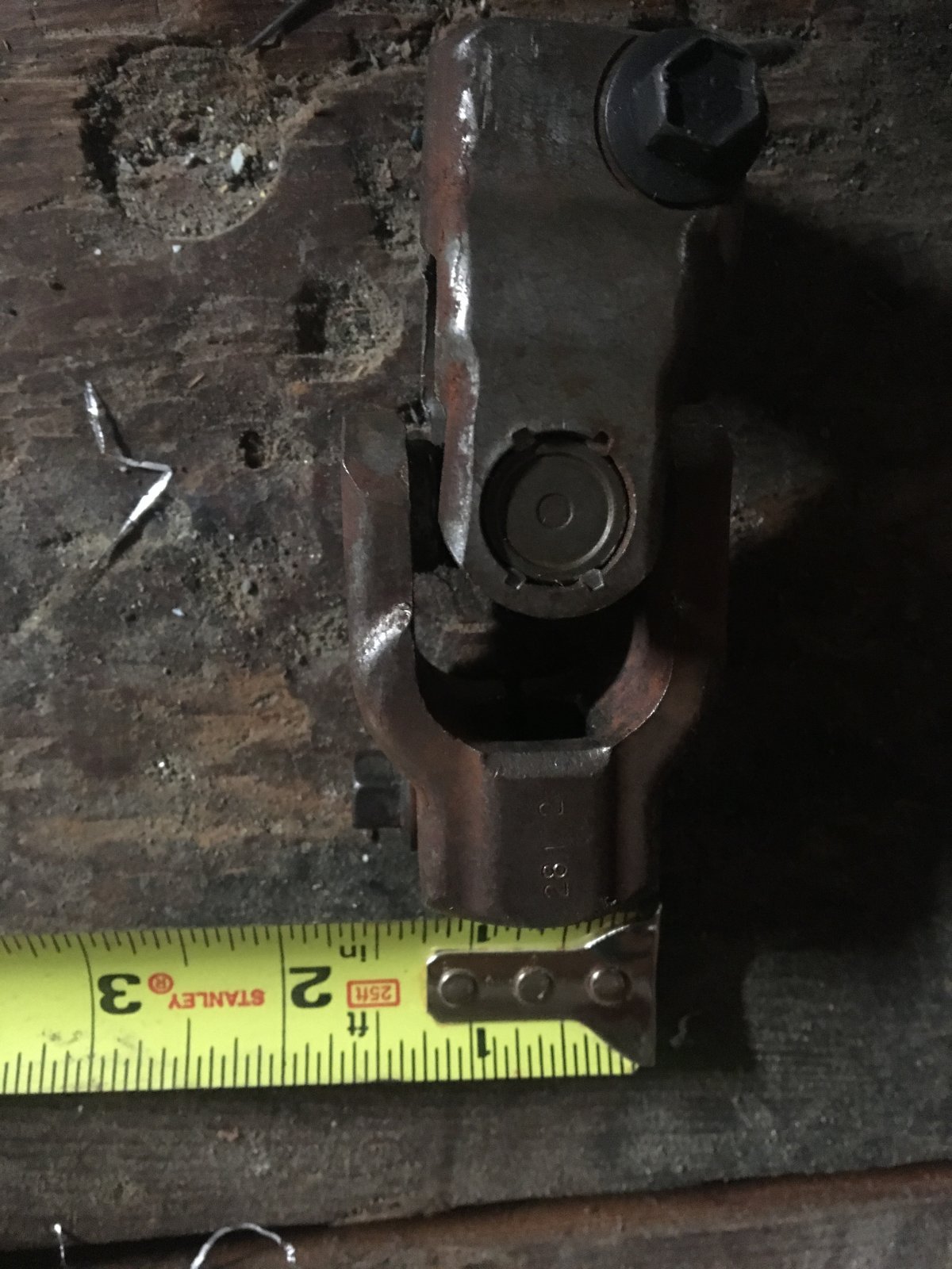

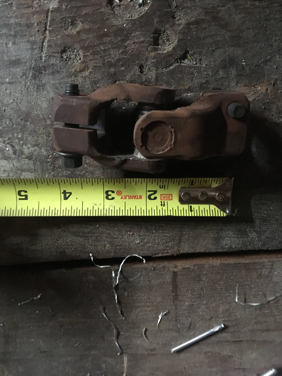

    So I picked up this u-join online- it's from the steering column of a 93 Mustang:
    It's a bit smaller than I expected. It seems like folks are using much bigger joints, maybe from a different part of a car. Has anyone built a frame mover with this sort of joint?
    I think that if properly welded, it'd probably take the weight of me, my frame, and chair. I am doubting myself because I haven't found any examples of folks using anything that looks to be around this size.

    Hi, You may have success with that. I'm seen builds using the U-Joint from the Steering column of a Land Rover (Can't find the link at the moment)
    Chances are, if it's in a car, it's been engineered beyond what we could throw at it :)

    The srock simxperince joint is about that size. As long as no side to side play you should be fine

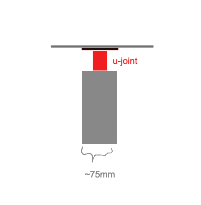

    The rod that the u-joint is mounted on seems quite a bit smaller than what I was imagining. Something like this:
    The 75mm base would probably be steel, but possibly a ticket aluminum. Either way the bottom of the u-joint will be welded to either a steel cap the is bolted to the aluminum, or welded to the steel base. The black line at the top of the u-joint is a 75mmx75mm steel plate that will be bolted to an aluminum plate or some other mechanism to attach the chair.
    I am wondering if maybe a more robust base might counteract the twist you were experiencing? The joint itself seems quite solid.

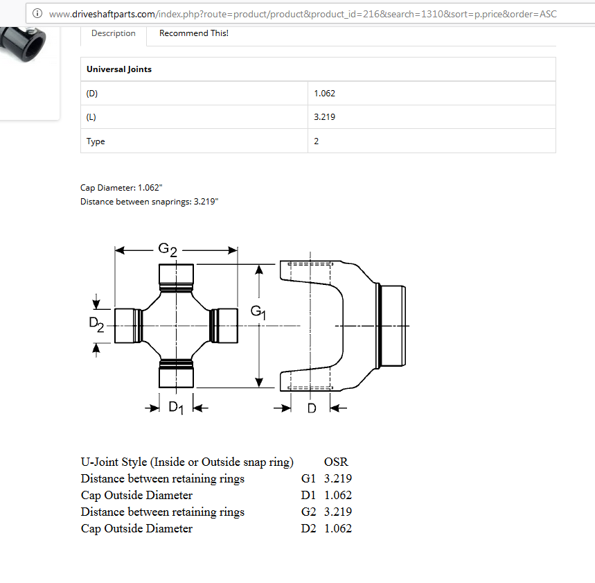

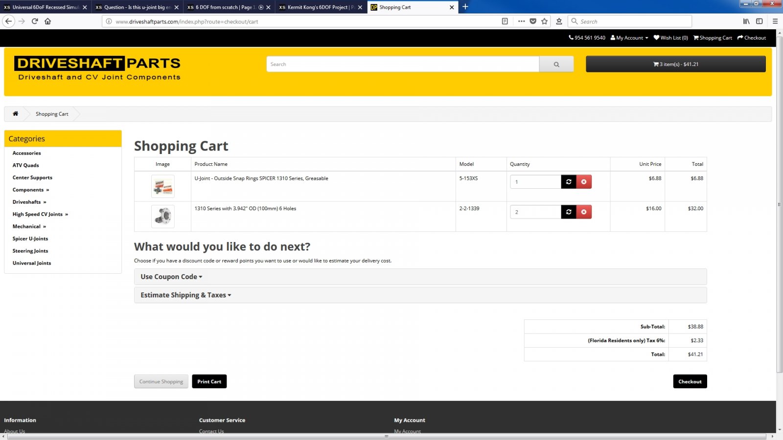

    It's always a head shaker when looking at things from various angles, and missing the simplest solution....until your comment, my brain didn't wake up(take apart the u joint, add another flange, duhhh)...so I'd been thinking of "filling in the hollow" with a 3d printed plate, but your solution just made basic sense, so ebay search found 2 flanges, buy 1 u joint...of any type, like a spicer flange/yoke model and pop them together.

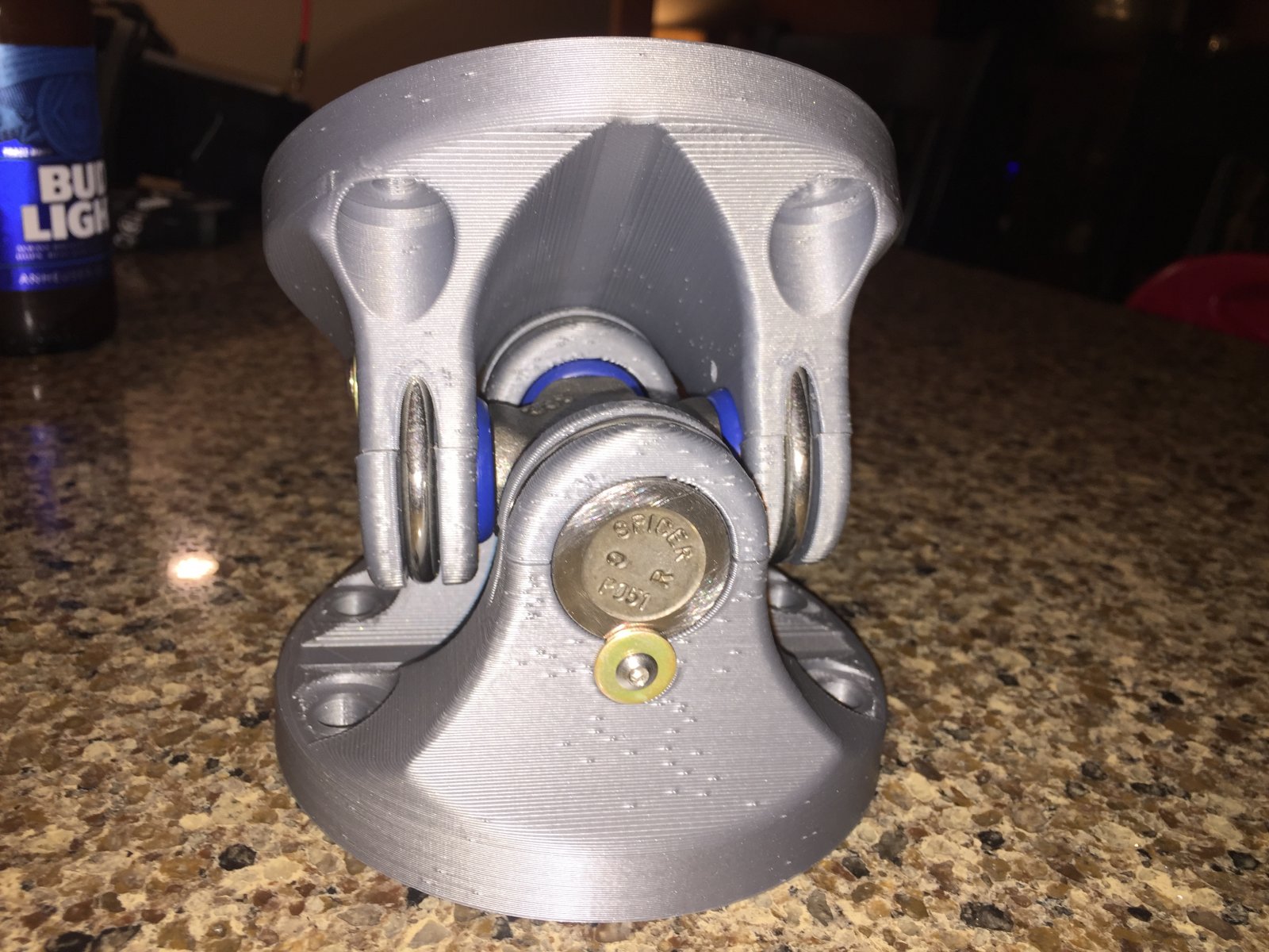

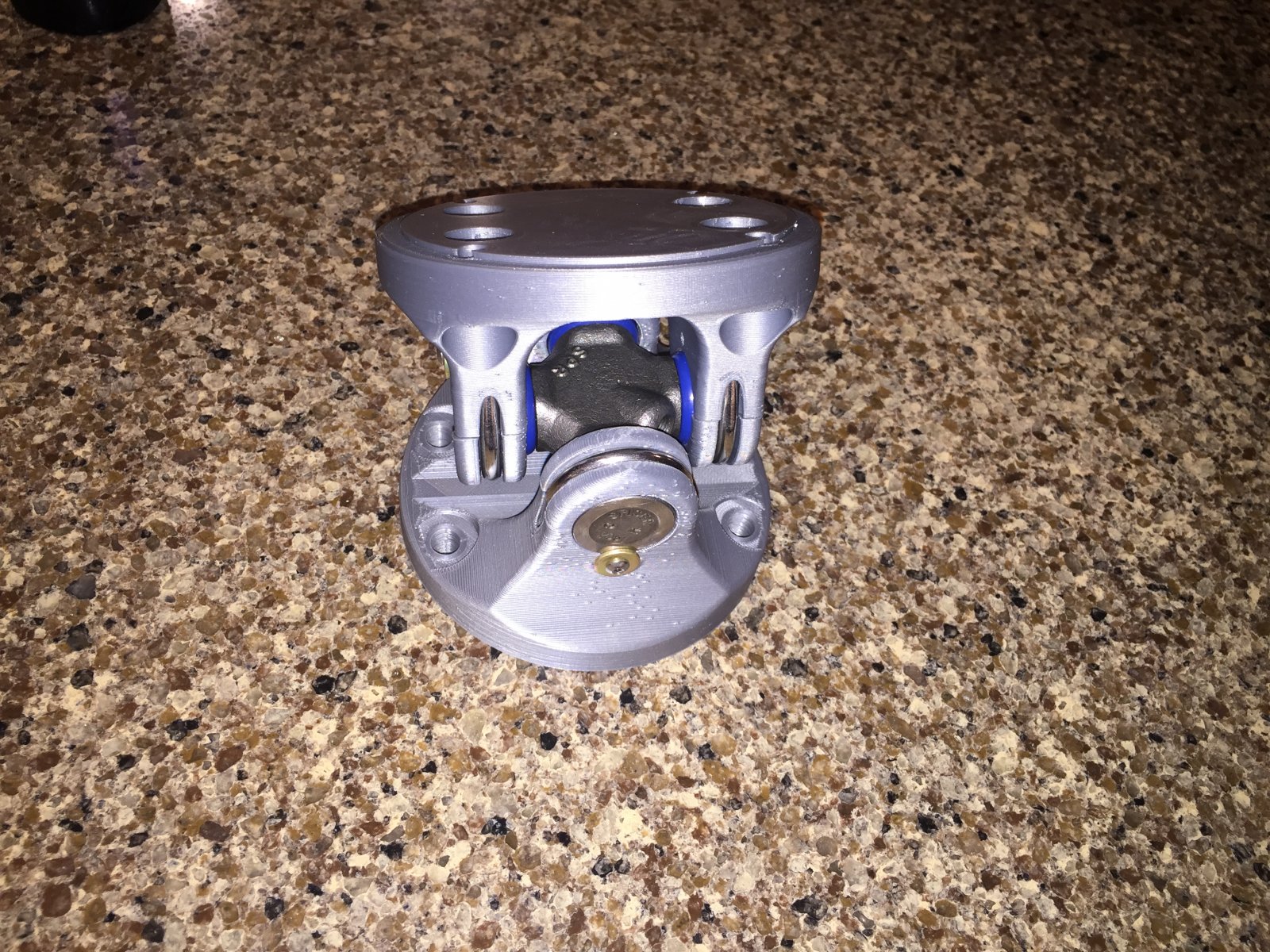

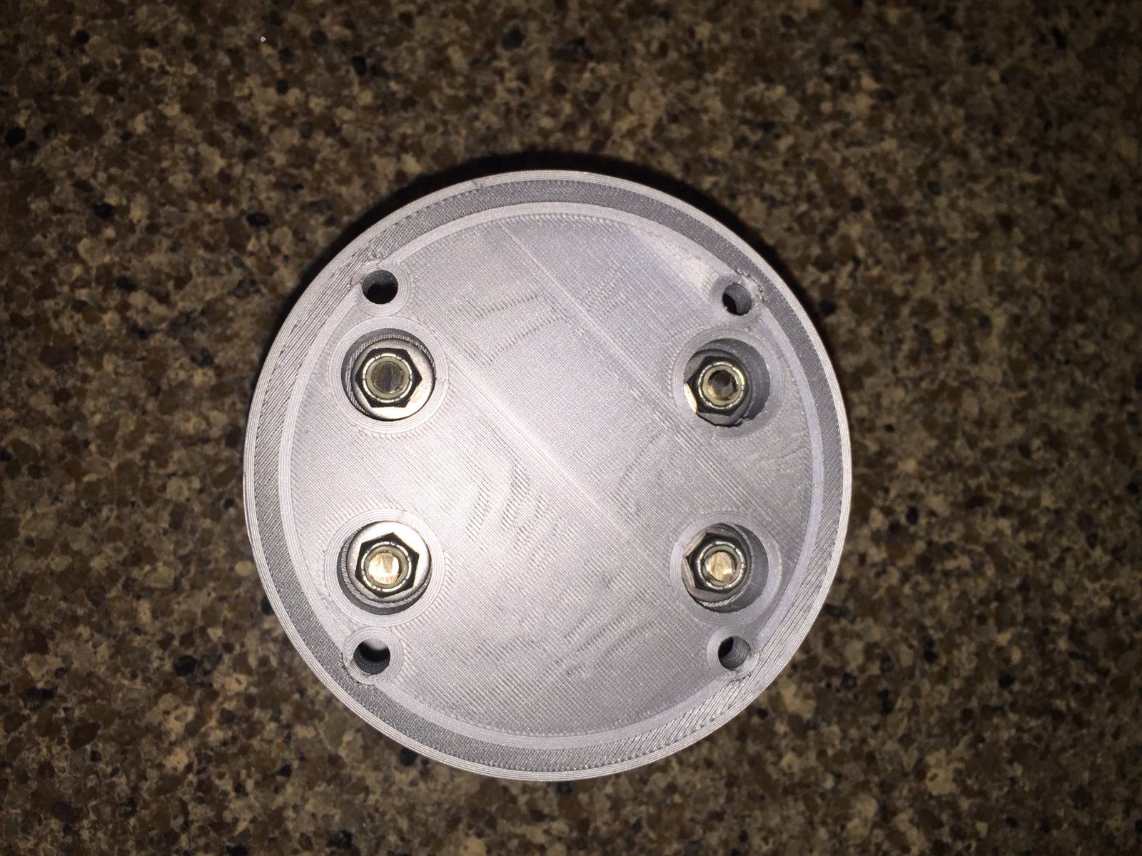

    However, been wondering about an entire 3 printed u joint with high tensile not so shattering type of material, reading up/watching vids and checking into 90% metal filament or even the 20% with something stronger than PLA. It seems polycarbonate and some other hybrid mixes of non metal may even suffice if reinforced otherwise.
    Anyway, again, used up time searching around for 3d u joints until finally searching xsimulator....once again, people have already done both of the above, including 3d printing the whole unit practically. Thank you a TON @Hoddem who posted data files and details on 3d print joint in the posts over at 6 DOF from scratch ...
    @Hoddem said,
    So it'd be intersting if Hoddem could provide a note if the joints were actually implemented and how they worked out beyond the stand test? In any case, I'm just going forward with a 3d printed system with metal joint, but instead of regular PLA, will use something stronger/reinforced.
    +100 vote @Hoddem's post for a place under U joint info the FAQ.

    Keep in mind, my u-joint was designed to used with linear actuators which wont have nearly the twist force that a single joint under a seat will have. That being said, it is pretty strong and could be made even stronger if needed, increase the fill density and move to a stronger material like nylon or carbon fiber filled. If I were doing a seat mover with a single u-joint I would probably pay the money and just buy the parts to build a double flange u-joint. being that you are only buying 1 set it wont set you back too far. I would take a look at www.driveshaftparts.com I started down this road, but at $40 each and needing 6 u-joints it got too expensive.

    Ah, thanks for the clarity, guess I'll go the double flange route, but may end up testing a 3d print later for pure curiosity reasons (trying to make this during December break, and with the new stronger materials and greater infill I'm almost positive it'd work, who knows. Forgot to ask if you used special tools for your u joint fittings (for snap rings or any other purposes), or just needle nose or something?
