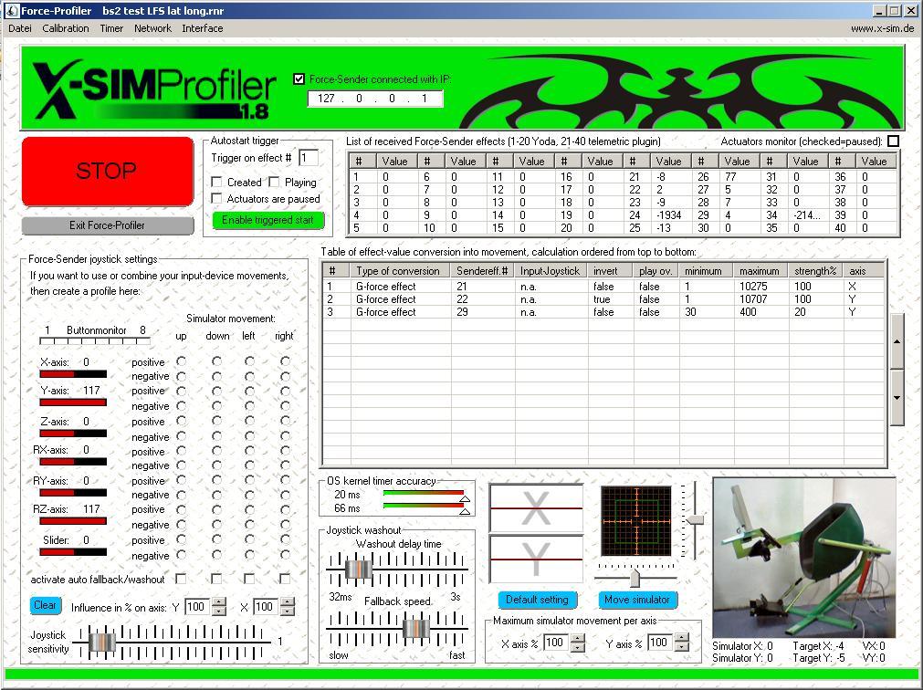

    Hi
    In profiler I should be able to see the pot. pos. But i'm not shure if that is the info I'm getting.
    I only get target x y and NOT sim x y...
    Henrik

    The pots are connected to Thanos AMC interface. You wont be able to see them in the Profiler.

    I see.. Thanks.. Can't seem to find a working download for profiler 2.0.. I've got the 1.6.9 install package now..

    Dont mind this issue at all. You dont need the pots to be displayed.
    Continue with 1.9, as it is easier to understand and troubleshoot for now.
    EDIT: There is no default profile for the use with Thanos interface for X-Sim2.
    Use 1.9 and Thanos Profile!

    Sirnoname: I tried like 10 times to download from that link and all I got was the message the page cannot be displayed. That's why I wrote A working download. But i godt it working now..
    egoexpress:you do mean 1.6.9 right? Just to be sure :)
