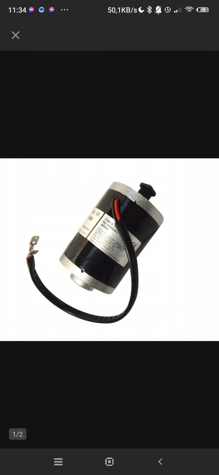

    Hi I have motor like this :
    brush motor: 12V
    power: 120W
    no-load speed: 3350 RPM
    RPM under load: 2500 RPM
    no-load current: 1,2 A
    current under load: 15,4 A
    torque 0.46 N.m.
    motors include a roller.
    S2 operation type
    I can't set it in Smc3Utils to grab belt. Looks like no enough power. Pwm max is 255
    Is is a low torque or my settings?

  11. Krzysztof Dej
    Krzysztof Dej Active Member
    Jun 3, 2020
    315
    Poland
    1,100Coins
    +74 / 0 / -0
    Different motor for now but it's look like this
