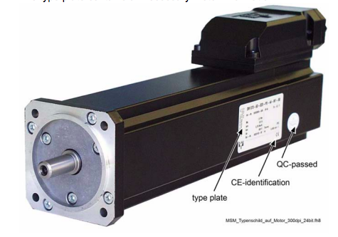

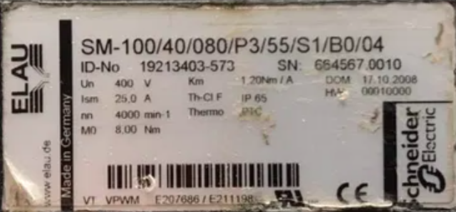

    I searched the local second hand market and I found this motor
    From what I found online in the official documents, it has a sincos single-turn encoder (1024 phases per revolution)

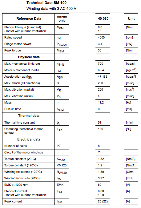

    Here are some details about the motor:
    I have a question as well, does 400V mean that I should connect it to a 400V supply or that it's the max the motor can handle?
    Please tell me if this motor is a good deal for 80 euro.
    Thank you!

    Here are some more specs, seems I cannot post links yet

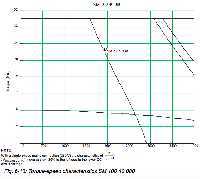

    And a torque-speed graph - it also seems that you can connect it to normal household 230V socket. Also, can you control it with IONI?
  4. Gadget999
    1,954
    11,953Coins
    +484 / 10 / -0
    it looks pretty good
    does it come with a motor driver ?

    It doesn't, do you think it would be hard to control with a 3rd party controller such as Ioni?
  6. Gadget999
    1,954
    11,953Coins
    +484 / 10 / -0
    you may need other parts like a power supply etc if you use ioni - best to find a complete solution
