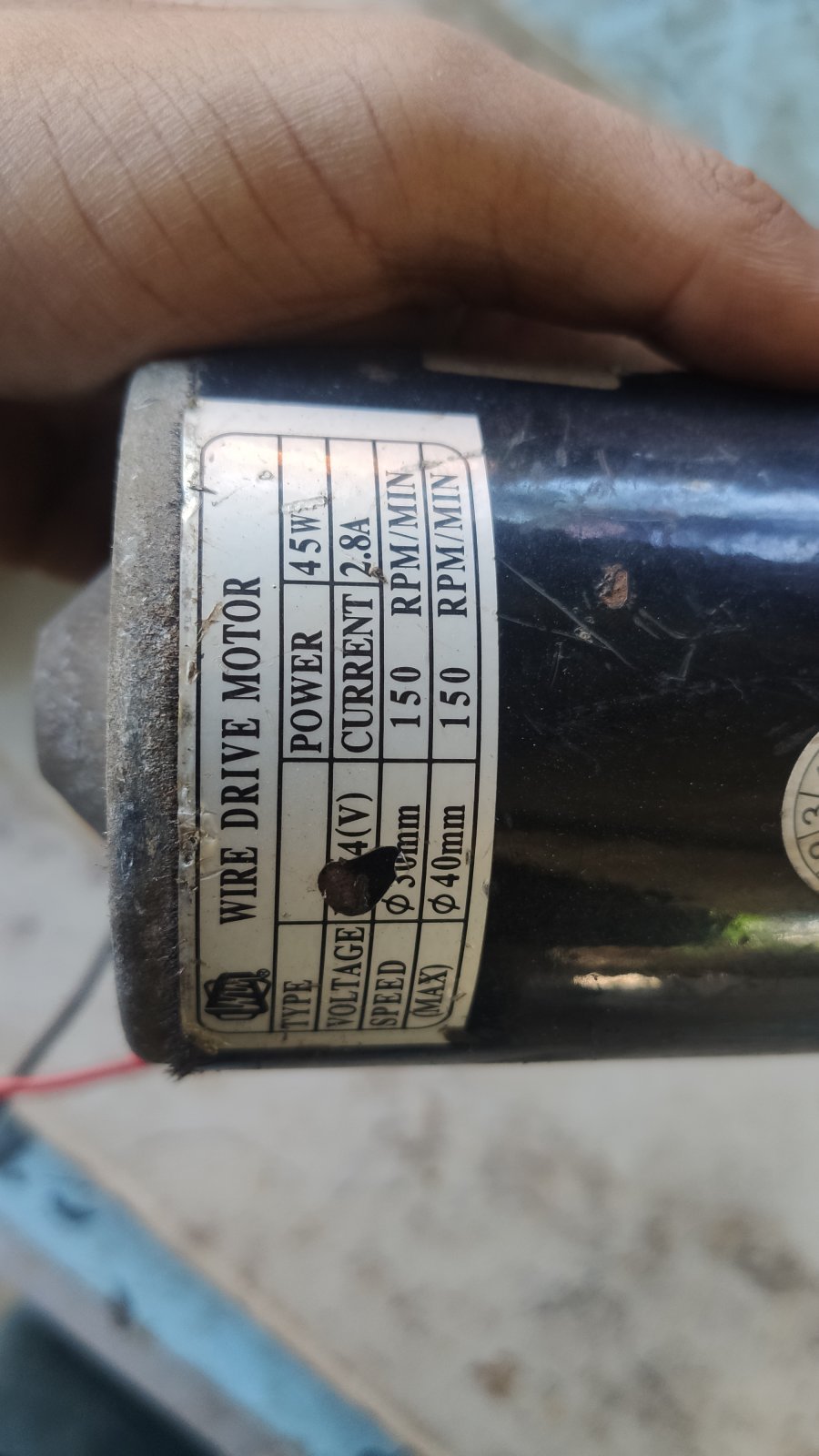

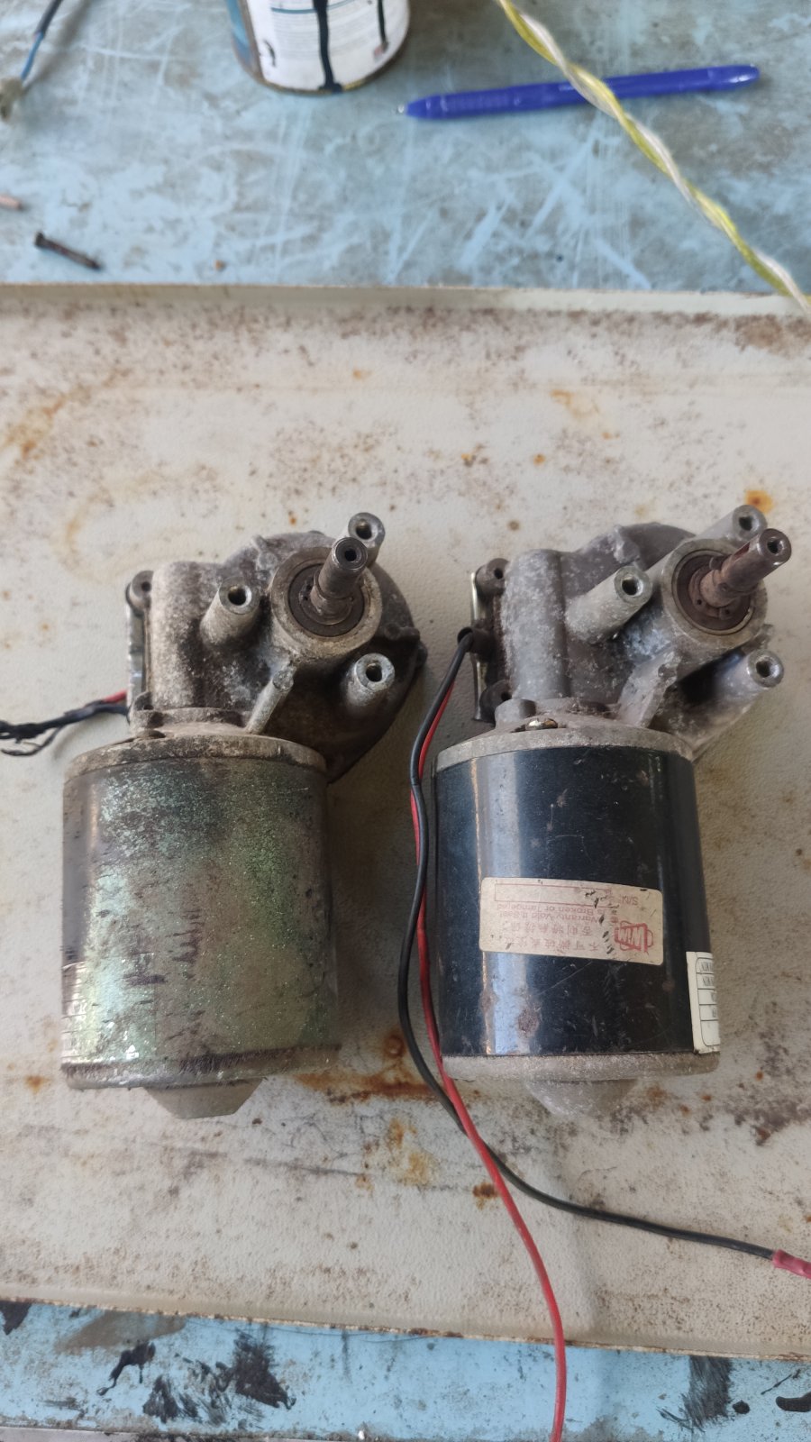

    I found a wire drive motor from a big MIG welding machine with a power of 24v and 150rpm, because I thought it would be better than the wiper motor that I use now which is different in size and rpm. but the problem i have encountered is that this motor can't lock itself. even though it's the same as a wiper motor with worm gear, but the wiper motor can lock itself, is it possible to use this motor sir??

    if you think through the design well and use a shoulder mount, then I think in theory it’s possible, but they are weak, very often people use from 150 watts

    the motor will stay in the desired position as soon as it is energized, when you turn off power the seat will reach its lowest position without a self-locking mechanism. Just be sure this action does not damage anything.
