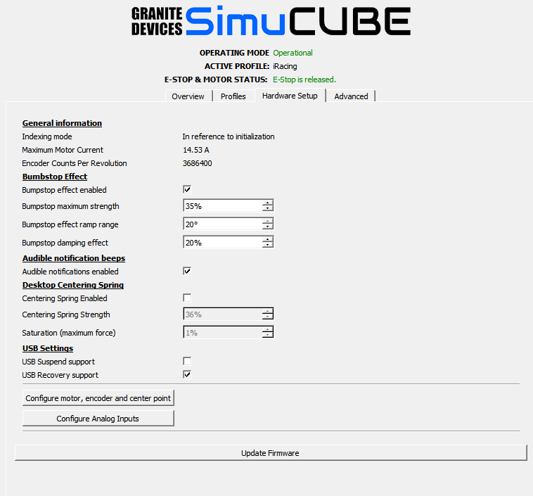

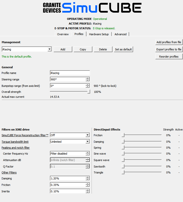

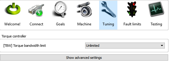

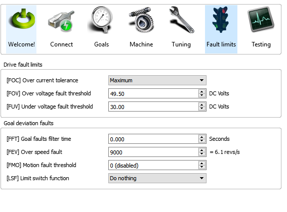

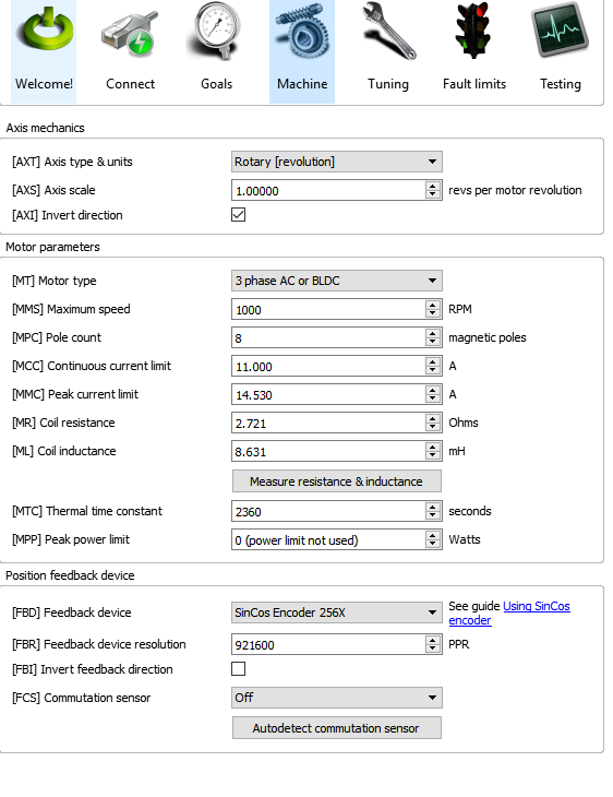

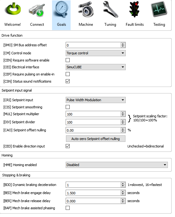

    SIMUCUBE
    GRANITY

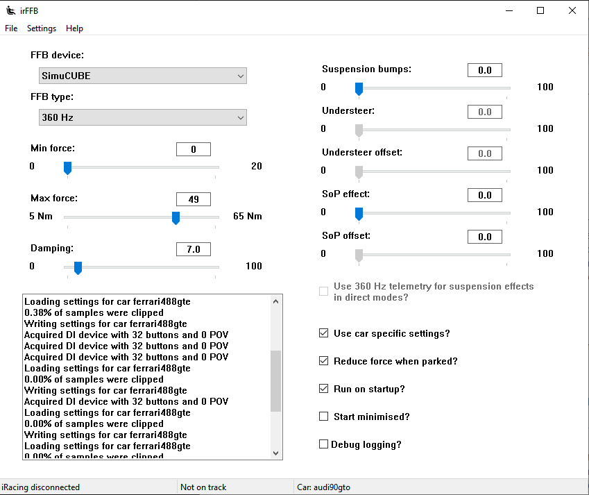

    irFFB
    https://github.com/nlp80/irFFB/releases
    Here is a screenshot of my settings. I dont use the extra effects on the right but you can try if you want additional feedback. Normally 1-5 is enough with Mige motors as they are powerful enough to sense the effects.
    I do run a bit of dampening on cars depending which if I still get some oscillation on straights.
    i.e. Lotus79 I think I run dampening here around 10
    Ferrari GTE i run 7
    Lots of info on this tool on the iRacing forums being discussed. Just pay attention since most of the folks that play with the effects and such are non direct drive users.

    Ok got it setup and tested, well after I had a nightmare with my wheel , I updated IONI to latest firmware and the wheel wouldn't stop spinning no matter what granity or simucube settings I used. I ended up rolling back to the firmware version I had before and it was all good :)
    @Sebj how the hell you cope with it at 45nm maybe im a weak old man but that was way too strong lol I put it upto 65nm and I got loads more detail than what I had, I could feel wheel slip and grip although it still feels really strong and it really wouldn't be in a Ferrari 488 but its deffo a 1000% better than what I had before . I only got about 10 minutes after all the problems so I will try again tomorrow hopefully :D I dont under stand the dampening but it felt better with it switched off completely, I need to test more ;)
    Thanks dude you've been a great help :D

    All same settings as yours apart from irFFb, I set it at 60nm and 0 dampening, I've only driven the 488GT3 not tried anything else it feels good .

    Big mige is a tad more dampened hence small mige is more active but ever so slightly. Sounds like perhaps your bump stop settings could be tweaked or the app.ini settings in the iracing folder.
    Big mige will have different settings in granity...I also run a sincos encoder.
