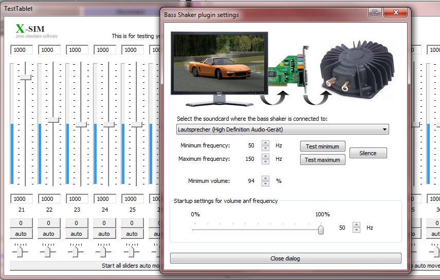

    I have connected a bass shaker to my soundcard but profiler
    does not see it.
    What are the steps to recognize the soundcard as output
    Thanks for your help

    hi you must open the bassshaker plugin in interface settings.
    than set your soundcard in the plugin. than you mast restart the profiler
    and than the profiler find your soundcard.

    hi,you can not use the same soundcard were are make the playsound.you mast have a second soundcard or a second pc.
    sirnoname have wride:
    Connect your bass shaker to your soundcard and control its frequency and volume with the ingame RPM or Speed value. (or whatever you like)
    Attached you find a sample setup for the test plugin to get a feeling for it.
    For setup you have to open the plugin dialog and select a soundcard where the frequency has to be sent to.
    Fill the dialog with your wished minimum and maximum frequency. (sine output!)
    Press the HW rescan button, insure the plugin output is listed in the interface setup of the profiler.

    In my pc there are no room for another sound card so i have buy a really cheap USB sound card key
    After connected everythings working fine but when i try to charge the profile on profiler it doesent
    recognize the sound card on usb so i can't find no output for bass shaker volume or frequency.
    It 's x-sim that doesent work with USB sound card or some other thing that i dont understand.
    Sorry again for my silly question but i have 6 bass shaker and i wish to drive 1 at least with x-sim
    Thank in advance for your help

    Is your sound card properly registering with Windows, and is is Direct Sound? If you go to Control Panel-->Sound and see if your new sound card is listed.

    Yes is listed as speaker USB AUDIO and if i connect another one is listed as USB AUDIO 2
    I use win7
    By the way if i connect some real speaker or bass shaker on it and configure it as predefined i can hear
    music or vibration so it works for windows but i dont know how to make it visible for profiler

    Try to start x-sim with admin priviliges

    If i try to use the servo commander for example and send the signal to the soundcard this setup see all the soundcard and i can fell the vibration on the bass shaker in the profiler i can't see no output

    Do you see no input at all, even your regular soundcard is not listed, or only the USB soundstick?
    You should see at least your regular soundcard. Maybe the plugin is broken. Which x-sim version you use?

    i use the last version of x-sim
    After your precious suggestion i have cleared and reinstalled x-sim
    Things don't work but i have noticed that if i leave only the bass shaker plugin when i start the profiler
    it dos'nt recognise no output.
    If i try to open setting with the button (in the interface setting page) when the bass shaker plugin is marked notthing happens , the same if i try an hw rescan but if i uncheck the bass shaker plugin and i try to open setting with the button befor the automatic rescan i can see the pop up page of sound card setting and just for a while i can see all the sound card.
    But after a second the profiler crash and i can't choose the right one
    Is certanly something related about my low knowledge but i try that in another pc ( the first one is a quad core with win7 64 bit the second one is a quad core with xp pro 64 bit) and is the same.

    I can only assume that there are some incompatibilities with your USB Soundstick.
    Either the plugin does not support external usb sound sticks at all, or only your specific stick make problems.
    I ´ll check that today in the evening as i own a usb soundstick also.
    Does anyone already tried it with USB sound?
