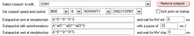

    I finished building a project i had long time in mind.
    It is called Airspeed SIMulator, (A-sim) and it is a serial-interface peripheral which reads airspeed and sideslip values from the game through X-SIM and simulates what the air would feel like in an open cockpit. To create the airflow, it uses 2x 12Vdc computer fans. In my case it outputs around 4.25 m2/minute (~150 QFM), which is quite a lot. I have used it for IL2 open-cockpit airplanes, but it can be used for racing simulators too.
    It is based on the PIC16F887, powered by 12Vdc, drives up to 4 PC fans(!) and its total cost is below 20 EUROS.
    With 4 PC fans one could get around 10 m3/min, you would need goggles to face the screen! :lol:
    Here are some limited pictures because i am having problems with my digital camera...
    [img600px]http://i202.photobucket.com/albums/aa220/klapatsimbanos/A-SIM/Toolkits078.jpg[/img600px]
    (Click on the thumbnails to see full size photos)
    [​IMG] [​IMG] [​IMG] [​IMG]
    (i used my PC's power supply to power A-sim, through the 12V line (yellow-black) )
    Here are the settings which were used in X-SIM:
    ~a01~: I.A.Sp. IAS_settings.jpg, IAS_math.jpg
    ~a02~: L_Slip L_Slip_settings.jpg, L_slip_math.jpg
    ~a03~: R_Slip R_Slip_settings.jpg, R_slip_math.jpg
    The code and the schematic and the part-list can be found here:
    A-SIM.zip
    I will upload some videos soon.
    Hope you find it helpful.. :crazypilot:
