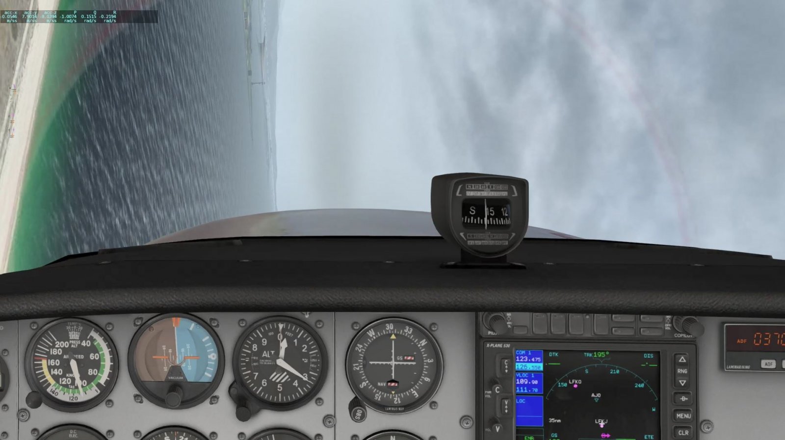

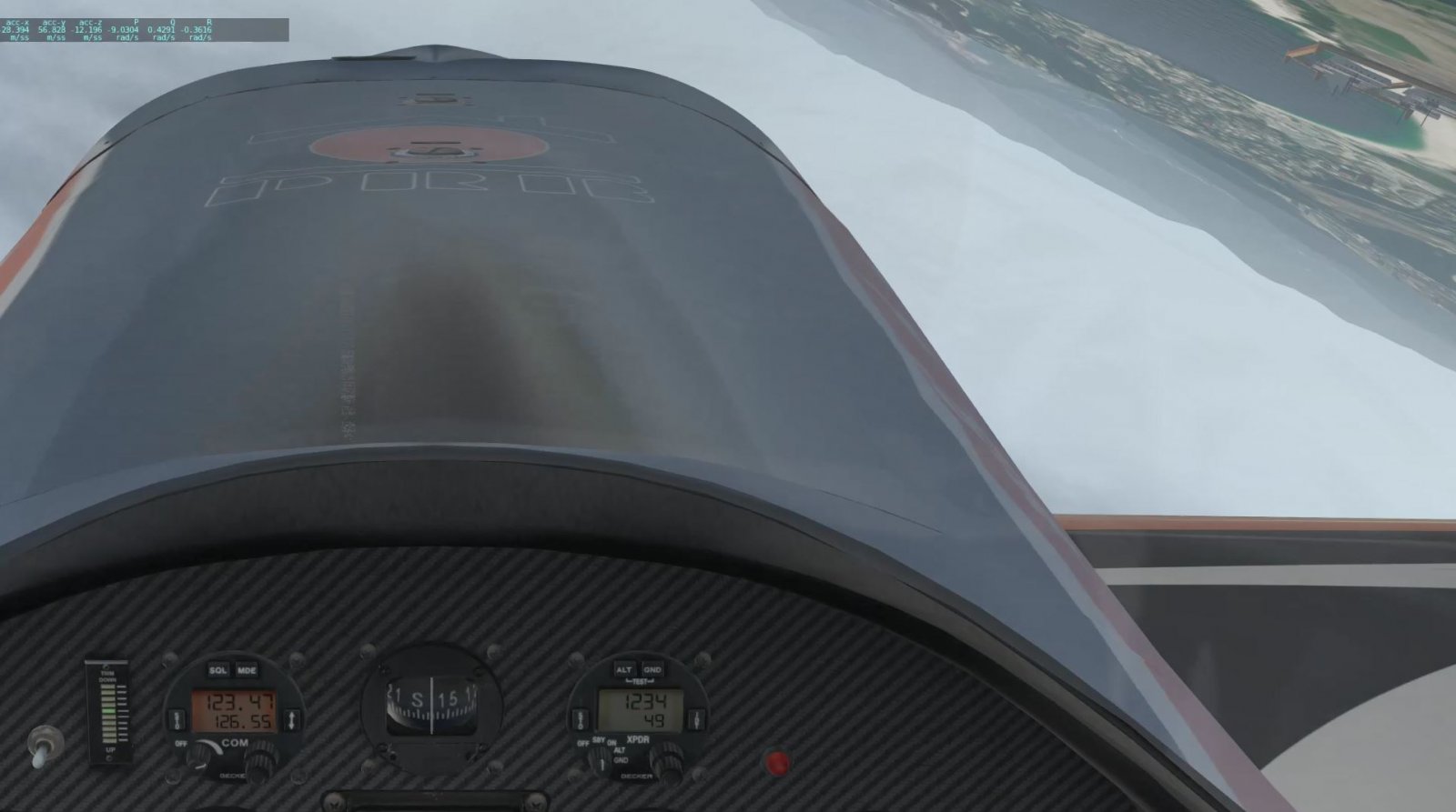

  13. hexpod
    hexpod http://heXpod.xyz
    Apr 18, 2016
    1,094
    berlin
    7,099Coins
    +337 / 5 / -0
    DC motor, 6DOF
    In the left corner you can see so called "motion platform stats".
    Please pay attention to the P parameter (angular roll velocieties).
    In this test, I am doing a roll (yoke full left) with cessna 172 and extra 300. As you can notice, the difference between two aircrafts is a factor 9.
    Also be aware please, that the extra 300 is not the fastest aircraft in x-plane. we can find some fighter jets there with even quicker response.
    @yobuddy, I hope it can convice you that my request to have an extended slider range or a save/read preset for "Profile Editor" with different Tunning Center values is more than resonable.
    Thanks a lot.
    Best
