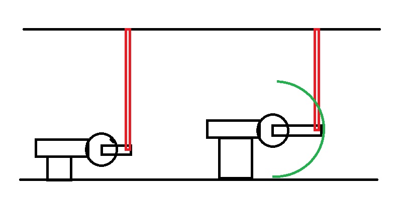

    Hi Gents,
    Apologies for my first post in some time, actually being a question :)
    I've been crazy busy at work and unable to do much on the sim. I'm hoping to change that this weekend.
    I'm happy with the motion of my sim, but I want to get a bit more pitch from it, so I am going to change the 45mm arms to 55/60mm arms and raise the motors a touch to accommodate the new lever arm lengths. (so at full down they clear the sim base)
    My question is, do I then need to raise the pivot level or just cut the motor arms to suit? I just can't figure it out in my head, as each time I think of raising the motors by 10cm (as an example) and then cutting off 10cm from the motor arms (to level out the sim) the net result is 0 gain. :think (in my mind!)
    Likely a stupid question, but rather than start at things with an angle grinder I figured I'd ask our resident genius members :D
    21,526
    150,776Coins
    +11,021 / 55 / -2
    Shortening the rods but with longer levers will increase the arc. Here is a very rough visualisation.

    Thanks @noorbeast - You know for the life of me I could not get that right in my head!
    Once you see it you go "DOH!" *facepalm*

    Just remember, I recall you are using 25:1 boxes and you will reduce the torque you currently have for larger wanted movement. It should work, but the motors may struggle a bit to pull up from a big side shift lean. If that happens, buy some 50:1 boxes and fit them to the motors.

    Thanks @bsft - I've tuned the JRK to within an inch of their lives, it's more the throw I am looking for.
    I will likely re-tune them to keep the sway/roll throw similar to what I have now (axis limit it), but will up the pitch a bit. I am using the full 180 degrees at the moment and really don't have all that much pitch to show for it. It's the one sensation I love in the sim. I am happy with the amount of Roll/Sway I currently get.
    I notice in DIRT Rally, the pitch is not great (for me) and that is what I want to update it for. Freakin love that game!! :)
    @GIB SimRacing - Yeah! Fully agree mate :thumbs. I was looking at the sim, doing some measurements and I just could not figure it out. I think I was forgetting that the arm will be longer and of course the arc/throw would also be longer. (Penny drop thanks to the awesome diagram from @noorbeast ) I just could not get past having to lower the arms once the motors were raised, and confused me old 'noggin. :grin
