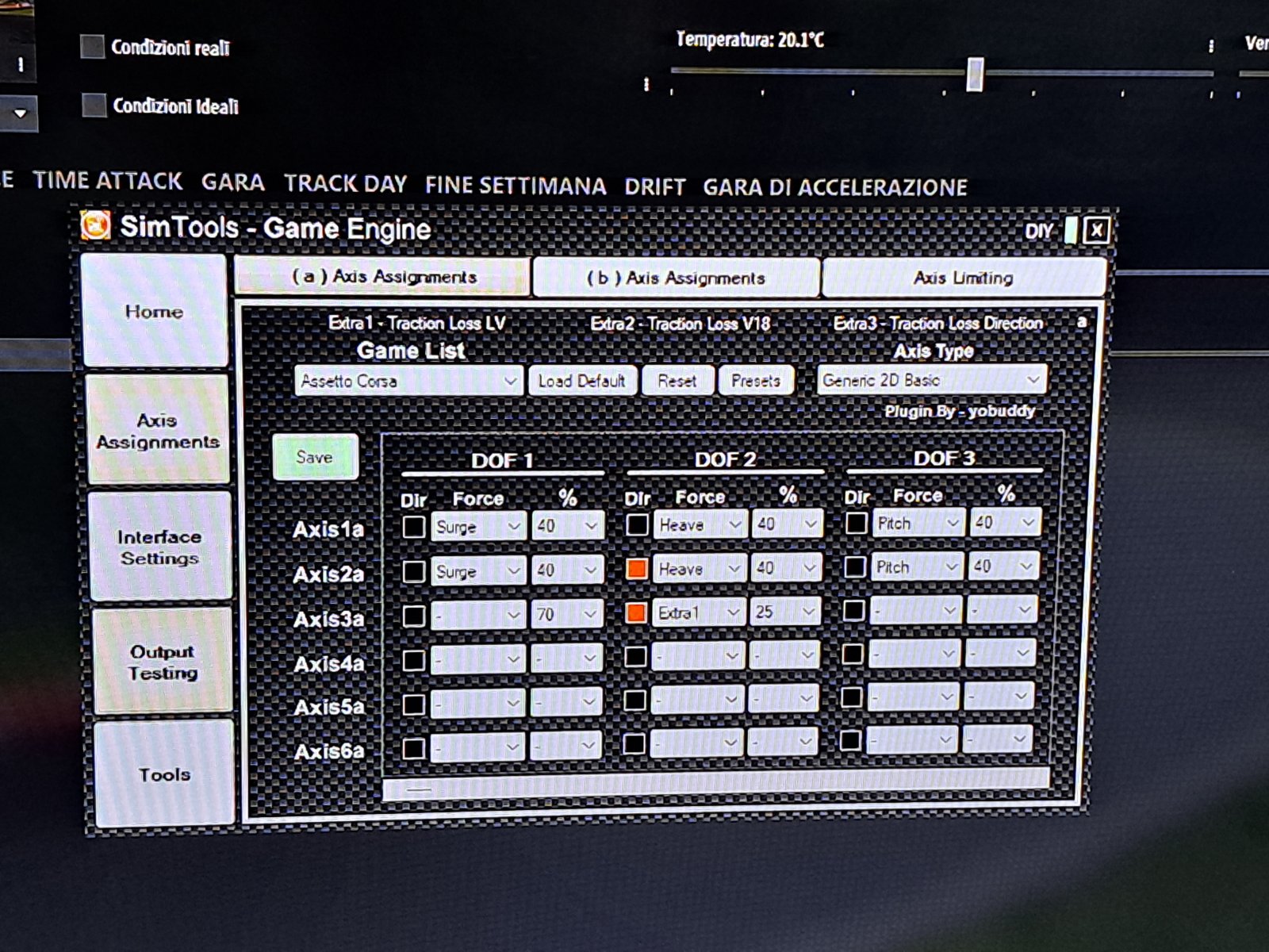

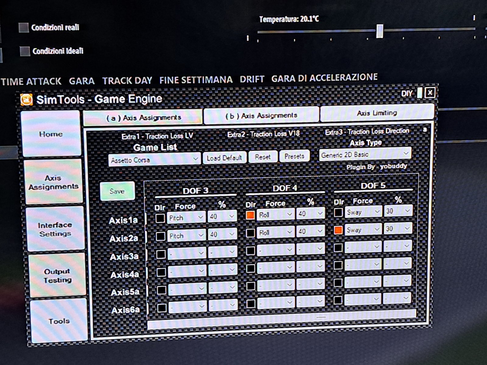

    Hi people, I have a prosimu 3 dof station, I realized that I have a wrong configuration of the actuators, when I turn left in the car I should feel pressure on the right side, instead I feel pressure on the left side which would not be real, do you know how I can solve this problem? it happens to me on assetto corsa and also in all other racing and flying games. excuse my English.

    The Dir box in Axis Assignment being checked orange or not determines which way each axis moves. Sway should lean away from a corner and roll should be set the opposite to sway.

    Could you tell me the boxes that I have to select in orange to have a real oscillation in the curve?
